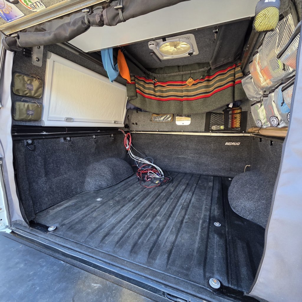

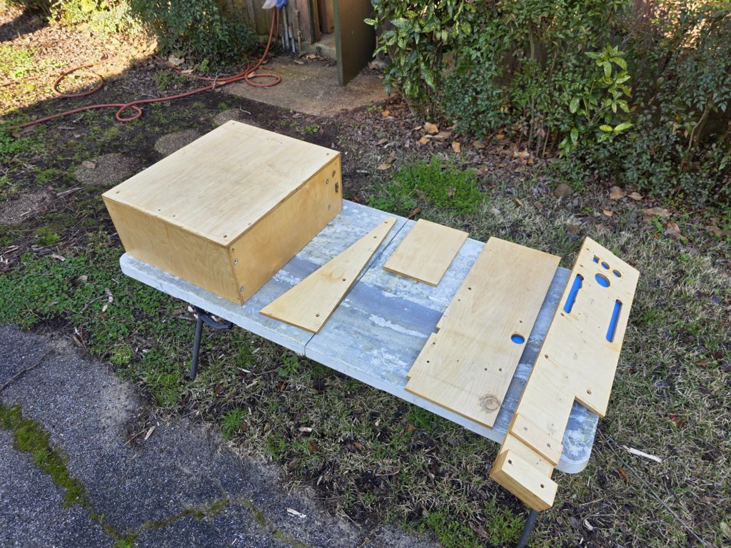

    Build progress has been a little slow but here is a battery box and electrical panel I have been working on for a house battery in the Atlas.
    Once the weather warms up the wood will be getting a coat of bed liner to match the rest of the cabinetry and I can get this all installed and wired up.

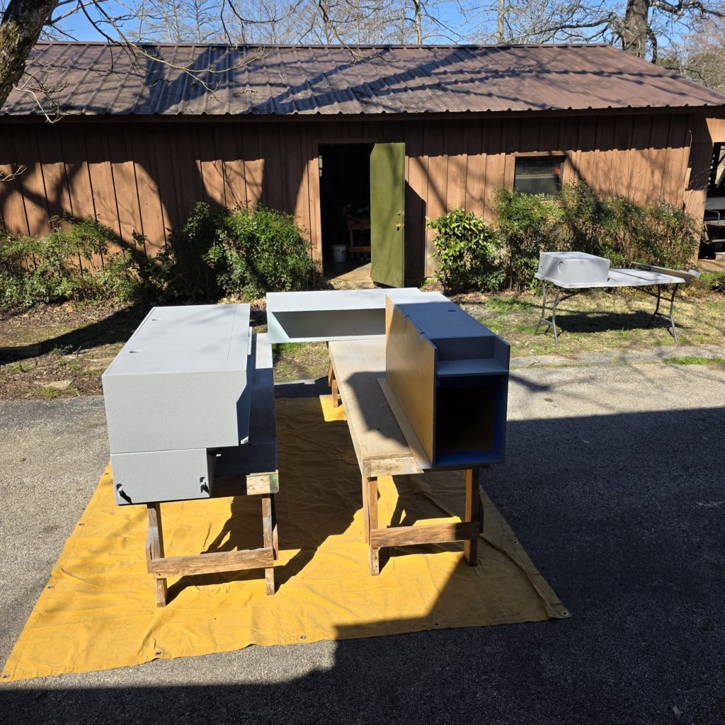

    A little progress made today! Removed all the cabinetry for a fresh coat of bedliner and coated the new additions. While the bed liner cures for the week I need to tidy up some loose ends and then I can get it all back in.

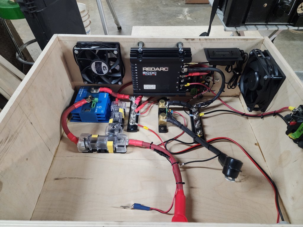

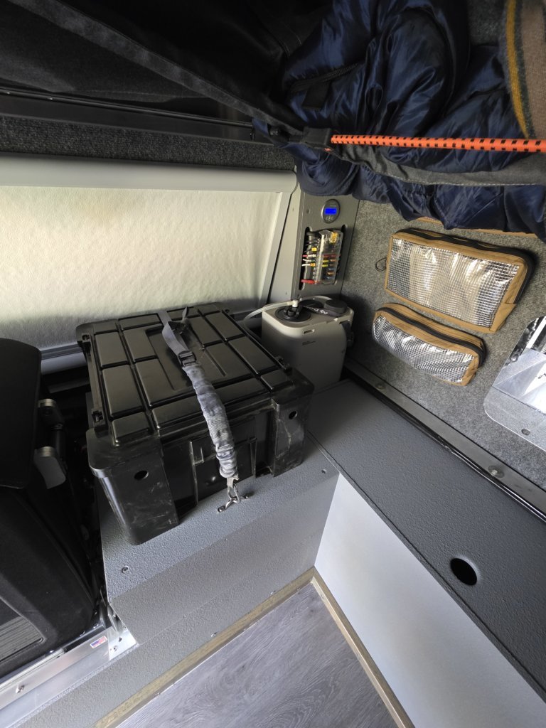

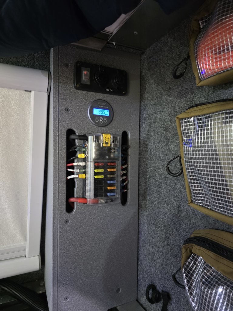

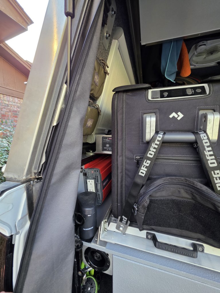

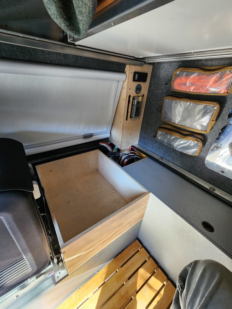

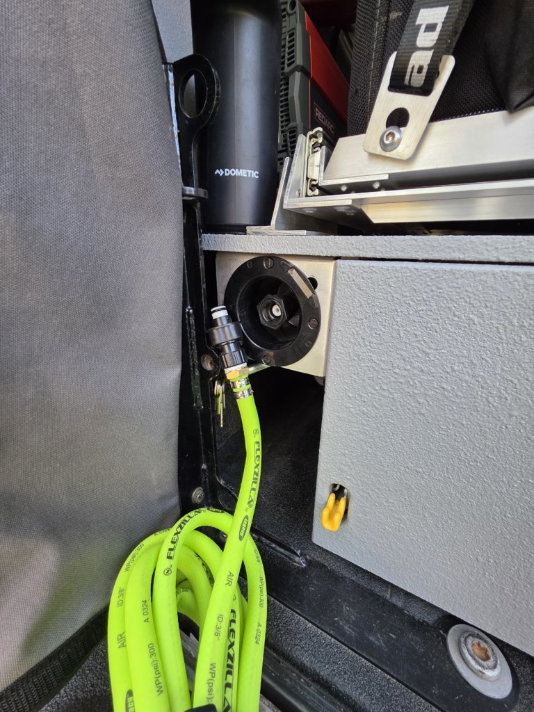

    Got everything reinstalled in the truck and am pretty happy with how it all turned out. The new box behind the fridge holds a 200ah LiFePo4 battery, RedArc BCDC Alpha 50 and circuitry. Due to the size of the box I also installed 2 4in fans, a pusher and a puller, on a thermostat to regulate the temps in the battery box.
    I also made a cubby up front to hold my Dometic water jug and I have the hose routed to the back beside the fridge where I have the rechargeable Dometic water faucet.
    The battery box lid is also removable with 4 10-24 screws for easy access.
    I also fabbed up a QD water outlet at the rear of the truck.
    As well as mounted a 1000w inverter and remote beside the fridge.
    It's safe to say that without going up, I have pretty much maxed out what little bit of room I had to work with and have utilized all the nooks and cranny's I could.
    Close up of the electrical chase

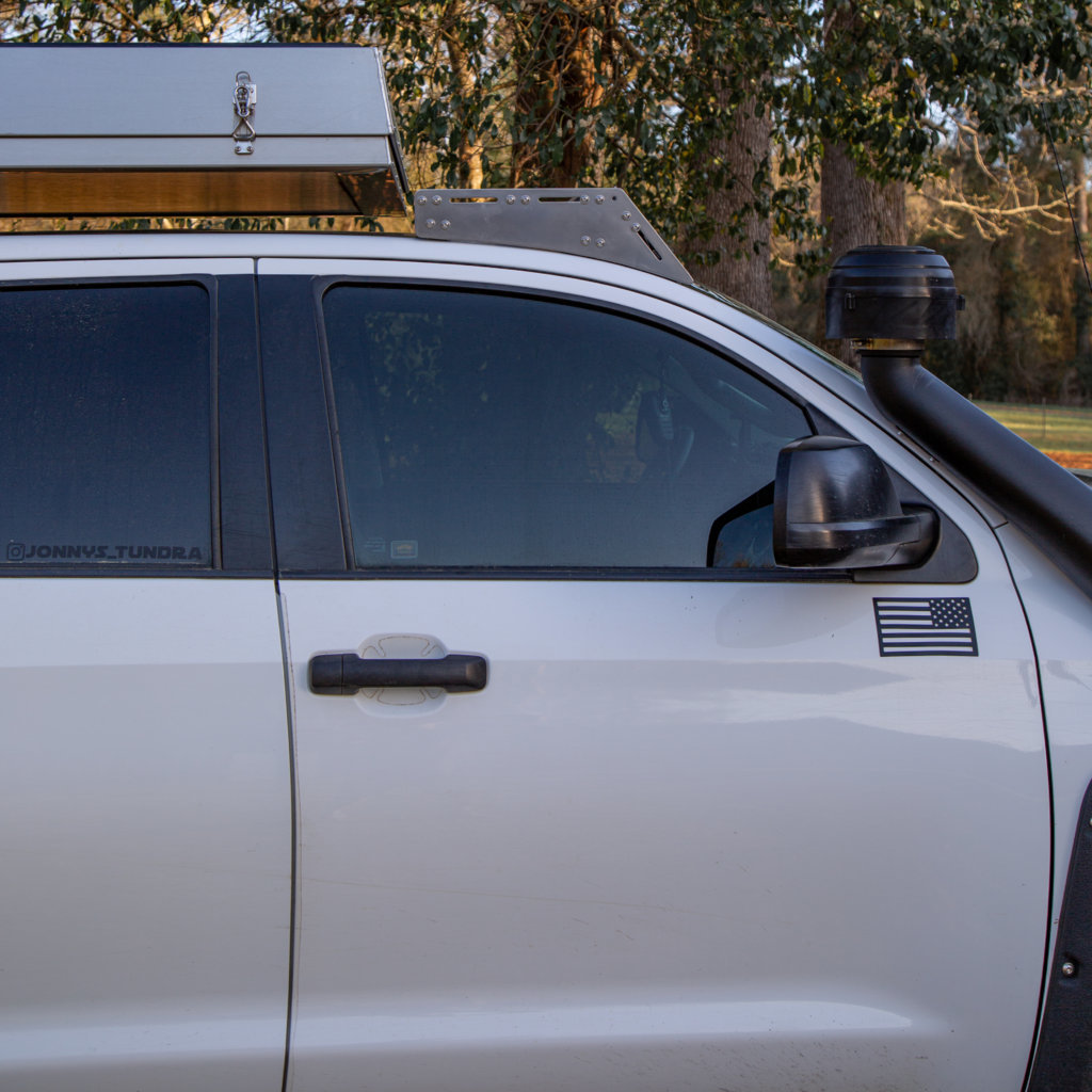

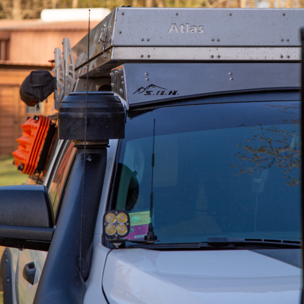

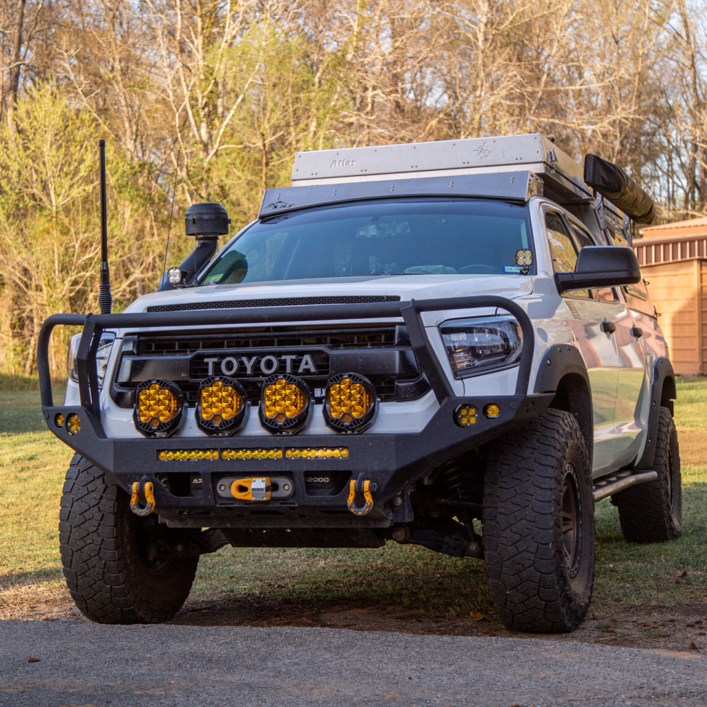

    Well I finally got up the nerve to drill some extra holes in my roof and got the SOB Fabrication roof rack installed. Really like how it smooths out the transition to the AT Atlas.
