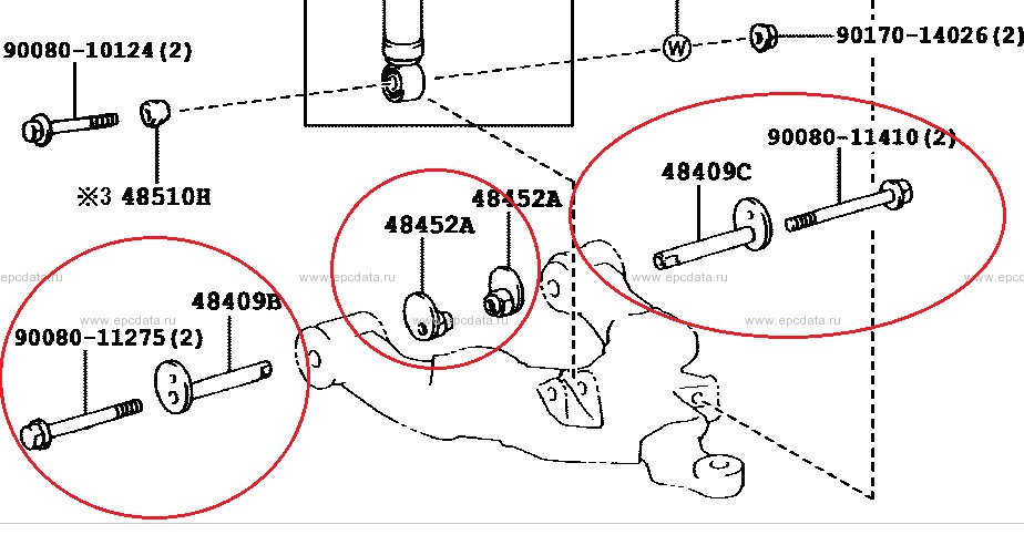

    I ended up ordering everything OEM. Peace of mind for another 200k! However, I'm having difficulty finding p/n for cam bolts and sleeves. Any help would be appreciated :)

    The small section above the red text at the top of this post will help you track down the parts/numbers you're looking for.
    Specifically, after you plug your VIN into the box and search, you're gonna wanna hit "Transmission and chassis" section. Then "Front spring & shock absorber" section down the page. Once there, click "open full size scheme" under the picture, then you can click on the picture of each part you want and it'll spit up the part number above the top of the pic. You'll need to order two of everything obvs.
    For my '06, I see the bolts show up with their full part number, but the sleeves etc. you've got to click to open the part number. Don't use my parts here, my '06 is different from your '02.

    You're the man @Shifty! Surprisingly all our LCA hardware does match according to that data link.

    Interesting! I assumed with the LBJs having different p/n, the LCA and cam bolts would also.
