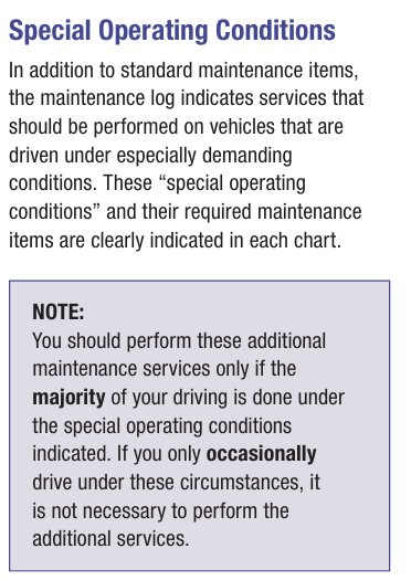

    This is not entirely correct. 5K changes are recommended if the majority of your driving is done under the special operating conditions.

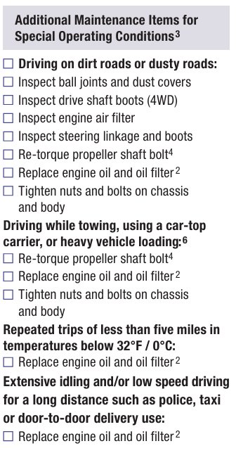

    What a tease!:eek2:
    At least post WTF you are referring too.
    If you only occasionally drive under these circumstances, it is not necessary to perform the additional services.
    Here are the Special Operating Conditions for 5K oil changes..
    If you aren't doing any of these, Toyota suggests 10K oil changes..
    Are you happy now @seydou? :confused: :rolleyes:
    @SilentC please feel free to change the oil as frequently as you desire.
    I was only stating the Toyota suggested oil change maintenance.:thumbsup:

    Didn’t really think he needed to clarify as it has been repeated ad nauseam in oil threads that Toyota’s “special operating conditions” are just using a truck like a truck, which one would think every truck owner does, but maybe not these days.
    Seems far more people fit the special operating conditions than not.
