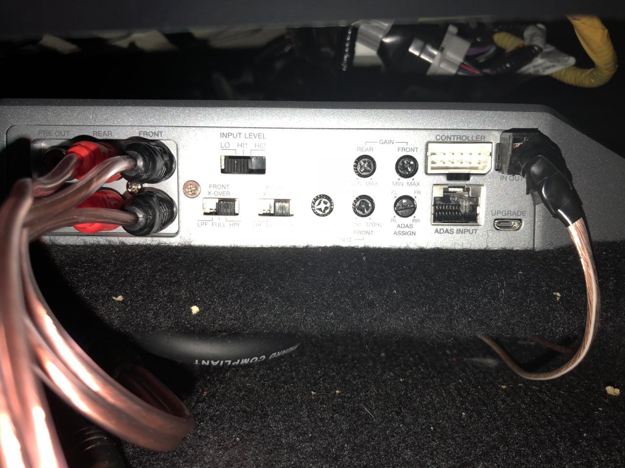

    What settings do you have your amp at?
    Calling @GNTundra......

    Edit - nvm with that pic. the flash screws everything up lol.

    They're all EFX and they seem to crack together but im trying to pinpoint. I did just read some and right now I have the amp set at HPF and im also tuning from my HU. Sounds like if im going to tune from the HU, I should turn the amp to a "FULL" signal. Thoughts?

    Did you hook up your head unit yourself? All the connections are there at the factory amplifier location, you would have to jumper them to bypass your amp.
    What exactly do the speakers sound like and what are the settings on your amp? are they cracking, are they distorting? How high is the volume when it sounds like crap?
    Try this: I would flatten your eq on the head unit, set your hpf to 70hz on the amp and the gain at half way, see what it sounds like.

    I’m getting shitty crackling sound from the tweeters now too. Nothing changes when moving RCAs at the Amp. No clue what to do now.
    I think I’m going to start by ordering the JL C5-650s from Crutchfield. If they still sound like crap, I’ll send them back and I’ll at least have narrowed down my issue to wiring or the Amp.

    Are you sitting still when you hear the crackling? Is the crackling sound coming from both sides?

    Yup and yup. But only certain songs/frequencies

    Speakers are cutting out after I go over a certain volume. Amp is going into protect mode. Ground is good so the only thing I can think of is that I robbed it of the power it needs by splitting the power to both amps.

    Was fine until I split the 4 gauge power source at the distribution block to two different amps w/ 8 gauge wire
