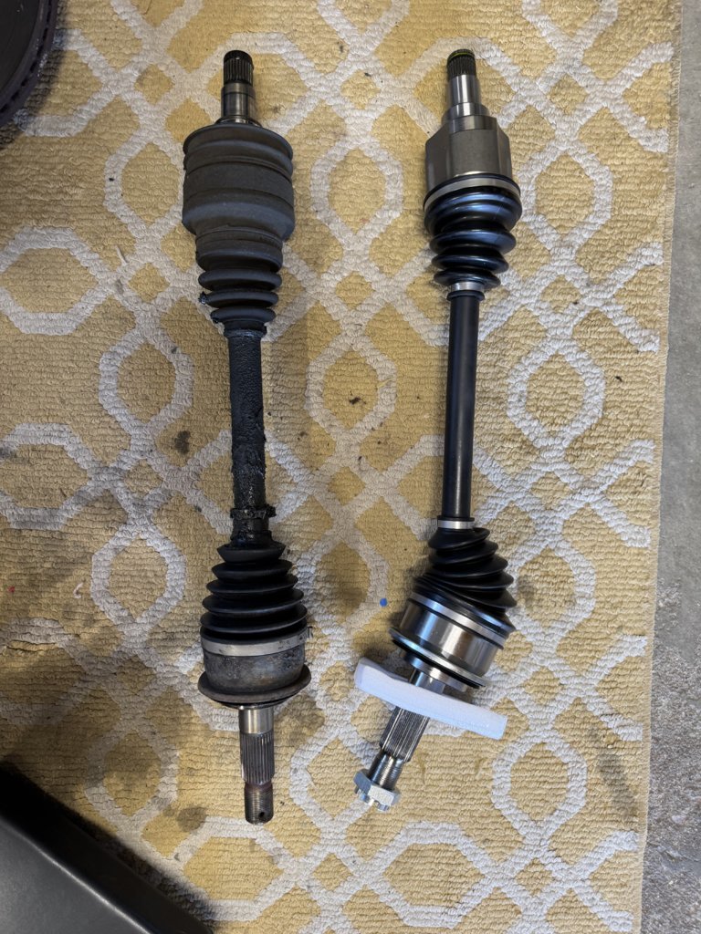

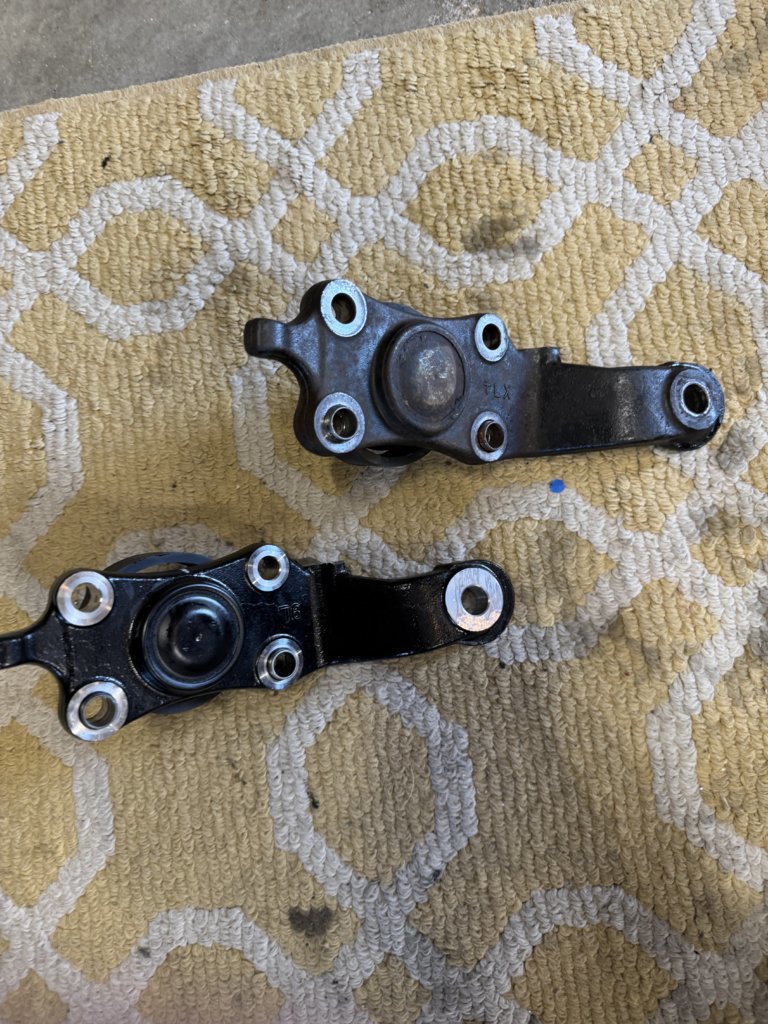

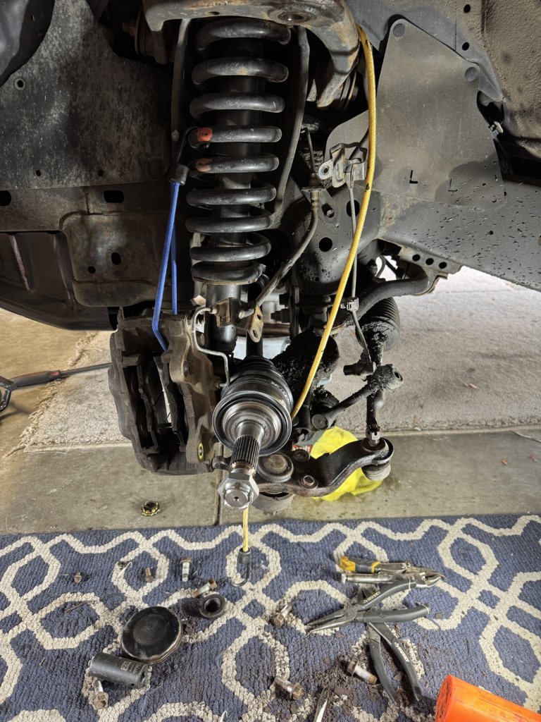

    Finished half the job.
    I’ll have to do the rest tomorrow.
    Drivers side CV axle
    LBJ
    Sway bar links
    Rotors
    Pads
    I had to go to the store 3 times.
    - 35mm socket
    - pickle fork
    - cotter pins
    I’m pretty sure I can do the passenger side in roughly half the time.
    Hardest part was getting cotter pins out (had to drill them) and getting the LBJ’s to knock out.
    The CV axle is more intimidating than it actually is to do.

    Nice work! What brand CVs did you go with?
    I replaced the CVs in my old truck for the new owner before handing it over.
    driver side in about 1:40 min.
    Passenger side in just under 30 min.
    First time is always slower since you need to get your tools and technique dialed.

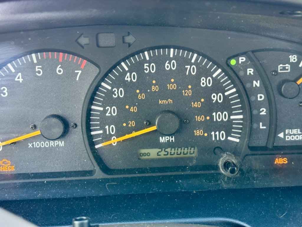

    Still can’t figure out my stereo. But. Hit 250k
