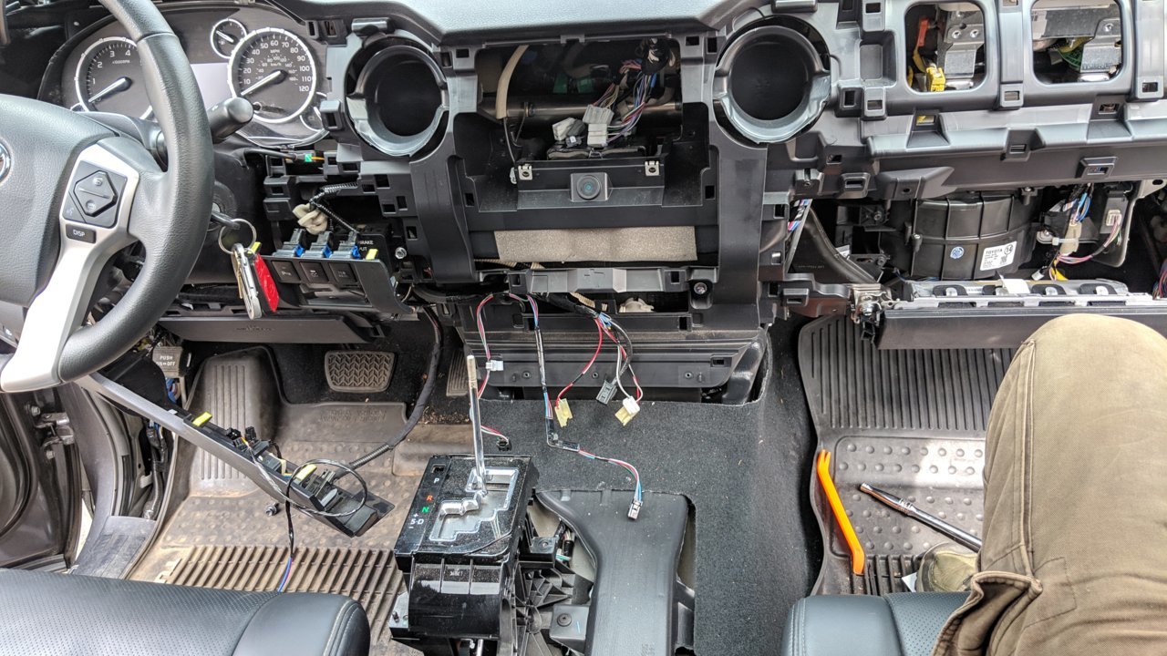

    Stereo upgrades: -HU, Pioneer Mvh bs501 -Tweeters, Peerless(vifa) XT25SC90-04 1" Dual Ring Radiator s in custom pods. -Mids, Silver Flute W17RC38-04 6.5" Wool Cone Woofer. -Subwoofer, American Bass XR12. 2.3^3ft tuned @33-34 hz. -Tw Amp, Old School 2ch Sony. -Mids Amp, Old School Autotek Sx275. -Sub Amp, Old School Memphis 16-pr1.1000 -Zero gauge big 3. 0 and 4 gauge copper runs to amps.
    I started with whatever the basic stock system was. Removed it and started from scratch.
    I made custom speaker adapters out of acrylic, glassed custom tweeter pods, amp racks of 3 amps, sub enclosure, and ran a bunch of new wire.
    Totally worth it.
