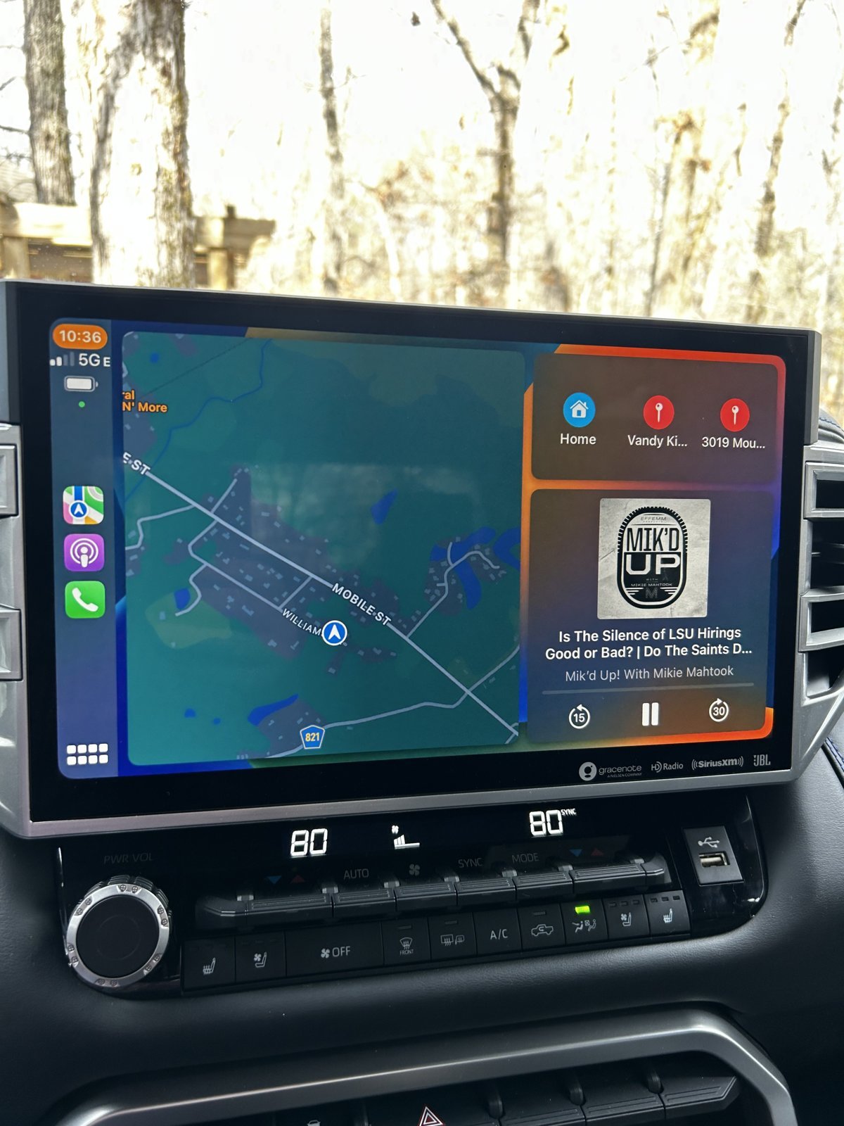

    I traded my 21 Tacoma and I was initially pretty excited about the larger 14" screen. The larger screen is definitely a plus but I miss the split screen view from the 21 Taco. It was nice to have the map, music information, and weather all on a split screen. Now you have to fumble to switch between screens to get music info and see the map.

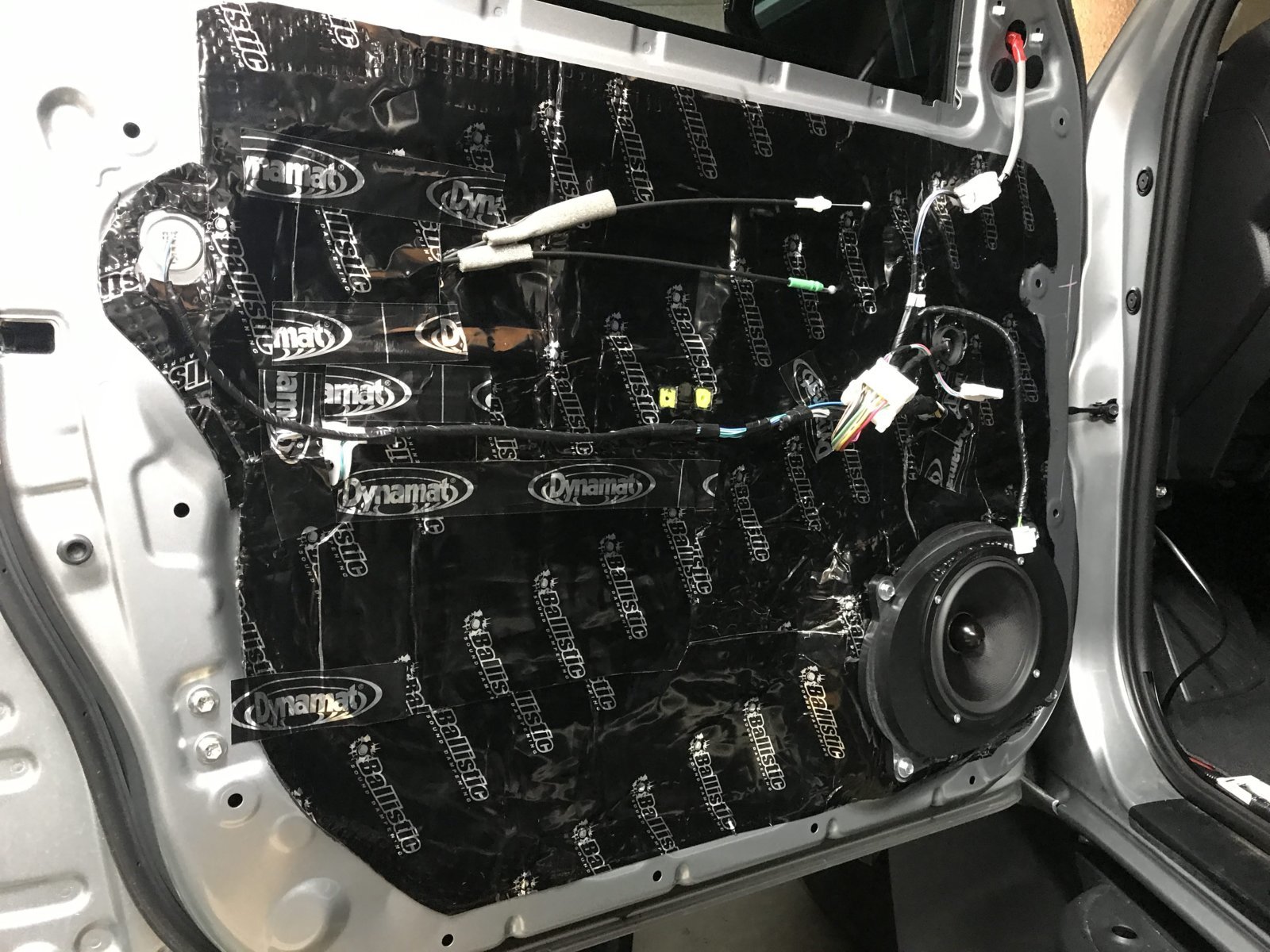

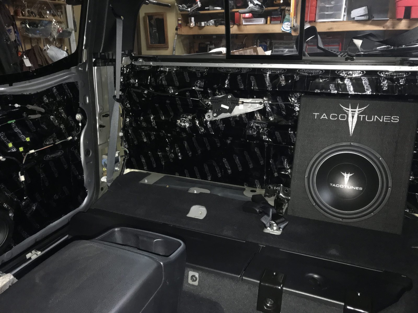

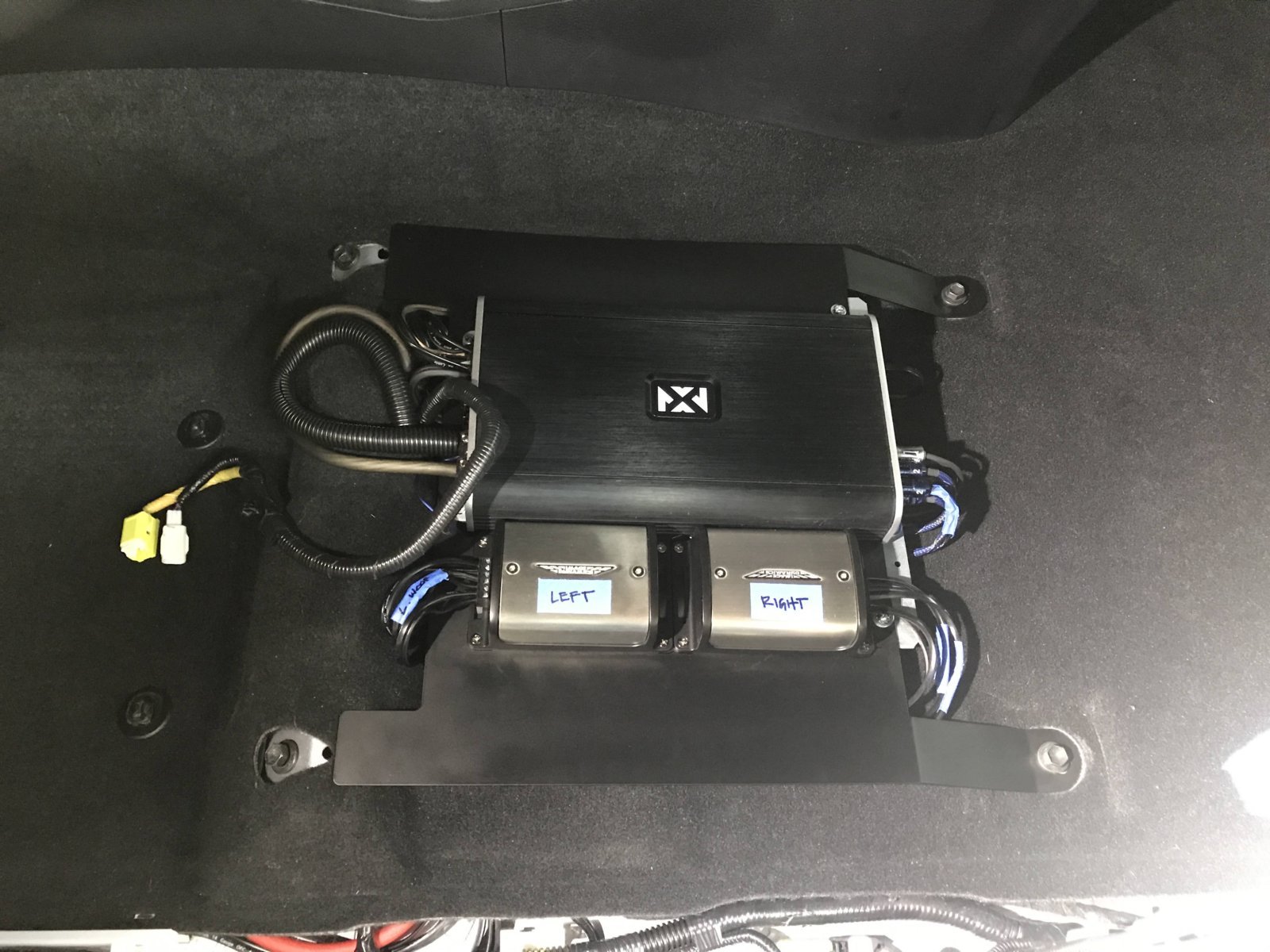

    I just ordered the Beat Sonic and I think that will be good enough for me. Appreciate the discussion with this thread. I don’t want to do a full build. I did that to my Tacoma and it sounds GREAT, but too much work!!!

    I’m 54 now. I’ve probably already lost plenty of hearing at live concerts over the years. Some of the AC/DC concerts were pretty brutal.
    The Tacoma needed a head unit, and so the Pioneer head unit I got cleaned up the signal, among other things. I don’t need a new head unit with the Tundra. I don’t have JBL with the sub and I’m not looking for the power that amps like the kicker have, that is overkill for me.
    I just need a clean signal from the factory head unit.
    I don’t need a lot of power, especially if the signal is clean. The beat-sonic is enough power but will not be too much. My Tacoma is the concert venue.
    My Tacoma experience is that watts are addicting kind of. Once I had speakers that could handle it and a good clean amp, then I found myself wanting to turn up the volume, and then it sounds so amazing, just a little more, and maybe a bit more. I just don’t need that power experience. The clean signal with a little amp added in will be fine for me.
    I don’t want to add a lot of weight with the Tundra. I am towing and will be maxing out payload.
    Once you’ve had a car with all of the walls matted, it’s hard to justify a larger amp and new speakers without also doing the matting. A good matting job does a lot if it’s what you want.
