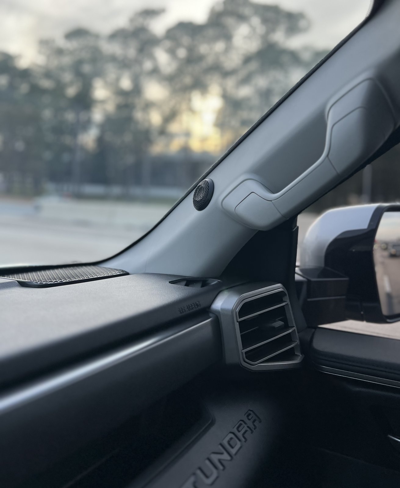

    It’s pretty easy to take the A-pillars off and there is definitely room to add tweeters in there. A shop placed mine relatively close to the glass and about midway up. I have Focal tweeters up there and they sit flush on the slight bevel by the windshield. I’ll get pics later but honestly I’m not a fan of the position and I am just going to swap the pillars for the JBL equipped ones and have them more discretely mounted.

    Thanks for info, good to know not too much effort. I bet your Focal tweets sound great. I too would prefer the stock OEM look so would go with the jbl one for the pillar itself. Adding tweets there would be a nice add to the existing setup. thx again

    yeah, they sound REALLY good. Very happy with the speakers, just not location. Have the new A pillars coming in soon so looking forward to that. Here is how they are mounted now. Not terrible, just not discrete like I prefer

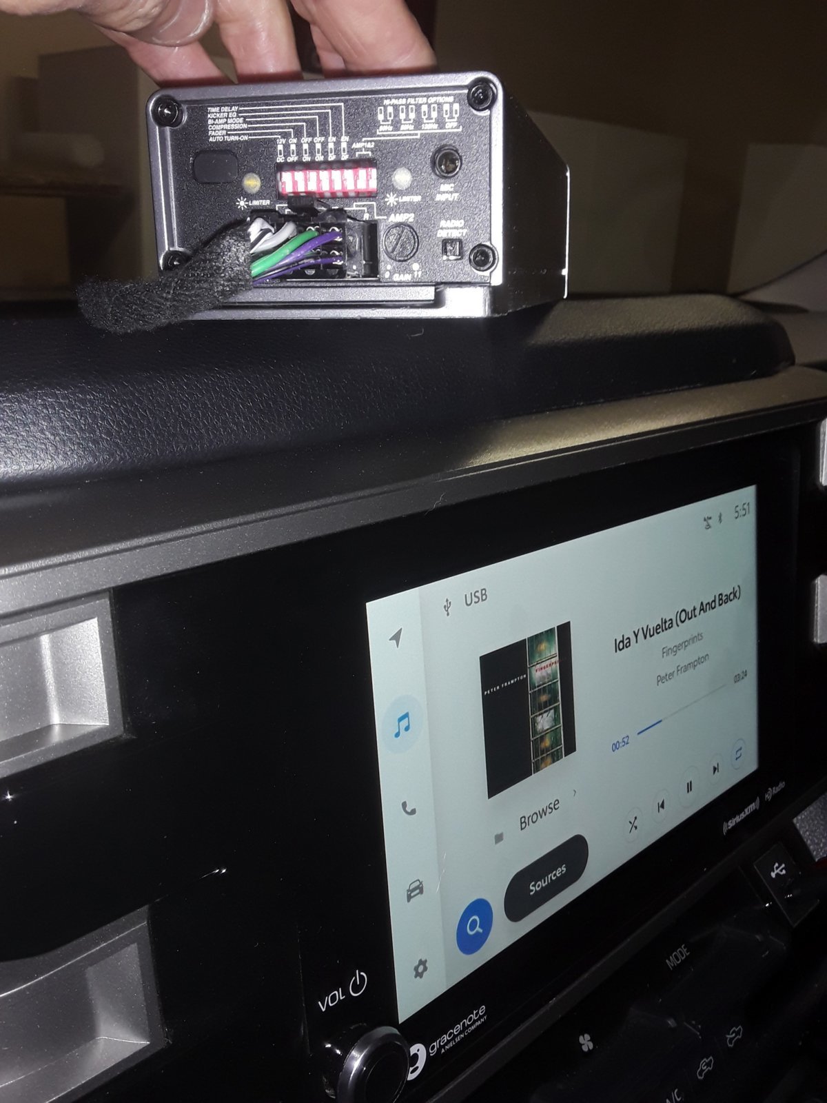

    I installed the beat-sonic a few weeks ago. It has completely transformed the JBL system. Highly recommended!!

    thanks for photo! oh wow, looks WAY better than i expected. Matches well with the interior and size is perfect, i dig it. Perhaps located below the grab handle facing inward toward the cabin a tad more would be my preference but looks fine as is too. Either way, sounds incredible no doubt and this would be a very nice add here. Thank you for sharing!

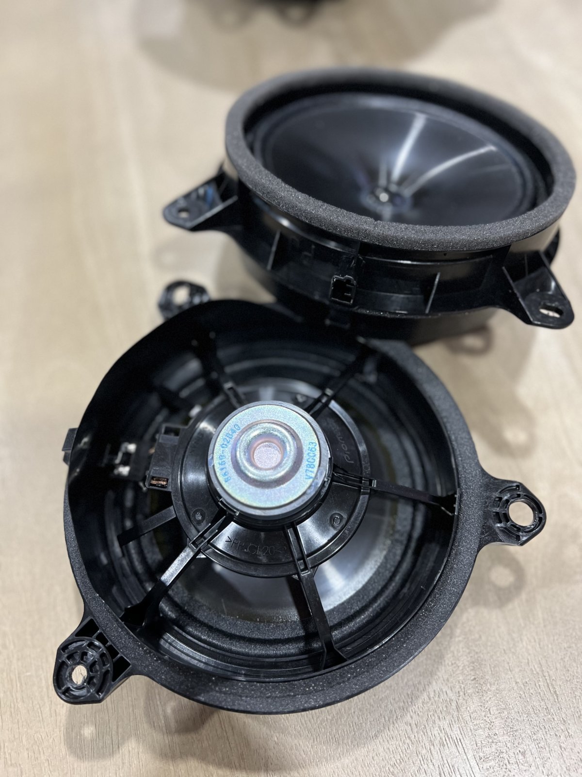

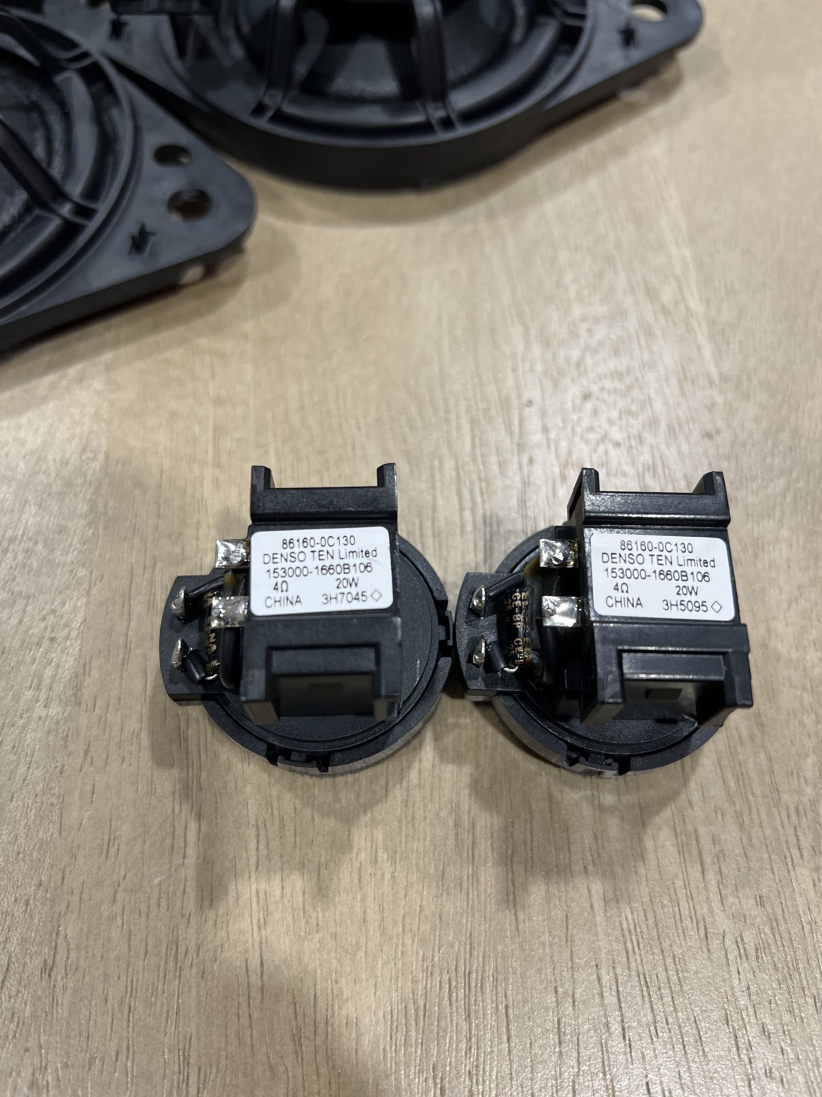

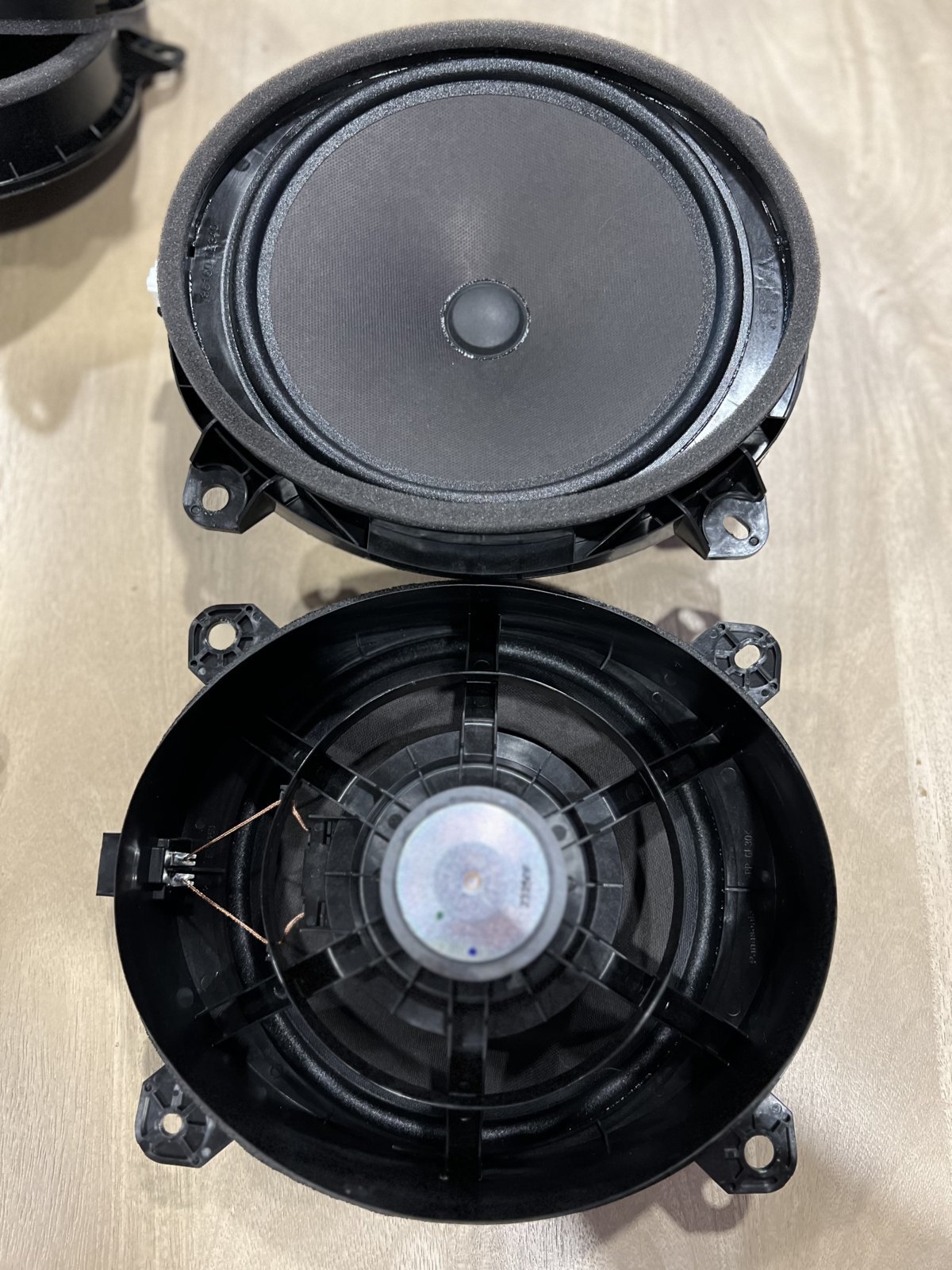

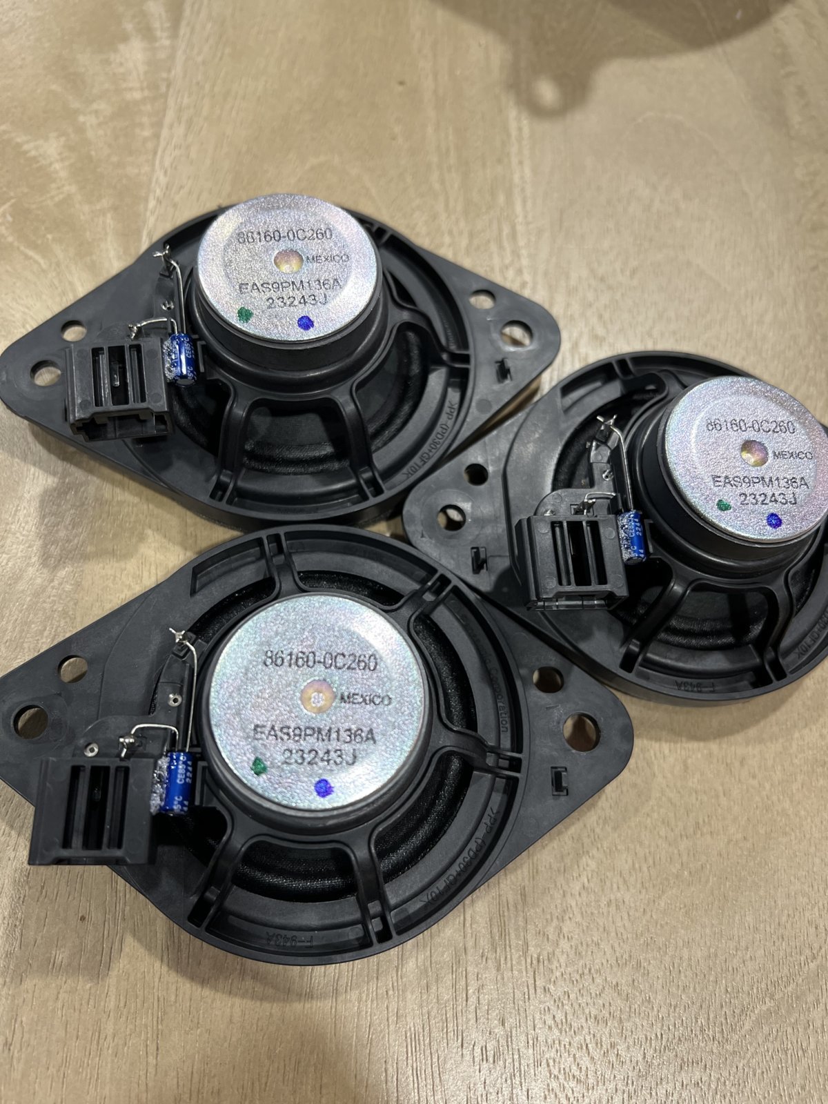

    For what it’s worth, here are the
    Non-JBL specs
    Dash speakers: 3-in Panasonic 8ohm 10 watt x3
    Tweeters: 1-in Denso 4ohm 20 watt x2
    Front doors: 6x8 (in 6x9 housing) Panasonic 4ohm 20 watt x2
    Rear doors: 6.5in Pioneer 4ohm *watts not stated x2

    Would the low wattage be a big reason for the low quality sound? I’d imagine it’s like a midget with a sore throat screaming in an opera house

    Thanks for the pics. Very helpful .
    I thought I could use these but not worth it.
    Noticed the caps on the woofers. So the front doors do nothing else then handle all the bass. The head unit, non amplified only , puts out 15watts rms. Not sure on this but Im speculating as I seemed to read this somewhere.
    The 9 speaker Tundras , non amplified would be really easy to upgrade. But you can’t keep any of the speakers. These are pretty much garbage.

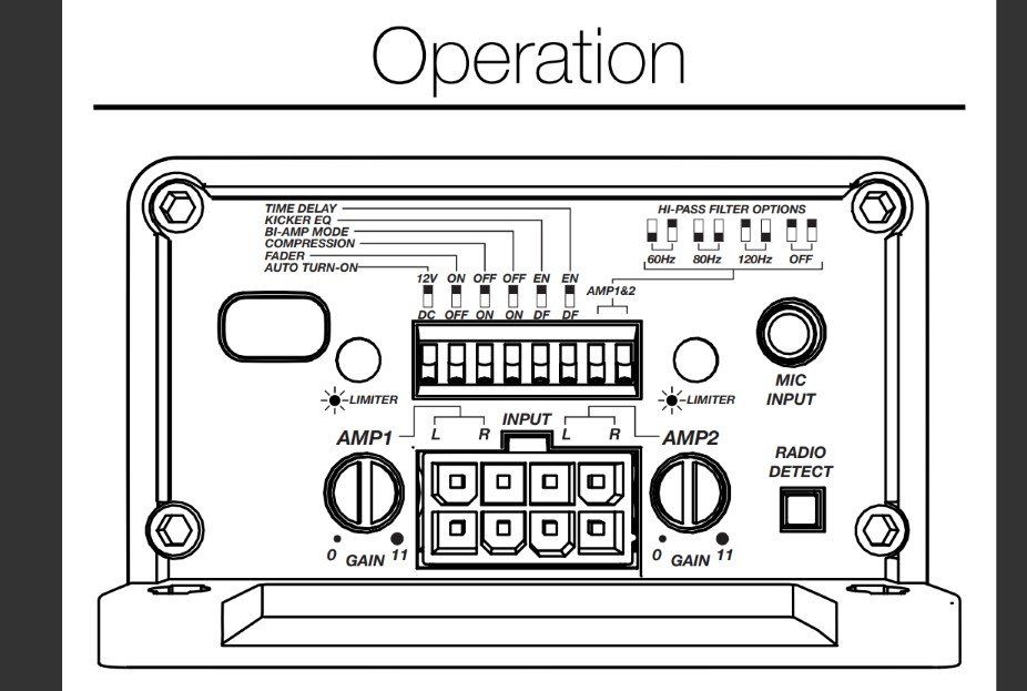

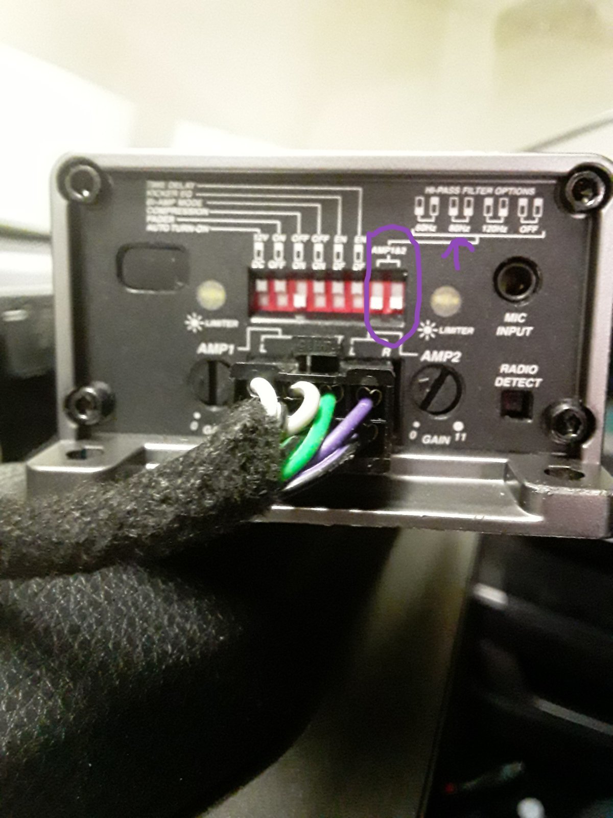

    That is the best setting for the system here as well. I have the hi-pass crossover filter option set to 80hz on amplifier to let sub handle <80hz.
