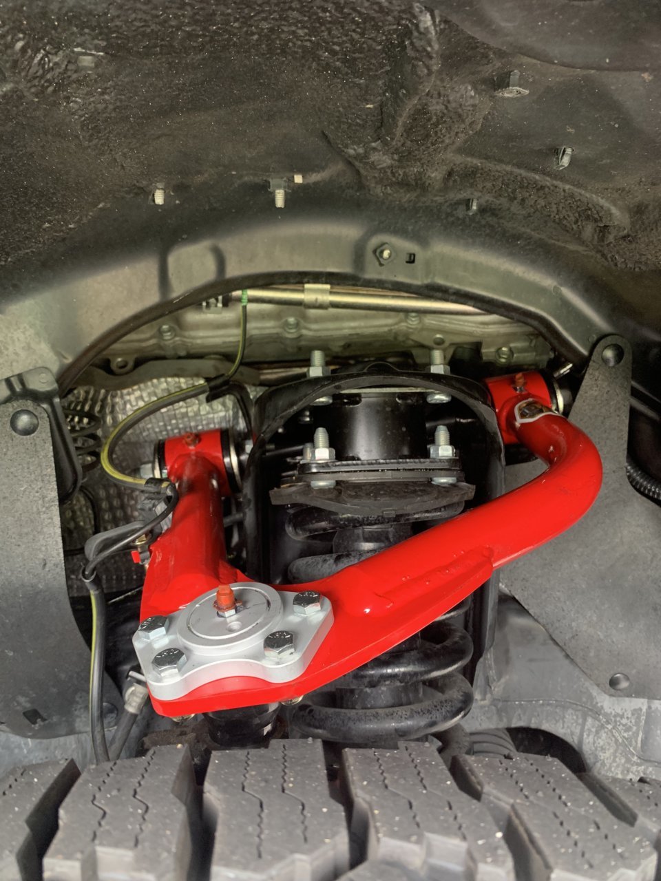

    This is one of the threads I researched when looking for UCAs. Just wanted to update and add to it. Got the JBAs on today. Very nice and customer service was spot on. Plus the red matches my red caliper cover from the XSP package.
