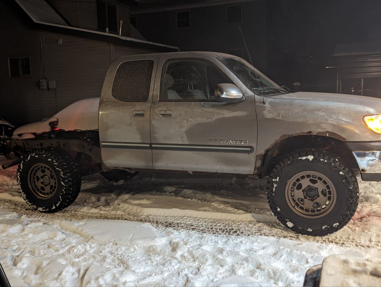

    I have been doing a lot of research on tire and wheel combinations for the first gen. I have not been able to find a definitive answer to my questions after a couple weeks of searching.
    Maybe I am bad at searching. Maybe I just need to be spoon fed. My entire front end is removed. The front fell off. I can't measure but I want to order my wheel/tire combo.
    Question 1: With 17" wheels what is the interference point with the upper control arm when running 4.75" backspacing. Is it the wheel itself or is it the tire?
    Question 2: Do the JBA Upper Control Arms provide additional clearance?
    I'm still a week out from having my front end put back together but I've been looking into wheel tire combinations in the mean time. I have my heart set on some 17x8.5 +0mm / 4.75" backspacing wheels. I'm just concerned about UCA clearance as that seems to be the biggest issue with larger wheel/tire combinations from my research.
    Spacers are a non negotiable for me. Will not run them.
    Thank you in advance.

    Currently have 1.75" OME springs on Bilstein 5200s set to the lowest setting. I would love to fit a 295/70/17 - Keep in mind my fenders are non existent, I have 100 grinding discs and 50 pounds of welding wire. I am purely asking about clearance with suspension components.
    My main concern is clearance with the upper control arm and where it falls into the mix depending wheel diameter, width and backspacking/offset, as I noticed a lot of people mentioning it without really giving me any data.
    Where did you have rub?
    I would expect that size to start getting into pinch welds and really threaten the frame rail at full lock. However, that is based on absolutely no real world experience with this platform.

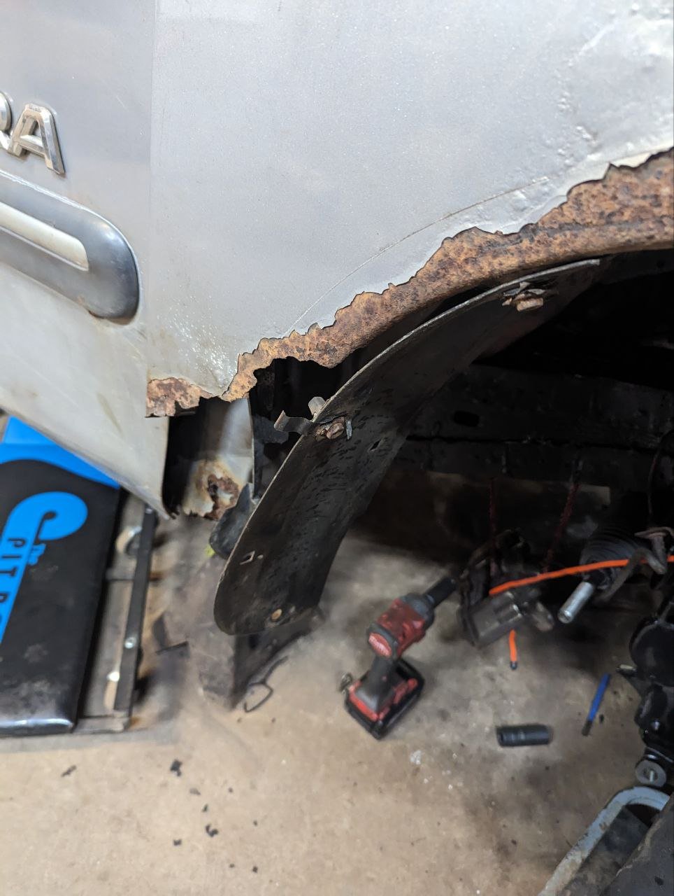

    Man, how's the frame on that thing? That's a lot of rust.
    I'm running ICON coilovers. 17x8.5" SCS wheels with 4.3" backspace.

    I was also curious, as it looks rough...

    He should be able to run 35’s soon. Those fenders are slowly self clearancing……

    It's a learning process. I have my grandfather's Jeep Scrambler in storage that has been waiting for me to gather the skill to properly restore. This rig is helping me gain those skills. Front end is completely rebuilt which was a learning process that doesn't apply to the CJ-8, however now that all the important bits are taken care of I can move on to more fun things. Coming up next is going to be the flatbed build and rock sliders. Also getting rid of the stock rear crossmembers and shock mounts.

    That explains everything. Keep up the good work.
    They won't even exist soon. The weight reduction should help me overcome the terrible gas mileage I am going to get with the extra heavy LT295/70/17s.

    All the parts that matter are there. Not sure what direction I want to go with the fenders yet. I'd like a little bit of bulge but most the fiberglass options I've found are a bit extreme and also expensive. Leaning towards getting some super cheap repops and modifying them to fit my tire/wheel package. I think with some creative fender rolling I can create some extra space.

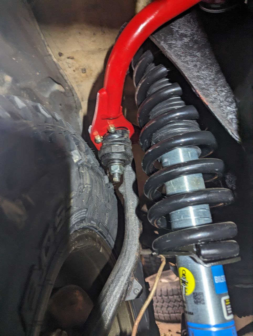

    Do I need to trim my mud flaps?

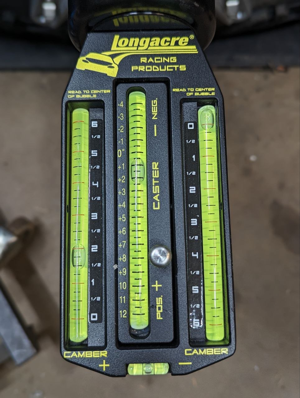

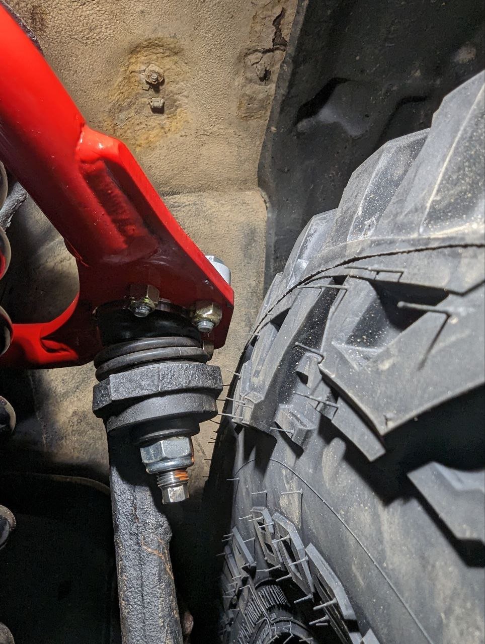

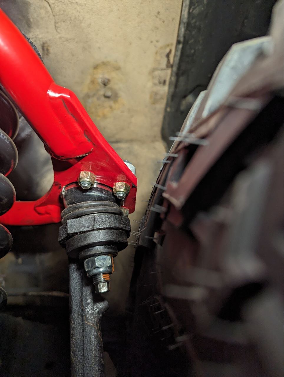

    For anyone who finds this thread in the future this is my current clearance with all 4 cam bolts in the center position. I still need to align it properly, currently it visually has positive camber however I have not put it on the gauge yet.
    Wheels - Fifteen52 Offroad Turbomac HD Classic 17x8.5 +0mm
    Tires - Mickey Thompson Baja Boss A/T LT295/70R17

    Looks like current camber is +1.75*
