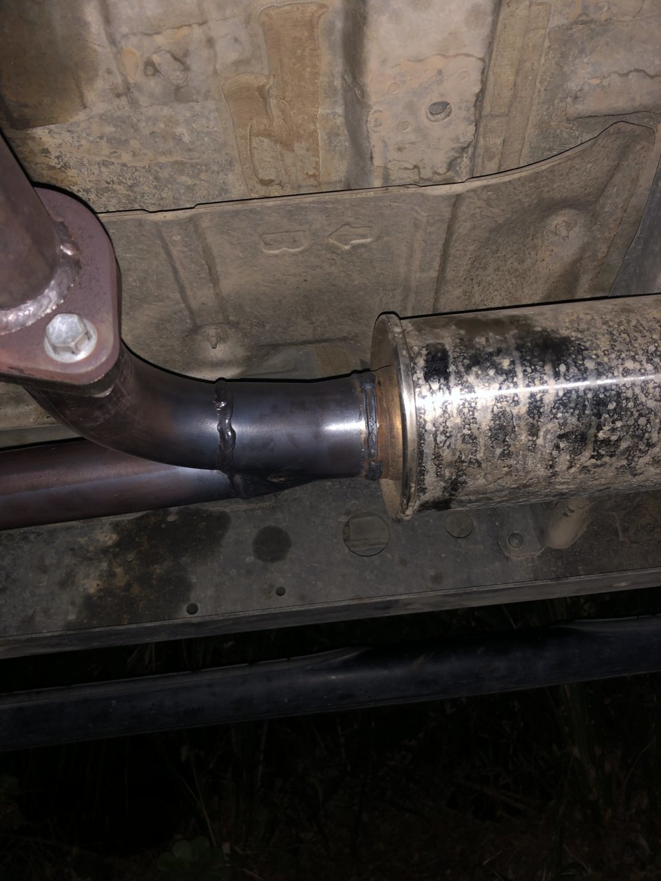

    Pic of ypipe connection to resonator…

    That's possible. When I went to the jba y pipe I had already cut out the resonator, I think. I didn't notice any real change with the Y.
    That glug glug is nice huh.

    It sure is and a lot more noticeable with the AC on/higher RPMs. I have a gut feeling the resonator needs to moved farther back at least. I’m just tired of paying the muffler dude $$$ lol. Wish I could weld it up myself

    I remember the aeroturbine muffler having some sort of directions that suggested at least a foot of straight pipe should be present before and after the muffler to reduce turbulence. It might be applicable to your situation, but our stock system doesn't have much room between the Y and resonator if I recall. Maybe more for sound reduction than power.
