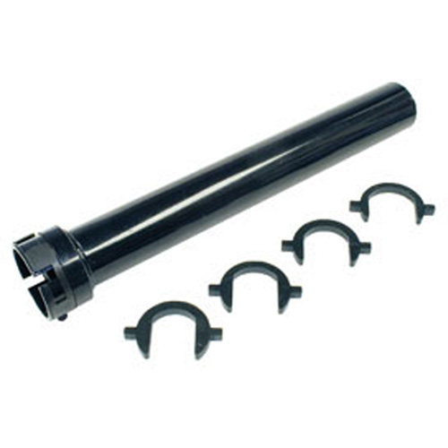

    Damn, I cant decide if I wanna do headers or do lower ball and tie rods.

    how hard are inner rods? Ive replaced outer rods before but never inner

    Depends how stuck they are. Mine wouldn't come out so I left them. Unless the ball/socket part is so worn that its clacking I don't think there is a lot to worry about on them. If they aren't too stuck you just need the right tool and they should be pretty easy.

    Inner Tie Rods weren't that hard for me. I used 20" vise grips to remove mine though...
