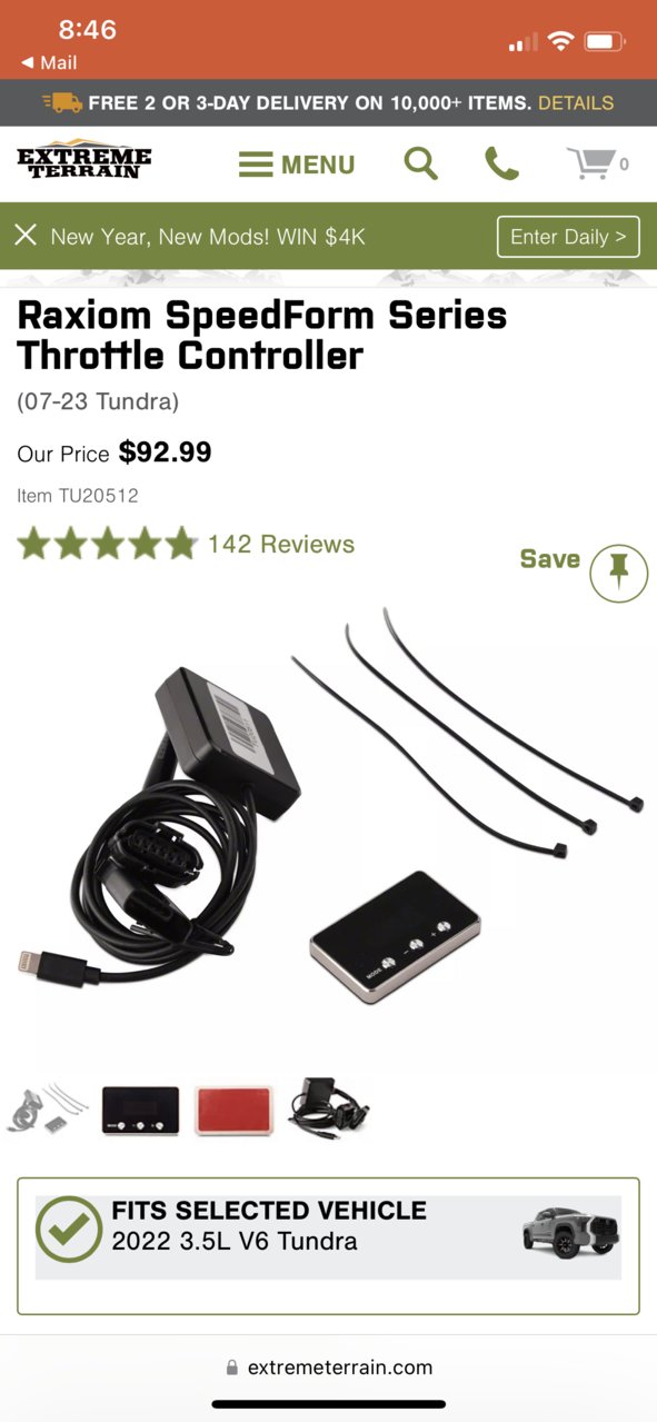

    I have the JB4 on a limited along with a pedal style tuner also and it’s great no real issues. Definitely takes the lag out of the pedal and I run the 91 octane map for the JB4

    Set up works very well. I’m running this pedal commander. Yeah I run 93 when I find it cheaper enough. I would say best two things for the truck or at least top five things you should get on the truck

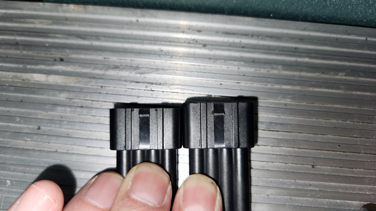

    If you can't get the rear plug to click, sand it down
