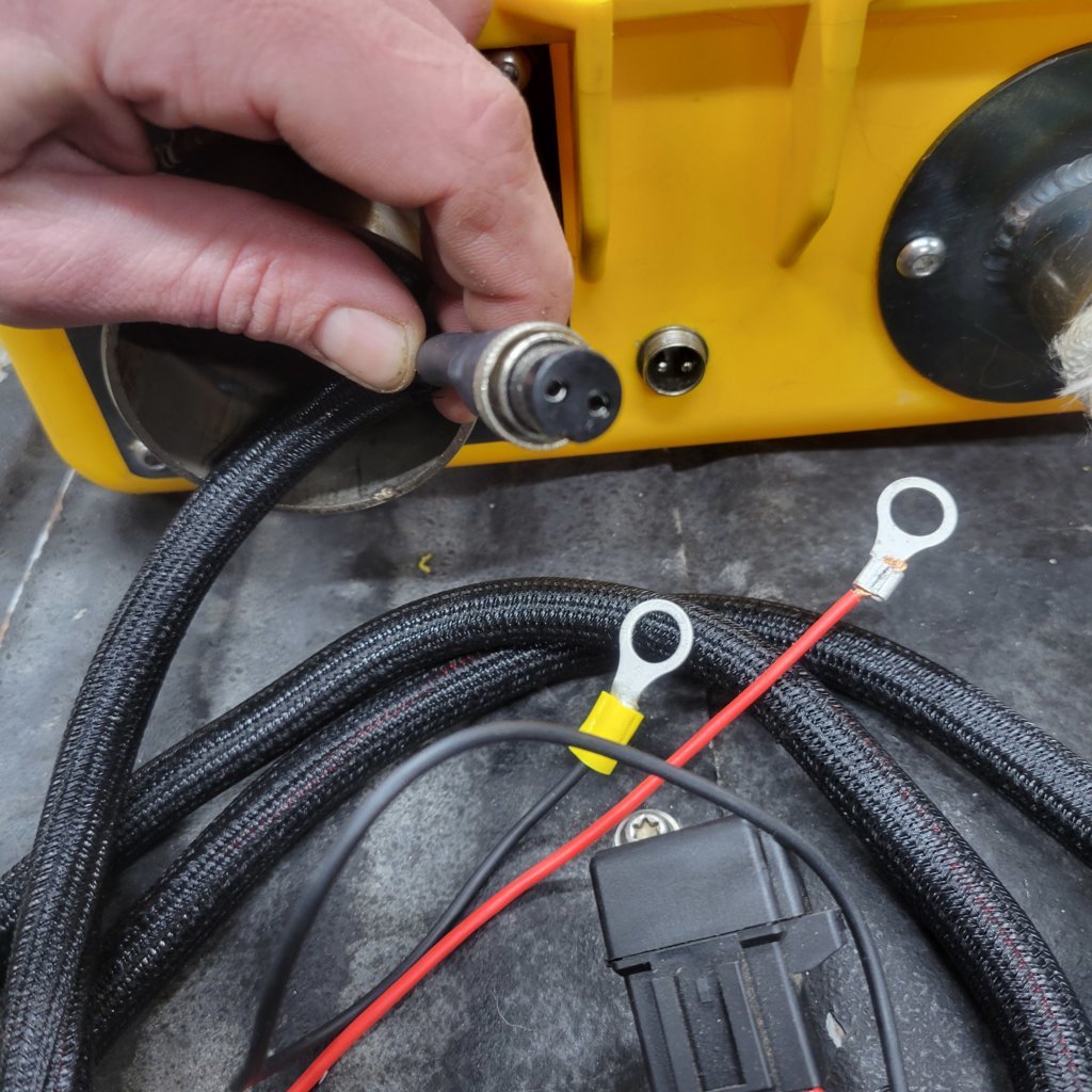

    What gauge wire are you using for the power wire extension? The CDH are picky about voltage drop, I have a 20’ extension maybe? In 8ga

    she smol. 14ga if I remembering right, but that's only because I had it on hand. Just for testing pinkie promise. The finished harness will get 10 or 12ga and be around 5' long.

    That should be good, cut the positive power wire as close to the big molex plug as you can, or depin and get freaky with it…..
    they draw over 10amps at startup/shut down to run the glow plug. I still use my starter battery with mine but I start the truck when I’m turning it on/off. PM me if you have any questions they can be finicky if they aren’t set up proper(fuel line is another big issue, smaller is better)

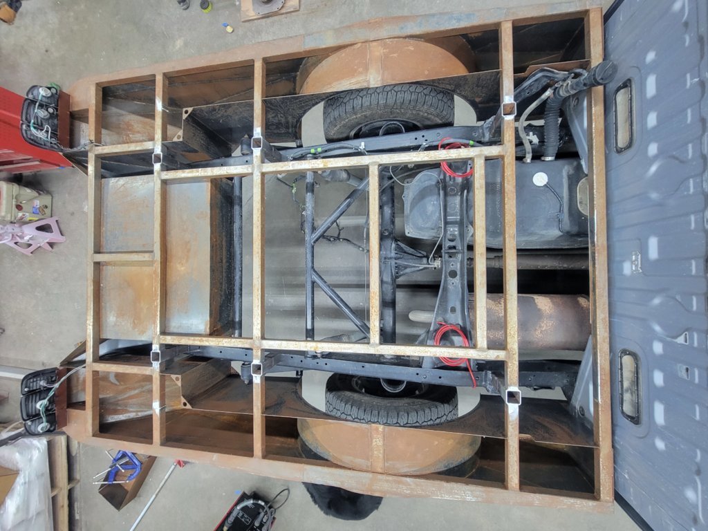

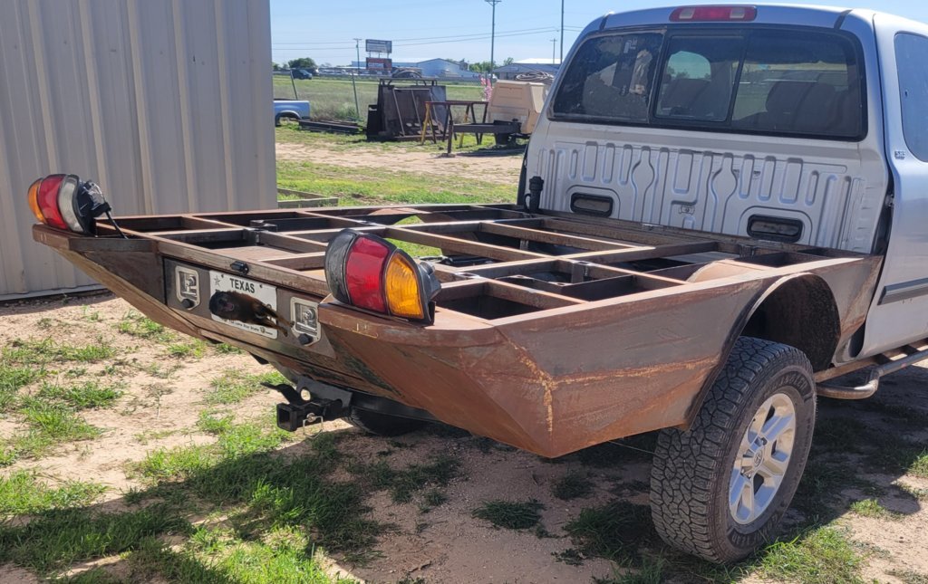

    It's been awhile.
    Got a chance to raise the flatbed working here and there the last few days.
    The last time the flatbed got any attention was around October last year for the first ever annual MERUSTOBER event where I found out that I built the wheel wells way way too tight. This picture is at absolutely max rear articulation/ stuff.
    The easy fix to this is to raise the entire bed. I thought a 2" raise would get me enough, but after measuring the factory wheel wells I needed more like 4" of added height for 9.5" clearance in the wheel wells. Probably plentyish for a truck that is supposed to be more of an RV when finished.
    old vs new. New mount still uses the factory bed bolts, just recessed about halfway down the mount.
    Definitely not my preference to be working on rusty material, but this would have hurt way more if everything were already painted. Notice the location of the cab vents. We are way up there.
    Lots of room for activity. Also a true flatbed now with no obstructions (except for the temporary brake lights). I may piggyback off of the new mounts for the new camper tie down solution.
    Finally mounted the license plate on the drawer and added an led plate light in preparation for dropping the hitch. Used a couple of rivnuts for the plate, and wired the light through the tubing for a cleanish install. Maybe forever, maybe I'll change it in six months.
    Now for the full reveal. This will set the tone:

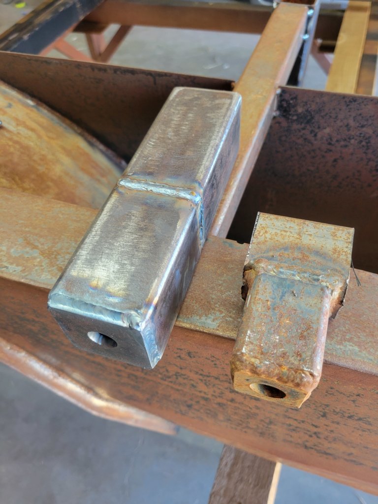

    In a bit of a pickle. Do I want to be 9' tall? I know I want the extra space up top for a cabover, and the extra space for the side storage boxes. It's supposed to be a somewhat capable offroad RV/basecamp/chuckwagon/stabbin cabin of sorts, and not a hardcore wheeling rig right? 9' is a lot though.
    These torsion boxes will serve as the new bottom mounts on the camper. Steel hardware will be through bolted and glassed in for securing it to the flatbed. The whole thing gets wrapped in a couple of plies of fiberglass and glassed onto the bottom of the camper.

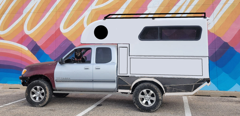

    I don't know if I've posted these here, but ultimately this is the kind of direction we're headed.

    Dale's wants an easily accessible rooftop sun bathing spot.
