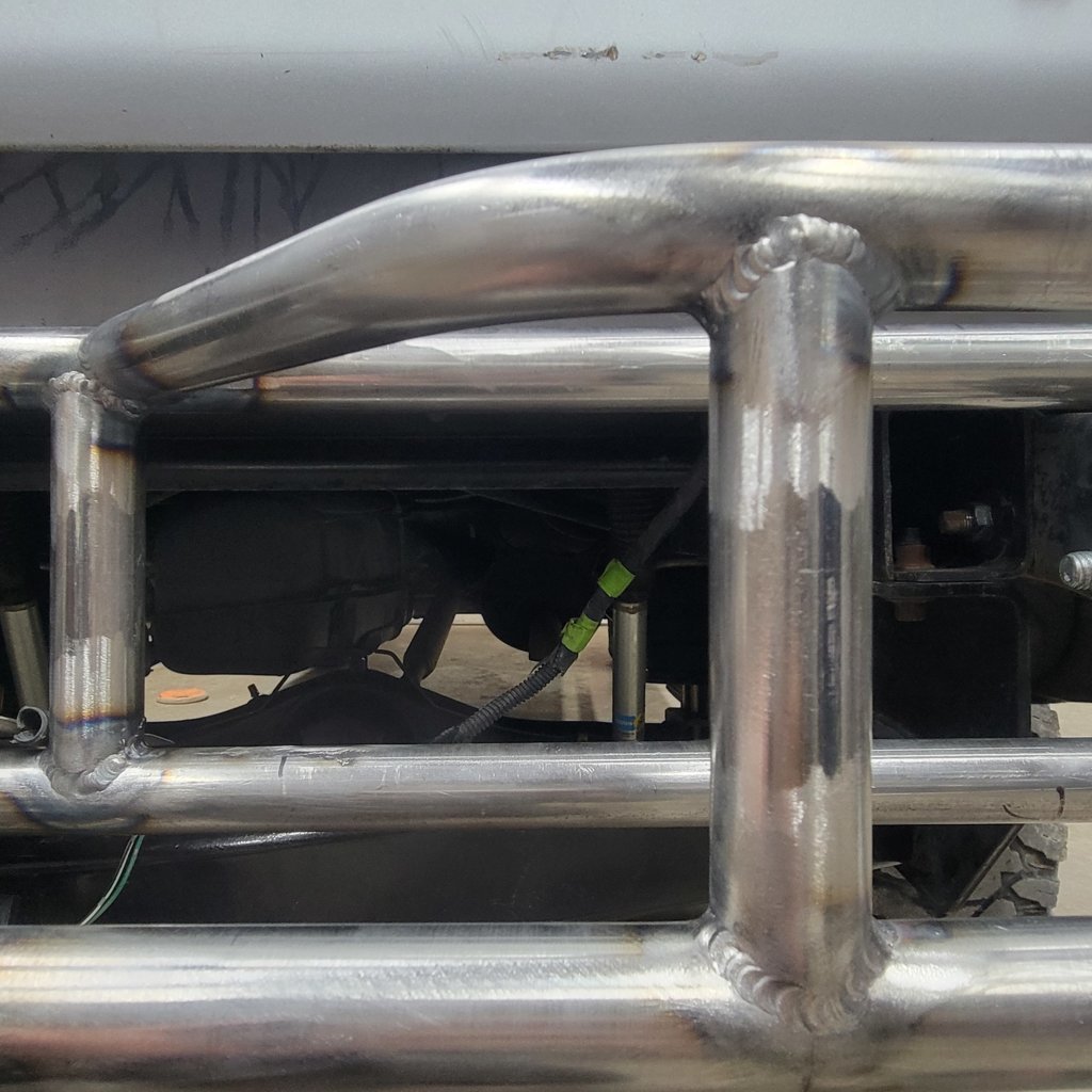

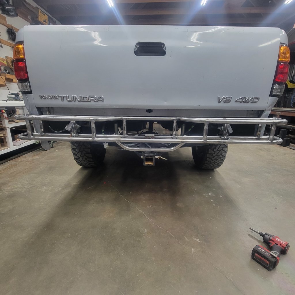

    Not a whole lot of visual change today.
    My airline from the compressor into the shop has an ice plug somewhere so no plasma/bender.
    I did manage to get a tube bent to tie the bumper to the factory hitch. I think its really what the whole thing was missing.
    Tig'd everything out today too.

    Bassani cat-back
    Wheres the windshield washer take & nozzles gonna mount? Tailgaters love oil sprayers.

    I feel like the hitch could have been worked into the bumper some how. Looks good but that little fucker hanging low bothers me

    Definitely could be. I have a tow rig so in reality the hitch could just come off. Most people aren't down with modifying a hitch, and im trying to appeal to the largest group possible.
    yep. Without the factory hitch people would be tearing off rear bumpers and bed corners constantly. Some of the MERUS stuff would be eating tailgates.

    One of the best parts about the BFF rear is the hidden hitch, that I rarely use. :D
    Now that I've got another truck with a hitch, I doubt I'll use the BBF bumpers hitch unless I bobbed the bed and bought a small camper to tow. Of course that would mean I'd have to modify the bumper or go with something different.
    Still a neat option to consider in future bumpers. :thumbsup:

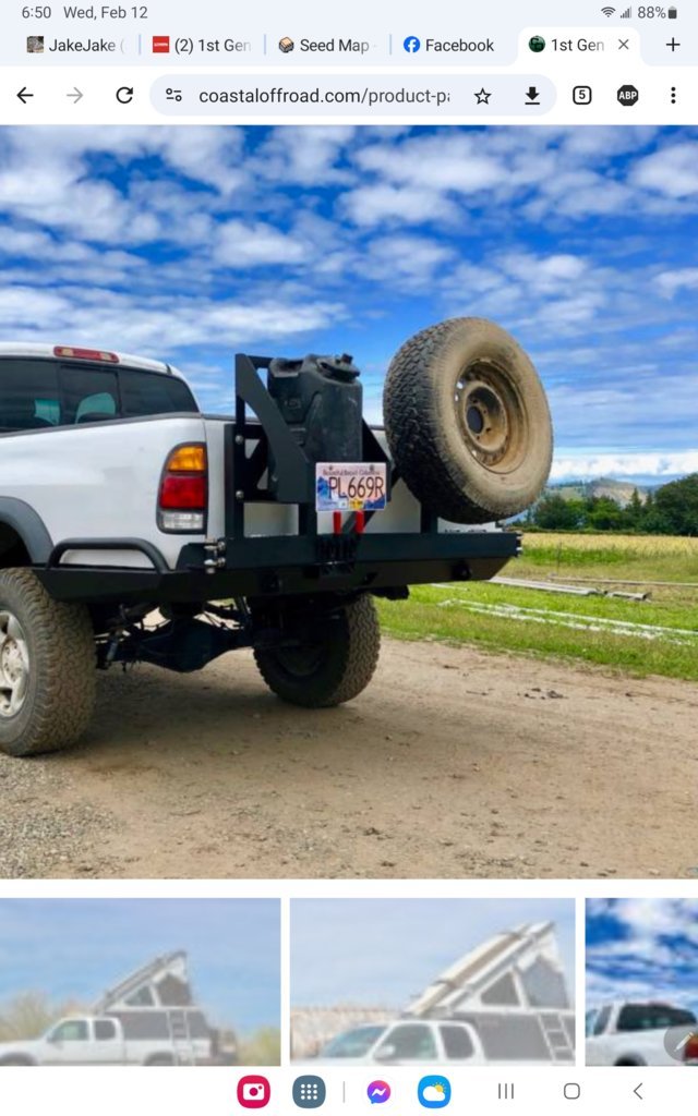

    I'd like a high mount bumper when we get to mine. Something like the costal. Then paint the sides of the bumper gold to match what I have now. I dunno. Just thinking aloud.

    The costal has a high cut into the lower bed.
    So I would paint just the side to match my two tone.

    Yeah the coastal has got to be a good inch or so higher clearance than my BFF high clearance, too.
    Mines chonky. Penelope's definitely rubbed dat ass all over some trails. But it doesn't budge.

    Yeah the BFF cut is the biggest I've seen. Got a few no cut designs I want to explore before I go down that rabbit hole.

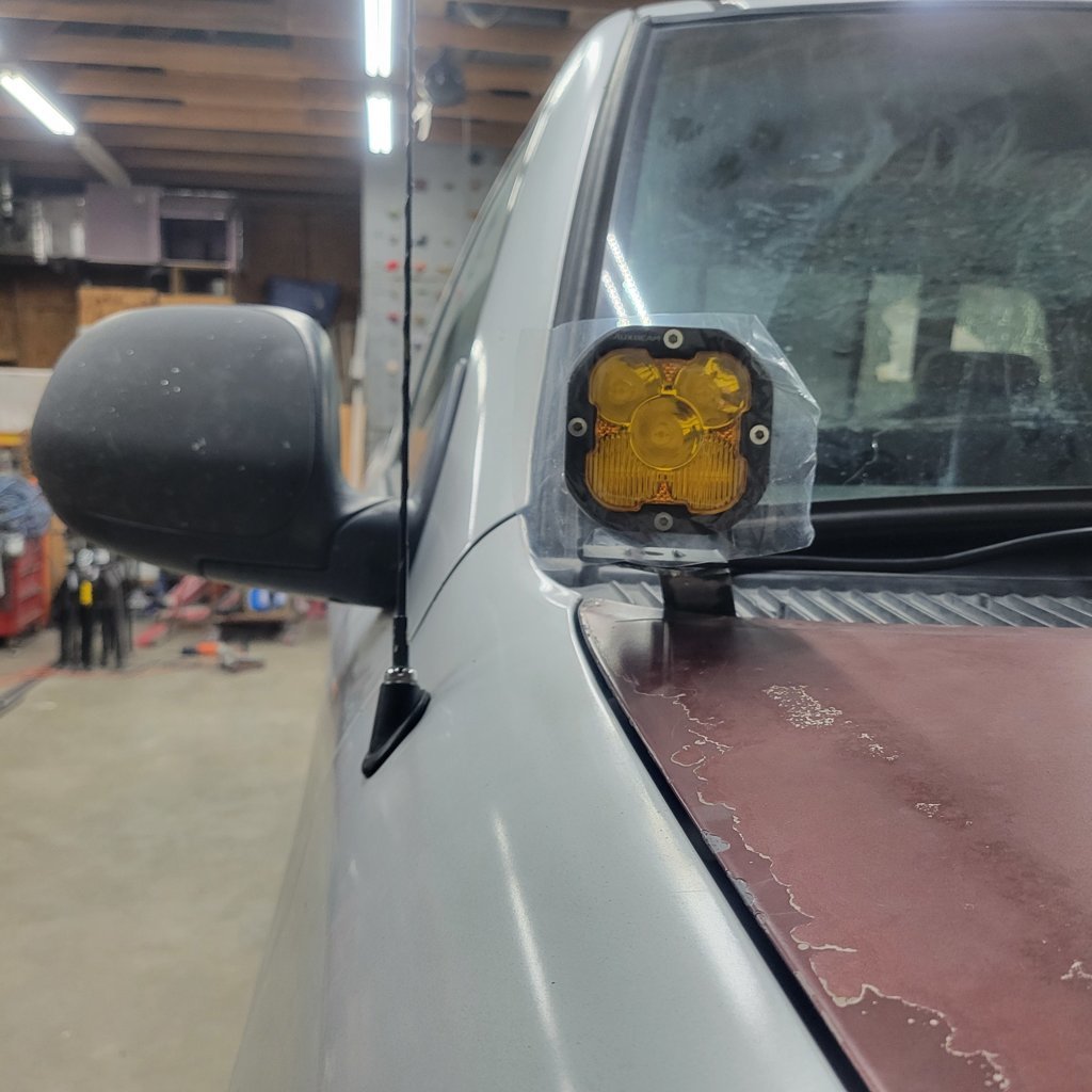

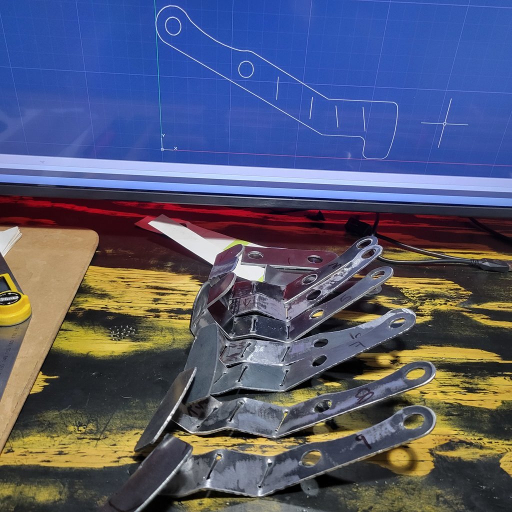

    Im only a couple of revisions away from having some ditch light brackets prototyped :rofl:I think #10 or 11 is on the truck now. Final parts won't have the scored bend line, doing that just speeds up the design process.
    Picked up a pair of Auxbeam's Xp-ultra 3" pods for them. At a quick glance the build quality looks good enough for who it's for. I'll likely do a review after I get them installed.
    It's been bitterly cold the last several days. Looks like we will be above freezing today, and tomorrow kicks off 10 days of 60 degree daytime temps and above freezing overnights. Got a few more parts designed that I'm looking forward to flesh out in the shop.

    Coincidentally I just finished these up. I think I have 4 days in this first set. Countless poster board templates, 13 steel prototypes, and around 20 separate drawings :rofl:I still need to hit them with some powder coat. Some of that time was also used to build the bending tooling and some layout jigs for consistency. Pretty stoked on how they came out!
    high and tight!
    The Auxbeams fit and finish are hella meh. reserving judgement for now.
    Now to get them wired so I can play with them.
