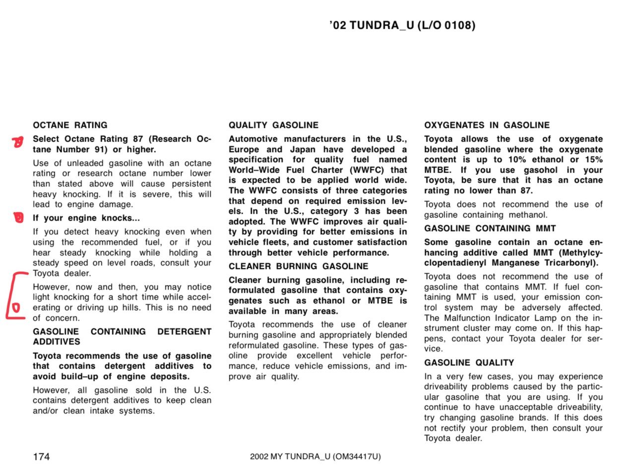

    Now here's my . 02¢ worth. The owners manual says "87 octane or HIGHER". I don't check my milage so I can't give you numbers but I find that my engine runs better and I go farther on a tank of gas by running 89 octane. So I will only use 89 or higher octane.

    A toyoya master tech told me toyota’s require a certian octane. 87 for example. The timing/spark is relying on that octane for timing. Higher or different octane changes the timing of the detonation which changes performance and gas mileage. Yes sensors compensate to correct but again it changes timing fuel milage and performance.

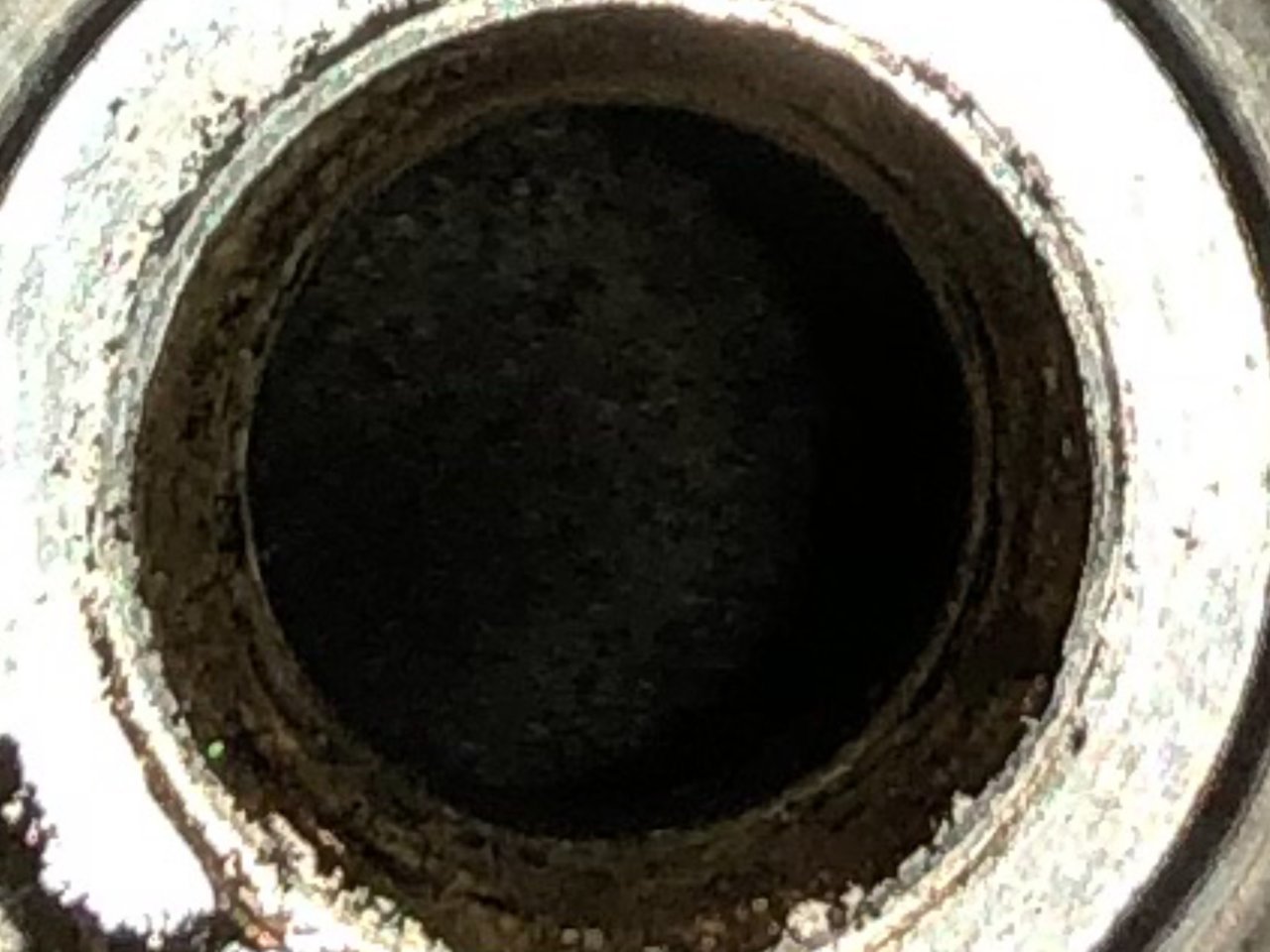

    Hows this for carbon build up? Think this is a shot down the #2 plug tube. Not sure if the camera is making it look worse. Whats the pros tip on carbon removal?
    Truck is purring currently and running fine as best as I can tell without hooking it up to an analysis machine. New plugs, coils, and have been on 87 octane.

    I really didn't think this thread would go this long. It's not really something that is to be argued/debated/squabbled about. If we were discussing amplifier power ratings, I would understand since there is no standard of measure that manufacturers follow and government oversight to ensure they adhere to these standards.
    In other words, 100 watts x 7 channels amplifier ratings is marketing gimmick.
    Can you run 87? Yes, Toyota designed the engine to run on 87.
    Can you run 93? Yes.
    Is there any advantage to 93? In terms of power, no. Cleaner engine, yes because 93 has detergents.
    Your engine will not knock, ping or spontaneously externally combust because of 87, 89 or 93.
