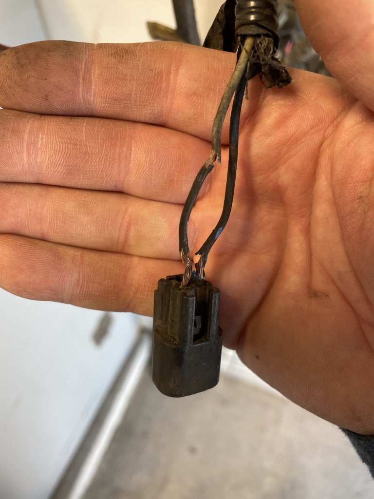

    Hey guys, it’s been a few months and this issue has still been happening. I finally got around to putting in a new engine harness that I bought from someone on Facebook. When I took the old one out I noticed the crank sensor wires looked a little odd. (See pic)
    I’m hoping that was the issue. I assume if the truck is driving and it loses crank signal the ecu would shut off? That’s what I’m hoping.

    Is that a crank position sensor harness, or knock, or camshaft position?
    As you'll see in this thread that has a ton of diagnostics info with pictures etc. a LOT of people misroute the crank position sensor and the wires get chewed up but that's not normally what it looks like, note bold red text.
    • These trucks usually don't have a ton of other electrical issues. Hidden corrosion inside the battery/alt cables happens. Sometimes, a couple thousand miles after timing belt changes, people will have startup issues because the crank position sensor wasn't properly tucked away and gets rubbed by a belt (pic), correct routing info here. There's also a similar problem with camshaft position sensor under the cam cover, where the belt will rub through (pics). There's the rodent issues mentioned earlier. Occasionally, water leaks can send water down into the ECM behind the glovebox (pics), or into the fusebox inside the cab/dash (pics & pics & pics, it happens a LOT). Many drain/vampire issues trace back to aftermarket add-ons whether the owner knows they exist or not - alarms as mentioned earlier, brake controllers, poorly installed trailer receptacles, those are some big ones.
    Anyway, that looks almost like what you'd see with knock sensor wiring up under the intake, where rodents love to nest and chew up the wires.
    FYI: If the crank position sensor wire gets damaged to the point the ECU can't detect if the engine is running, it shuts off power to the fuel pump as a safety feature. Don't want the fuel pump to keep pumping gas if the engine isn't running.

    Yes, that is the crank position sensor connector. I would assume that it was grounding out at higher speeds and causing the ecu to shut off but who knows. It is a ford ranger so there is no telling.

    Ah, it's a ford ranger.
    I mean, one way to find out. Either depin the connector and heatshrink over those spots, then use some brush-on liquid electrical tape on the other spot, and see if it fixes it (or just brush the liquid tape on everything) and see if it stops or not. But yeah, if those two wires are arc'ing, I assume Ford does the same as Toyota and either shuts down the engine to prevent damage, or if it shuts down the fuel pump or what.
    I believe in our Toyotas (maybe not that Ford) the crank and cam position wires (and I think even the knock sensor wires) are shielded. Knowing Ford, they may not give a shit.
