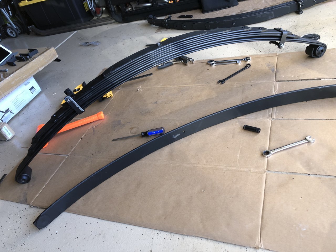

    Next up, suspension... ✅
    I went with Icon Stage 9: front coilovers with remote reservoir and CDC, rear shocks with remote reservoir and CDC, multi rate RXT leaf springs (all in - max height) and upper control arms but not the billet aluminum option, which I’m now regretting.
    FYI, instructions call for dropping the rear diff one side at a time but doing it this way I wasn’t able to make the leaf pack fall into place so I opted to drop down the whole thing and it made a great difference. Also, on the front, I disconnected the sway bar (both sides) in order to do the coilovers otherwise, these were not gonna go in. It might be different if doing the install on a lift.

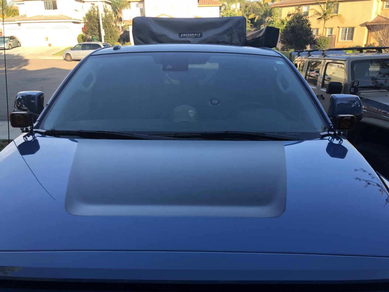

    Completed chrome delete on the exterior (hood bulge, grille and surround):
