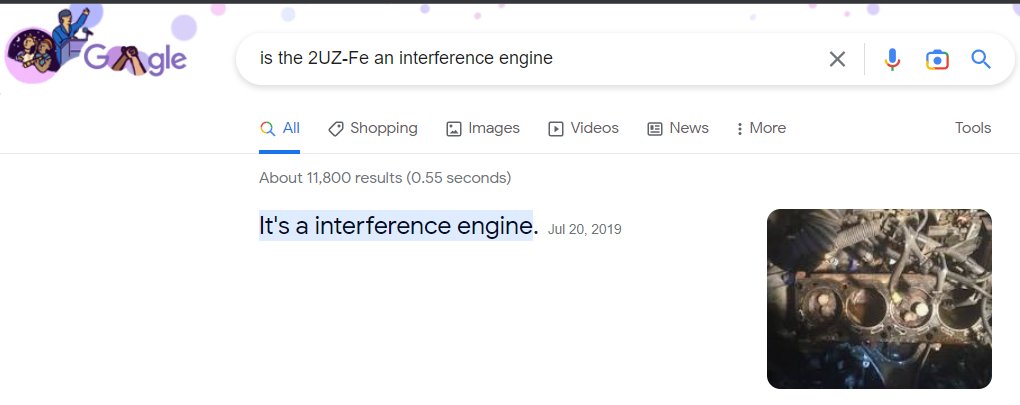

    Yeah, naw. It's an interference engine if it's a V8/2UZ-FE. Whoever told you that is not correct. And you're a lucky dude, go buy a lottery ticket.
    $1,800 isn't the worst I've seen for replacing timing belt, water pump, tensioner and pulleys, but it's not a drop in the bucket either. I'm trying to think back, I think the best quote I got locally was more like $1,650 but one was like $400 north of what you got quoted. I see guys on here with stealerships charging $1,300 and I'm jealous!
    I could re-link you to the research I did, but here are just a couple of hits on it. Gates (major parts manufacturer) clearly lists all 2UZ-FE as 'interference', and parts fitment and accurate information is critical to their products.

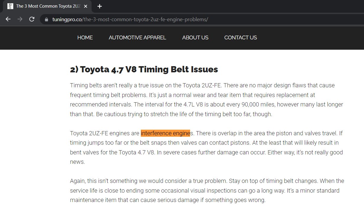

    Best explanation, read the middle paragraph of what I just posted: "valves can contact pistons". It's not a definite. But it's definitely not something you want to risk.

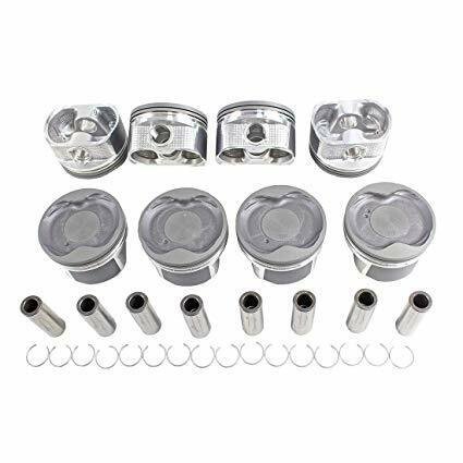

    I also noticed in the engine tear down video that the VVTi engines at least had scalloped pistons with valve reliefs in them. I’m not sure if it’s enough to clear the valves completely, or if the earlier non-VVTi engines had the same pistons.

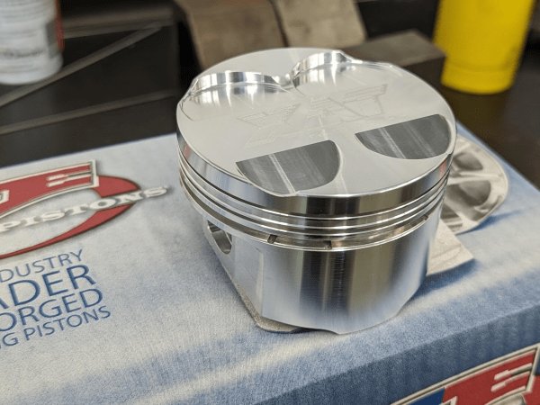

    if you really wanna whack a valve, XAT goes up to 12.5:1 or higher.
