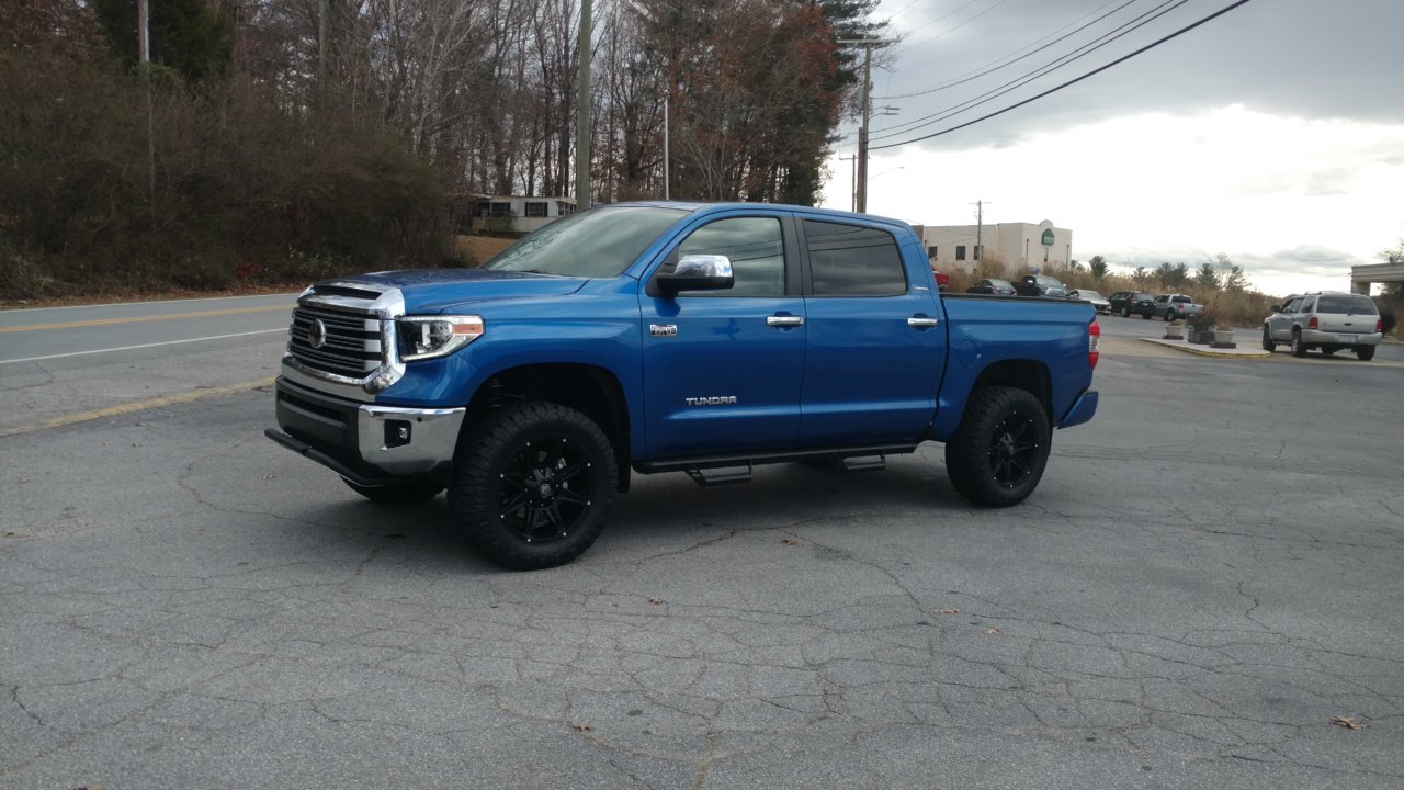

  2. Nov 30, 2018 at 3:51 PM
    #32
    RZRrider112
    RZRrider112 [OP] New Member
    Aug 25, 2018
    #18570
    39
    Lance
    Waynesville NC
    2018 Blazing blue pearl crewmax limited tundra/2003 White Tundra SR5
    2.5 inch leveling kit, 285/70-17 Nitto Terra Grapplers

    Looks good. Just color match those handles and mirrors. Or maybe black would be better. No, color match because of chrome grill.

    I eventually plan on going with either a trd pro grille or the honey comb grille. I do want to color match the handles but I will be putting on tow mirrors which are black or course. Know where I can get JUST color matched handles?
