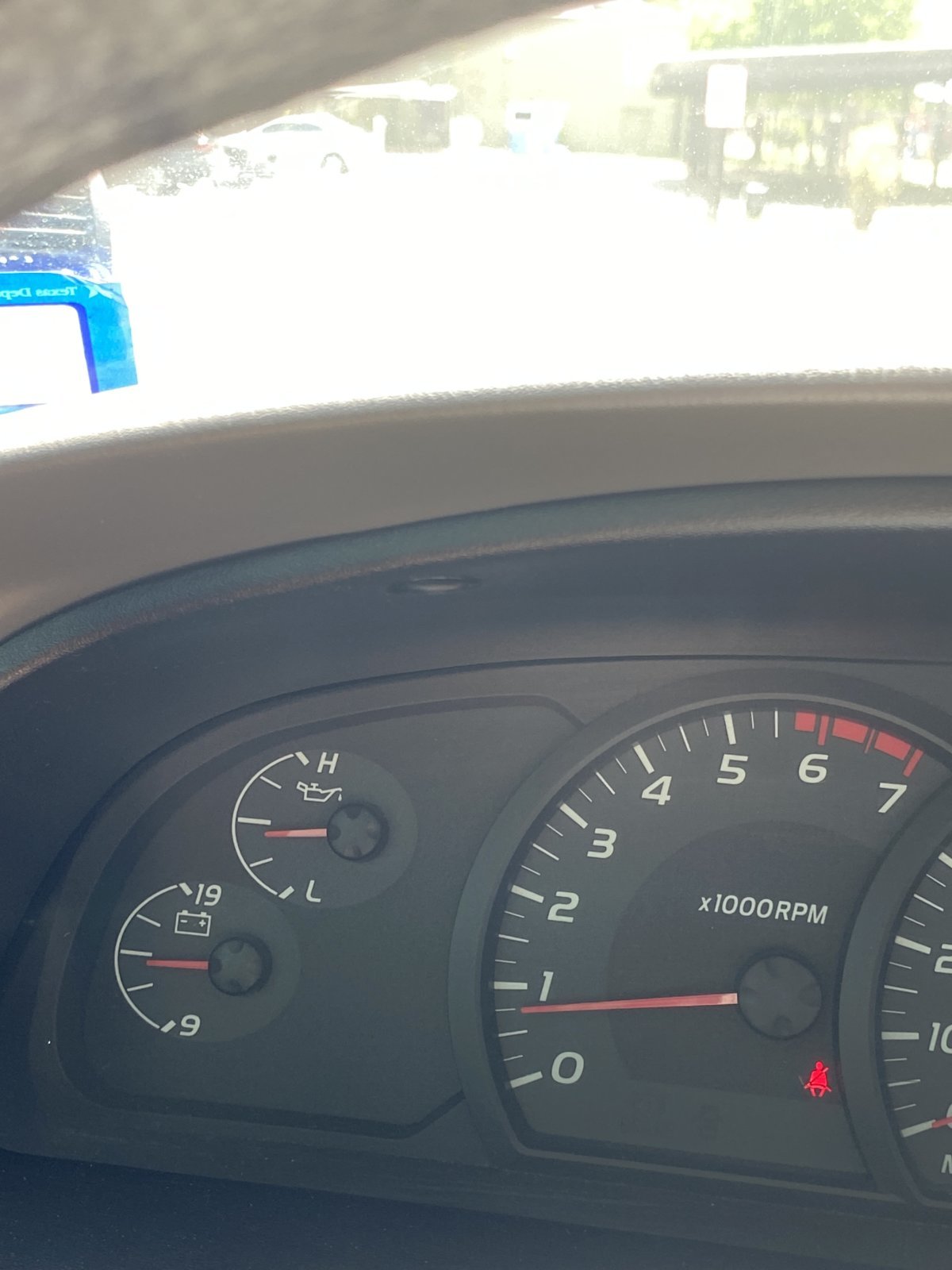

  10. Jun 13, 2024 at 1:29 PM
    #70
    FishNinja
    FishNinja HIDE YOUR DAUGHTERS
    Jan 3, 2024
    #109562
    2,184
    Lee
    TEXAN....big surprise
    06DC2wd
    you got low oil pressure. Unless your gauge is fucked.
  11. Jun 13, 2024 at 2:08 PM
    #71
    CascadeSkyline
    CascadeSkyline [OP] New Member
    Jun 29, 2023
    #99470
    187
    Forks WA USA
    05 AC Tundra Limited 4x4
    I posted a video on the first gen tundra fb group when I bought the truck and like 20 people said this was normal. If not then yes I need to figure out what's going on.

  12. Jun 13, 2024 at 2:15 PM
    #72
    KNABORES
    KNABORES Sarcasm incoming
    Jan 1, 2020
    #40572
    15,216
    Arkansas
    Your oil pressure is fine.

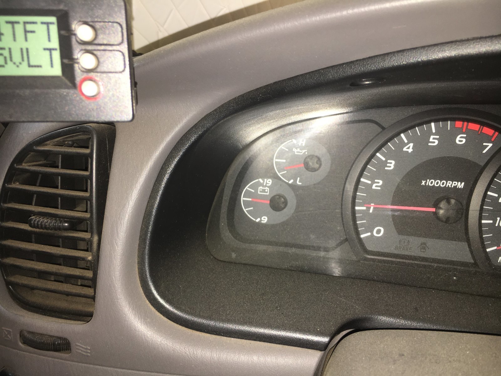

  14. Jun 13, 2024 at 2:18 PM
    #74
    FishNinja
    Jan 3, 2024
    #109562
    2,184
    Lee
    06DC2wd
    So a wonky gauge? Mine is nearly half way up at idle. And will go past half way when on the gas. IMG_4620.jpg
    you also got a 00' while me and OP got 05-06's. My assumption maybe different read outs? I could be wrong
  15. Jun 13, 2024 at 2:21 PM
    #75
    KNABORES
    Jan 1, 2020
    #40572
    15,216
    Arkansas
    I watched his video. His behaves just like mine. Around a quarter at warmed idle. Never much over 1/2-3/4 space when on the gas. Send a pic of yours at idle after warmed up.
    FrenchToasty likes this.

  17. Jun 13, 2024 at 2:25 PM
    #77
    FishNinja
    Jan 3, 2024
    #109562
    2,184
    Lee
    06DC2wd
    Here's my oil gauge at idle.

  19. Jun 13, 2024 at 2:28 PM
    #79
    KNABORES
    Jan 1, 2020
    #40572
    15,216
    Arkansas
    After the truck is warmed up and the idle drops?
  20. Jun 13, 2024 at 2:29 PM
    #80
    FishNinja
    Jan 3, 2024
    #109562
    2,184
    Lee
    06DC2wd
    yup. The truck is well beyond warm right now. It's been running since 8am.
  21. Jun 13, 2024 at 2:30 PM
    #81
    KNABORES
    Jan 1, 2020
    #40572
    15,216
    Arkansas
    your oil pressure is high, you should get that checked out!
    :D:D:D

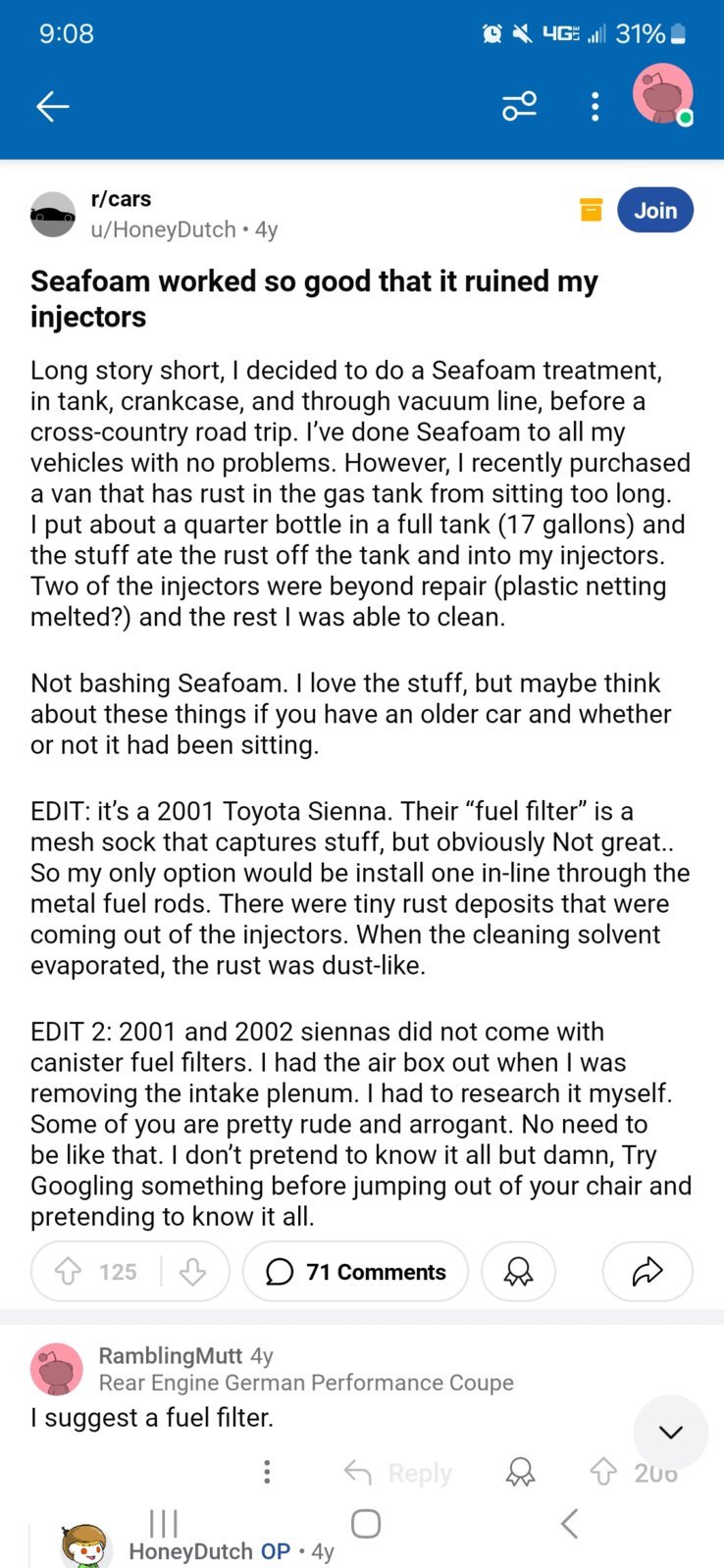

  23. Jun 13, 2024 at 2:32 PM
    #83
    FishNinja
    Jan 3, 2024
    #109562
    2,184
    Lee
    06DC2wd
    it gets checked once a week. When I put the throttle to the floor and run through 2-3 gears redlining my truck.
    I'd also like to add my truck is NOT the one dying after an oil change. As a matter of fact, last week I did the seafoam treatment in both my tank and crankcase. Damn well exactly like OP. 6oz in the crank, dumped the rest in the fuel tank.
