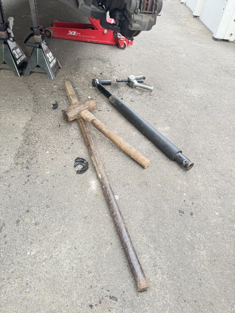

    Okay, extracting tool, a steal bar and hammer. Smacking it on both sides of LCA broke it free!
    Thank you all for your help.

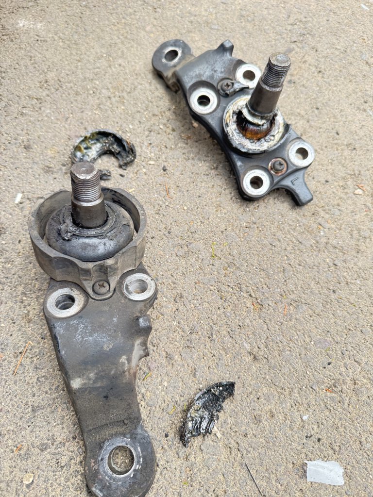

    Yep it was a quick finish. Thanks again, it did the trick.
    I think they were pretty shot, glad they’re off the truck (I removed the boot).IMG_9202.jpg

    I noticed the first picture showed a hammer, but the second picture showed a SLEDGE hammer! There's a big difference. When you are working on a project like this, you need a sledge hammer. Doesn't surprise me itworked that time! :)
