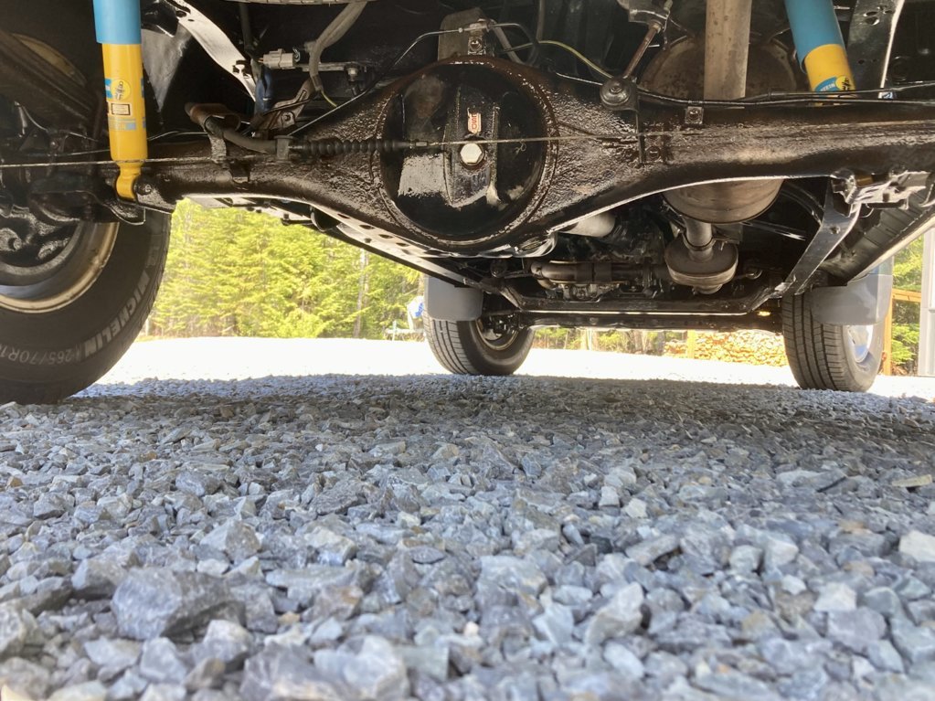

    Quick update: I found an independent Lexus/Toyota specialist in town. He’s personally owned a couple 1st Gen tundras that both died of rust cancer here. He said I have 5+ years on the frame easily, likely 8+ years with some elbow grease. Core frame is solid. He said he hasn’t seen a better truck for under $15k within 200 miles and he’s looking himself for his son. I paid $12k after taxes and fees. He recommended starting with all fluids, belts and pulleys and tensioners, thermostat, new radiator, and the lower ball joints (I acquired OEM parts for this). This was in line with my expectations but a relief. Will let you all know if we run into any other hiccups.
    So I have started by removing the battery and wire wheeling and sanding under it. Got new oem battery hold down. Cleaned and polished what I could in the engine bay. Then spent 5 ours this morning wire wheeling and sanding the frame. I’m getting down to bare clean hard metal pretty easily. Four cans of fluid film so far. There are spots I don’t like, but the areas of importance seem solid. I will continue to bathe it in lanolin, and be watching each year for touch ups.
    Found front and rear 4600 bilsteins for $350 shipped, couldnt resist. I will be around $15K all in with purchase, parts, and labor. Not the best deal, but hoping for plenty more life left. Ready to start enjoying the truck! Driving around town, it’s so smooth and straight. Nice ride.

    Looking at the frame pictures, if you cleaned up the rust and coated it, I don't see why you'd not get 10 years out of it (at least judging by where I live).
