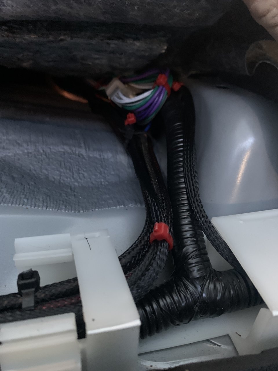

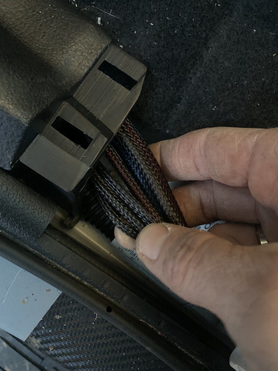

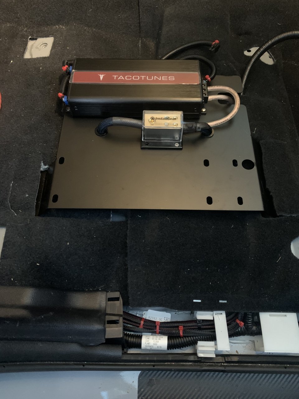

    I’m actually in the middle of doing my audio as well as many other upgrades. I wanted to say that the videos were helpful and the service I got from ********* was good. The only thing I didn’t like and something that almost made me go else where was the install they did on YouTube was a bit sloppy. I know it doesn’t have to be perfect but with the length of wire in the pnp kit you can’t just stick 12” of loom on it and shove the rest under the carpet. I pulled the excess wire back and zip tied it. I couldn’t deal with a rats nest. 2 gauge power going to 4-8gauge power wires. Just one to the taco amp. A few pics of my install. Yes I set up a tent to block rain and the potential for snow. With the other mods I’m on day 3 8FF118FB-6501-4EC4-B96B-6F58C7D414E1.jpg 567B2A8D-CB36-4C35-A7C2-1DCB802DEBCA.jpg

    That’s a damn clean install there!
    Did you go with the 5-channel amp?
    I only see the one amp on there.

    Never mind. I saw your previous post about going with the 4-channel amp.

    Thank you sir. Yes on the 4 channel. I’m limited on space so I have 2 self powered Kenwood psw8’s going behind the double cab back seats. Speaker wires for the input, power and remote wire. Also ran an 8 gauge for the wireless one air compressor and another for the HornBlasters train horn setup.
    I ran all the wires in this protector sleeve inside and under the truck I ran it again but doubled the protection with wire loom on top of that. In my opinion there isn’t anything worse than worrying about a shotty install.
