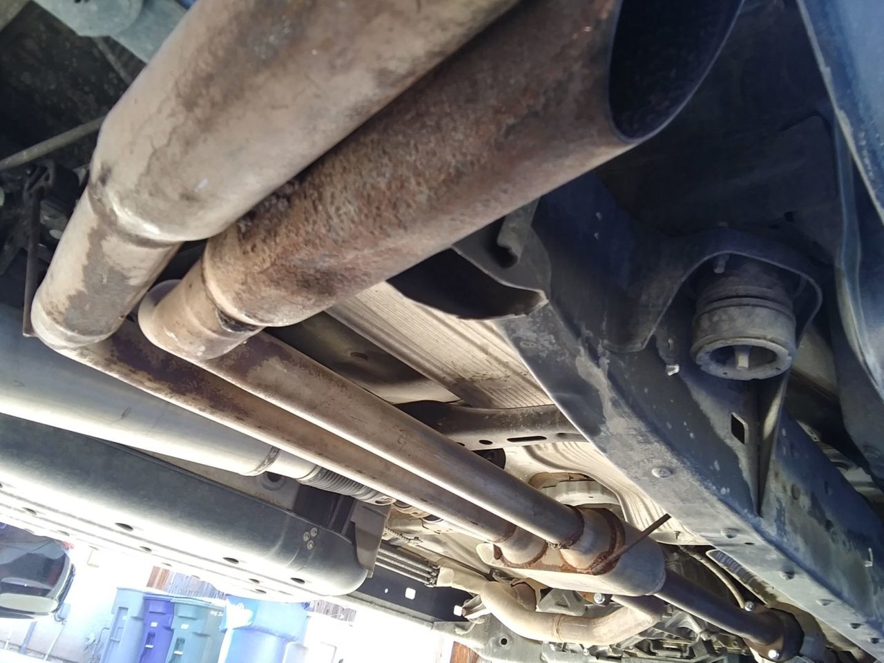

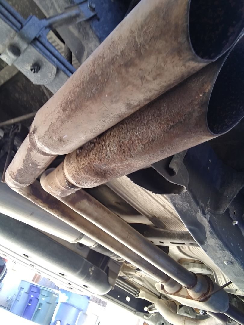

    Just do a drop in k&n filter because you don't want the intake to be sucking sandy air. I off road at the beach and Mountain where it's dry and somewhat sandy. Also sometimes I get a check engine light that comes on because of my intake sucking to much dust. Yes you feel a different than just adding a drop in filter but because your state and my state are almost alike because of dry area, having one helps more than just a drop in.
    Exhausted this is what I'm currently running but I'm soon going to put a bigger muffler that is a 3 chamber because right now it's a 1 chamber and it's a bit loud for my hearing. 20191122_113956_HDR_zpsxvycym98_5ab7f33bcca001a3ae46409d3024ba13b732b14f.jpg

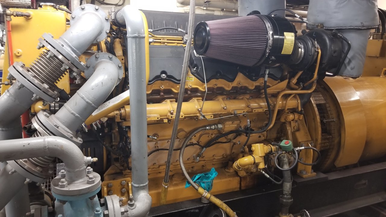

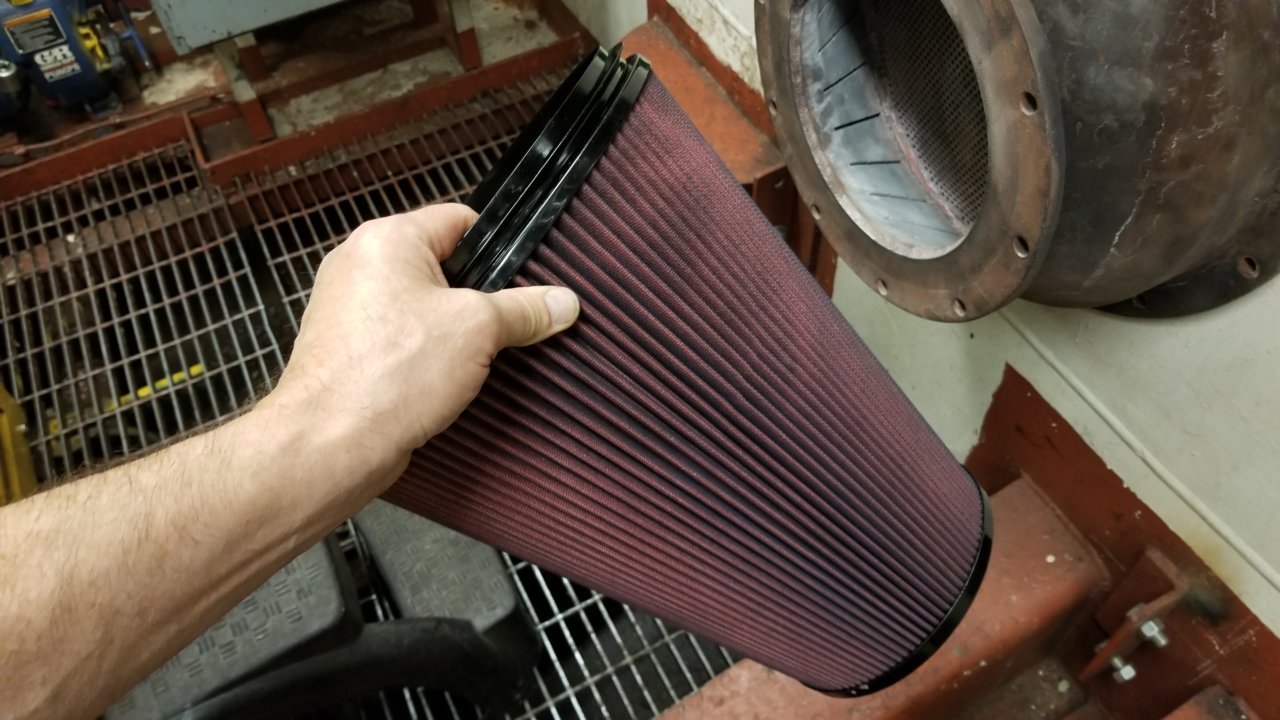

    If your in extremely dusty conditions I would stay with a good paper drop in, washable K+Ns do let more air in but you will also let more contaminants in also. We used to use paper filters on our older 399 cats that worked great for fine taconite dust. Now on our new eco safe C32 cats the K+N filters are not great at filtering fine particles (pluged aftercoolers, dirty turbos) .
