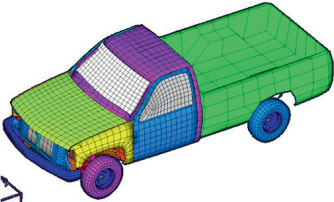

    What are you going to do once you know the material? You going to whip together a FEM model of the bed and input the modulus of elasticity, yield and ultimate strengths for the materials and make a pretty rainbow picture of the bed deforming under your load conditions???? Thus what loads are you trying resist here bud? What are you going to do with the material information once you know what it is?
    Put a hole in the bed and put something behind it to spread out the load like a plate washer and guess you'll just have to see if it holds. If your going to rely on the bed for say a lag bolt or self tapper to not rip out then thats probably not going to hold for long. Then again that probably depends if you're trying to secure a fleshlight or a 100lb floor jack to the side of the bed. You work in aerospace throw some ideas out there for different types of composite resin material...
    What "fasteners" does your Aerospace brain have floating around that you think would work for a composite bed?
