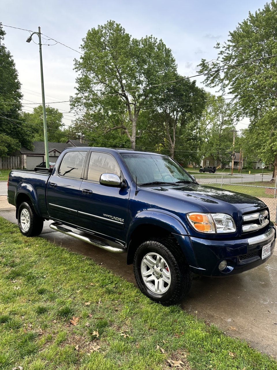

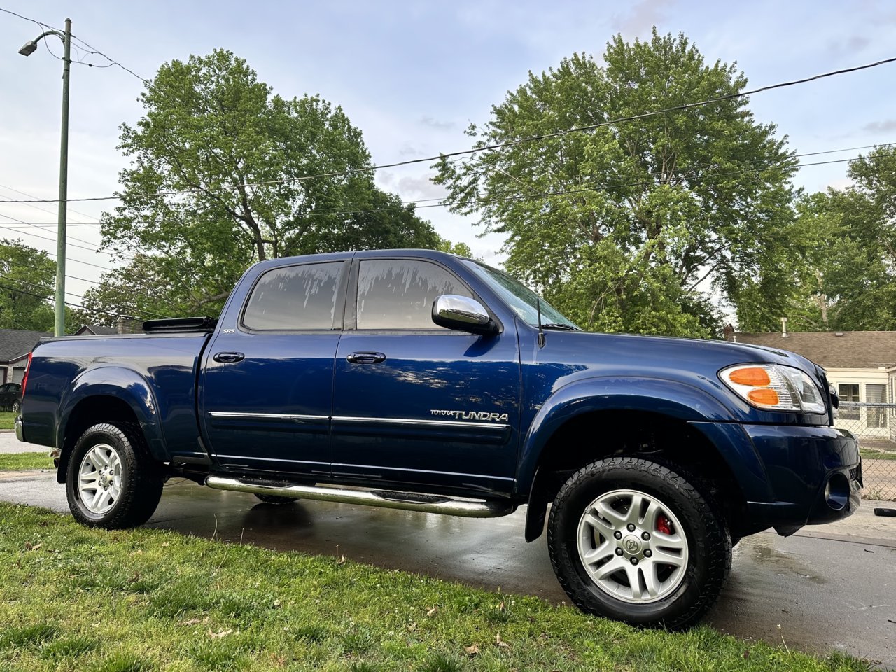

    My spreadsheet says I’ve spent approximately $3600.00 in parts, including an alignment. The alignment was so bad after I finished my work that the alignment shop had to hold back laughter reading me the results. Here’s big blue now after a wash:

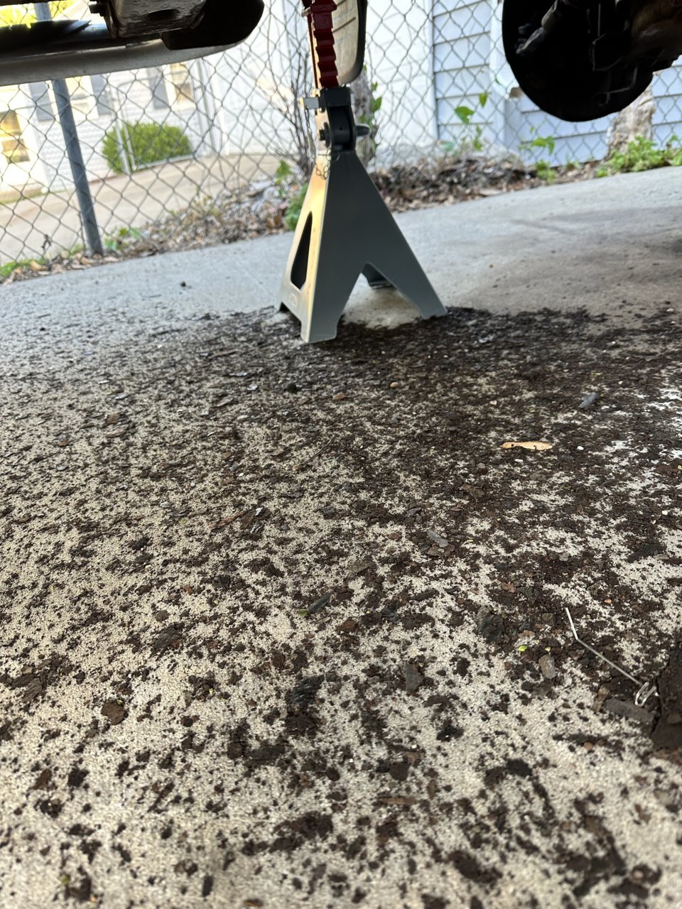

    Ironically, while this post was originally about rust, that has ended up being the least of my concerns. Having spent so much time on the truck now, I feel like it’s a miracle it even drove before. So many of the old parts I took out were just completely shot. But that being said, the rust is still something I’ll be working on. I’ve got a needle scaler and it’s been working great for getting the surface rust off:
    So yes, I still need to address the rust, but it seems easy in comparison to what I’ve already done. It’s just time consuming and will probably be uncomfortable as it gets hotter.

    A die grinder and wire wheel will get rid of the fine rust particles unlike a needle scaler. A $40 investment if you have a decent compressor.

    Yeah, I should have just got that when you told me the first time :facepalm:I got a compressor for this project so I'll go ahead and pick up a die grinder as well

    The fan wire wheel works better than the cup type. I got mine at home depot, but now they only seem to have the cup type to buy online. (wear goggles, those wires tend to fly off occasionally) Only downside was I borrowed a craftsman 30 gal air compressor that had like 4 scfm which wasn't enough air volume to run full blast with the die grinder so I had to wait a minute or two until the tank filled to run at full speed for the tough areas. Otherwise it'd run at 1/2-3/4 speed with the current air compressor motor which was okay for most of the stuff but full blast would definitely eliminate all the rust with minimal grinding of any good metal.

    Yeah for me, that rust wasn’t horrible, but my context is NE trucks. As far as money spent, your cost with the original purchase price is still below this crazy COVID market value. And you’ve got a bunch of new stuff on her. I’d say you made a smart choice if you’re not regretting the time you’ve spent. Kudos to you. It’s a good looking truck now.

    Who did the paint??
