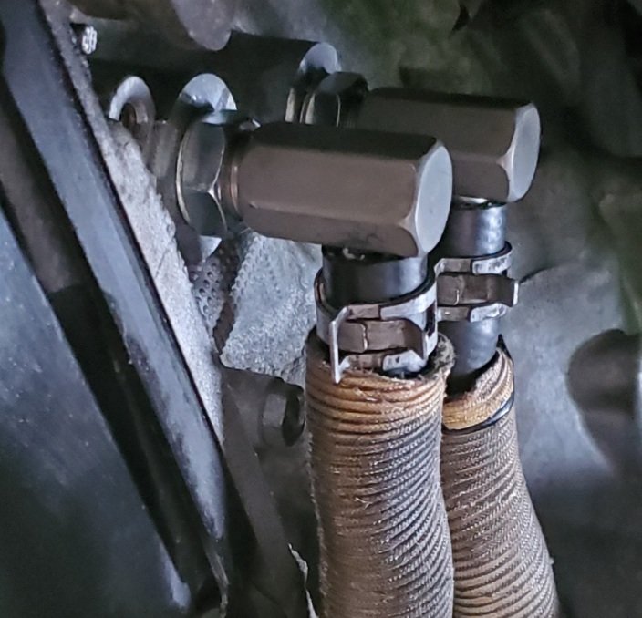

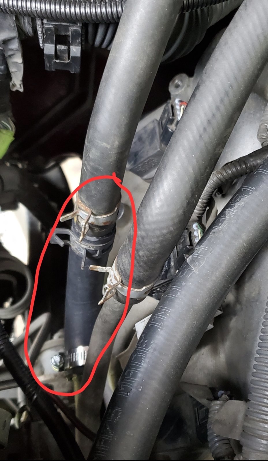

    I grabbed the part numbers from John's video and talked to him about cooling the transmission.

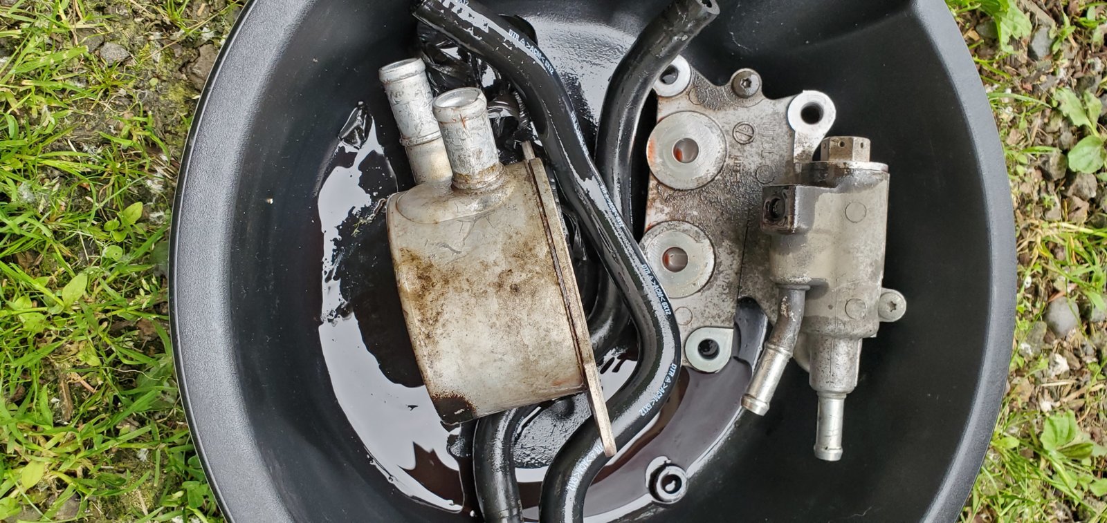

    I removed my warming/cooling puck and thermostat completely in May. Installed the elbows that go straight to the cooler.

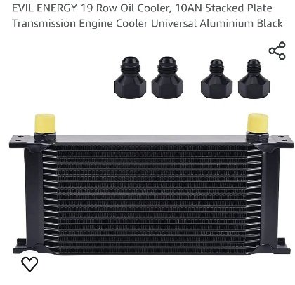

    I was thinking those without a cooler could plumb the outlet from the radiator to an external cooler and treturn to transmission. You could use a inline barbed thermostat like the 145 deg one mentioned on some Gen 3 threads. A lot cheaper than some other systems out there. Using a 19 row cooler, thermostat and elbows is under $400 for those that don't have a remote cooler. There are a few options to cool the transmission.
    20240525_182520.jpg 20240525_182639.jpg Screenshot_20240811_225352.jpg Screenshot_20240811_225943.jpg

    Is this as easy as buying the fittings, unbolting the puck, connecting the trans lines to the fittings, and looping the coolant lines to themselves?

    Yes it is.
    I did remove the coolant hard lines and just connected them at the heater outlet from the cowl.
    In 50 deg temp it takes me about 15-20 minutes to get up to 150 deg atf. The puck does help get up to temperature quicker and does provide some cooling if you got over 190 deg atf from the torque converter.

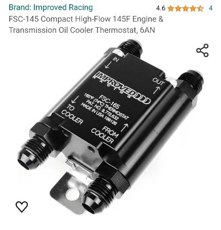

    Sweet. I was actually cruising around Improved Racing's site the other day. I wasn't sure they were legit. But 145* thermostat sounds perfect; full open at 163*. Sounds much better for my application than pinning it open (except maybe in the summer time).
    Anybody happen to know the pump flow rate for our transmissions? The compact thermostat is rated for up to 5GPM; the full-size version is rated for up to 20 GPM. I seem to recall somebody like @Jowett talking about the pump flow rate but can't remember where/when.

    I just grabbed a pic of the 145 deg one from Amazon. The 165 deg one will get the fluid closer to 180-190 deg for the WS fluid especially with your cold winters. I didnt see too much info on exact pump flow.
    Does the Sequoia have the warming puck? I got my thermostat that I'd let go.
