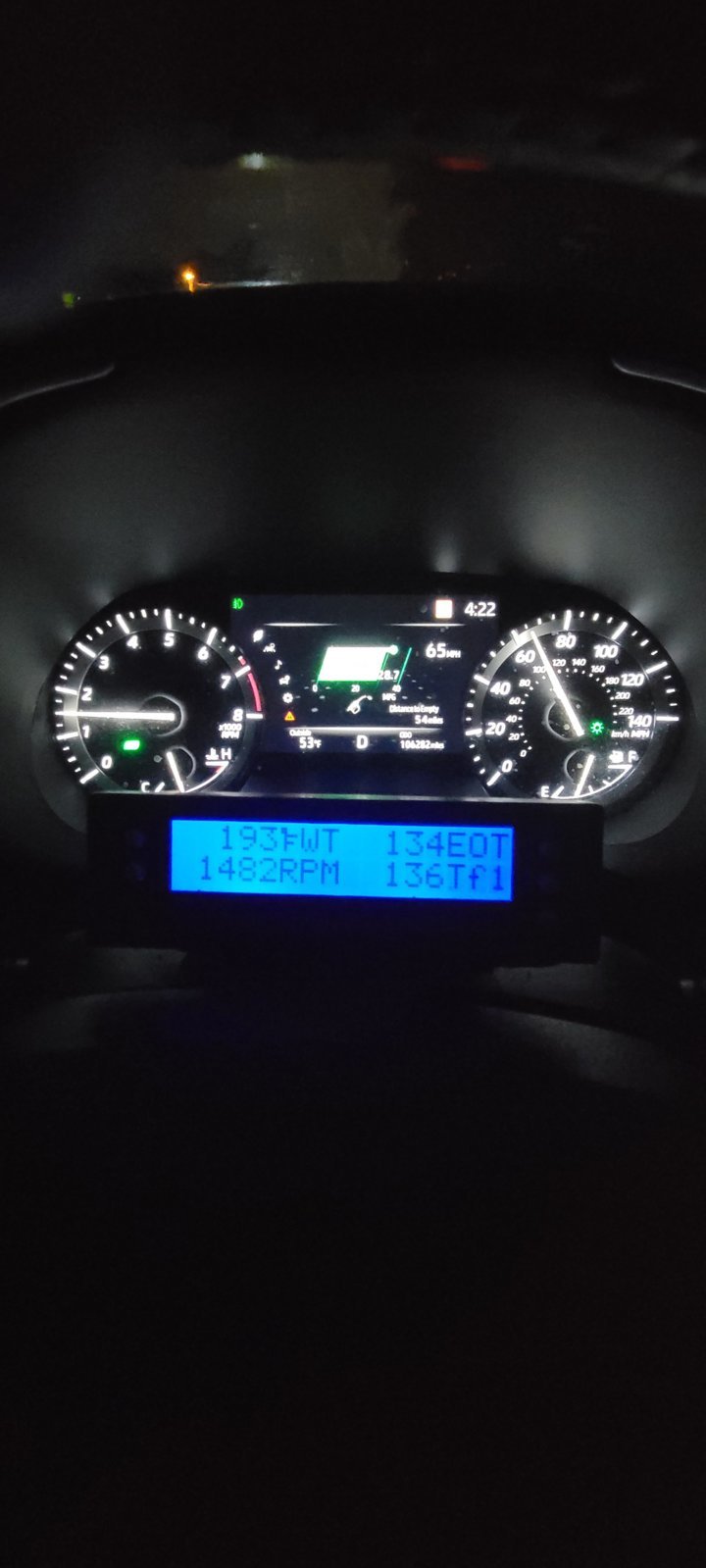

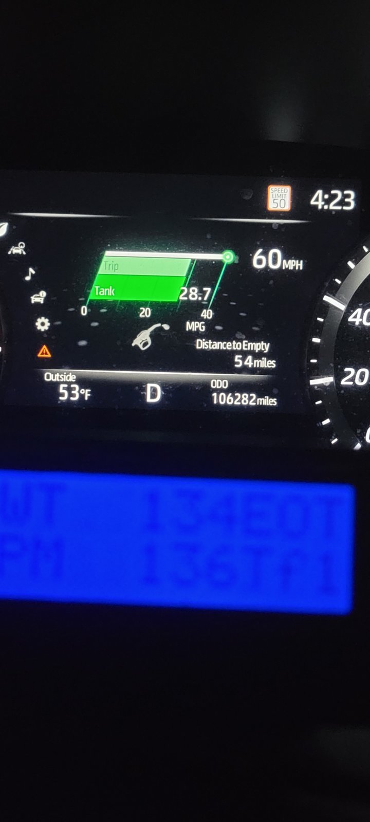

    I know this post is over a year old and I also don't contribute very much but I do have a lot of information on different toyotas and their transmissions. Currently we have a 2021 highlander with 105k miles pinned the thermostat day I bought it new. 2020 tundra that didn't come with a auxiliary cooler so I bought all the factory parts installed myself and pinned the stat open at 5k miles truck now has over 50k. Wife drives a 2019 4runner that did not come with a auxiliary cooler so I added a 30k btu b and m cooler In line with the factory radiator cooler. Finally we have a 2019 tacoma trans has been pinned since we bought it new and it has just over 60k miles on it now. All vehicles are driven 65 miles each way back and forth to work all highway winter trans temp doesn't exceed 140 degrees and summer temps rarely get above 170. I service all transmissions with idemitsu or Asian ws fluid every 15k miles. People tell me it's a waste of money to do the drain fill at that interval but I have 0 transmission issues. The temperature is measured with scan gauges in all vehicles and I just put back the same amount of fluid that comes out.
  16. Apr 25, 2024 at 1:24 AM
    #46
    stazz22
    stazz22 New Member
    Jul 7, 2020
    #48954
    7
    Delaware
    2020 tundra
    Outlaw exhaust, cai, scangauge, tint, nerf bars, soon to be trans cooler.
    Just drove 65 miles from harrington de to wilmington de for work outside temperature is 53 degrees.
    Silver17[OP] likes this.

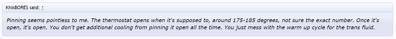

    And they removed it to save money not because the transmission doesn't need it. The pictures I sent are from my 2021 Highlander 3.5l 106k miles transmission pinned since day 1 no problems and I get 2 mpg more than epa highway rating in cold weather and 4 mpg more when outside temperatures are above 70 degrees.
    Mdl and nobodyintexas like this.

    SW UT
    300k+ Supercharged 2008
