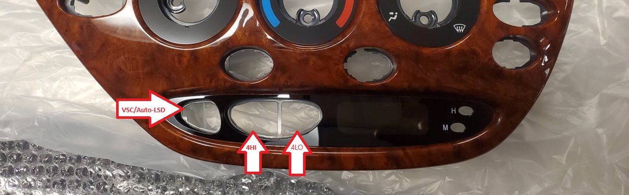

    Note the part ending in "350" here: https://www.tundras.com/threads/wha...t-gen-tundra-today.2558/page-702#post-1851043
    That's the woodgrain dash bezel with 3 buttons. Roman sent me a picture of it ... let me dig back thru PMs and I'll eidt this with the pic.
    Here you go, this is VSC/Auto-LSD equipped trucks part number 84013-0C350, you may need to remove the hyphen in the part number under the new system. Note the main difference: There's an added opening for Auto-LSD (VSC) button to the left of the 4HI/LO buttons just left of the clock, which is distinctly different from the non-VSC part number (84013-0C310, pic):

    I'm confused by the bold text I'm quoting here. I just posted a picture of the dash bezel. That's what Roman received from Toyota when he ordered the part ending in "0c350". Note it has 3 openings.

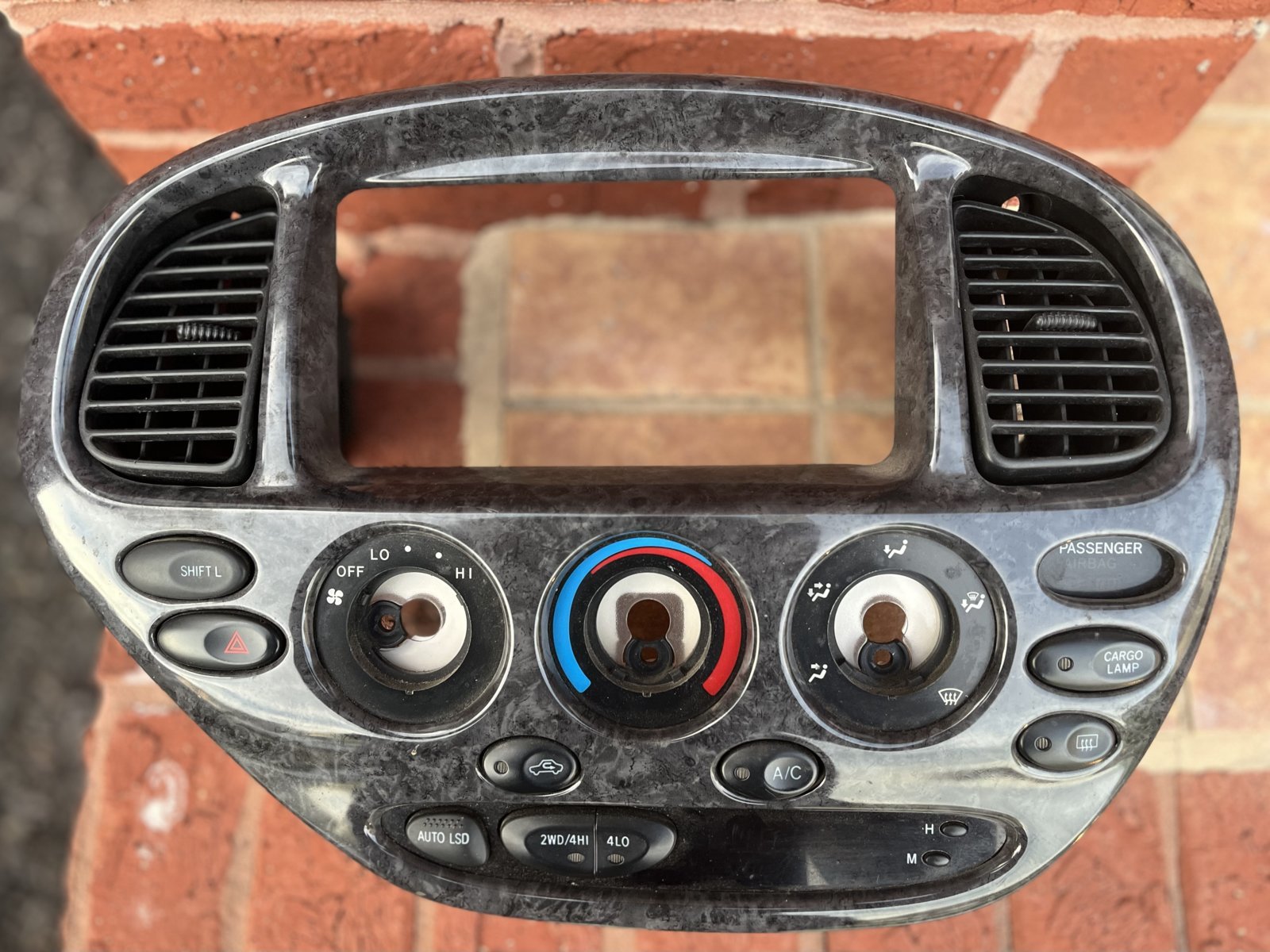

    I bought a rare black/gray burlwood bezel and it has 4wd/Auto LSD buttons. Tested it out and everything that is on my stick bezel works and of course 4wd/Auto LSD don’t because of the obvious. Has anyone ever had electronic issues using a bezel that has buttons that wouldn’t work anyway?

    Post a picture! I will trade you an all black lsd 4hi/4lo one for it haha.

    I’ll post it when I get off work. Apparently it’s a super rare bird now that is has the Auto LSD button. I can’t do much with your offer tho. My stock is black, in great shape and is for a 2WD vehicle. I’d pretty much be by stock bezel with extra buttons at that point LOL

    Here you go. Like I said, talking with you fellas it seems like this is quite the rare birdIMG_5042.jpg

    84010-0C781-00
    I tried too but couldn’t find anything. It’s like they either made this bezel only or they made so little of this interior kit that it’s just rare AF.
    I’m not sure if it was a T3 only thing. If I recall correct, T3 was 2WD only. My bezel to install has 4WD buttons on it.
    I plan to install this bezel with the wood grain pieces I have. It sounds funky but it actually looks good. To me anyway. I refuse to gut again like you said. It was expensive to find these pieces in their condition
    From what I could find in deep research, this was optional like the wood grain but it never showed pictures of anything but the bezel. I’m starting to think it was bezel only in a black and gray interior, like my truck. That is, unless you have sourced the other parts

    I think the part number you pulled may actually be for the components attached to the bezel. The bezel itself is sold with just the face, not populated with buttons and circuit boards. That part number comes back to the components that get attached to the back of the panel.

    I’ve never been so interested in black wood before……
    That really does look great. It has me thinking I should keep all my black trim and just try to find a center piece just like that? But the original wood will look perfect with all my Christmas lights on the dash.

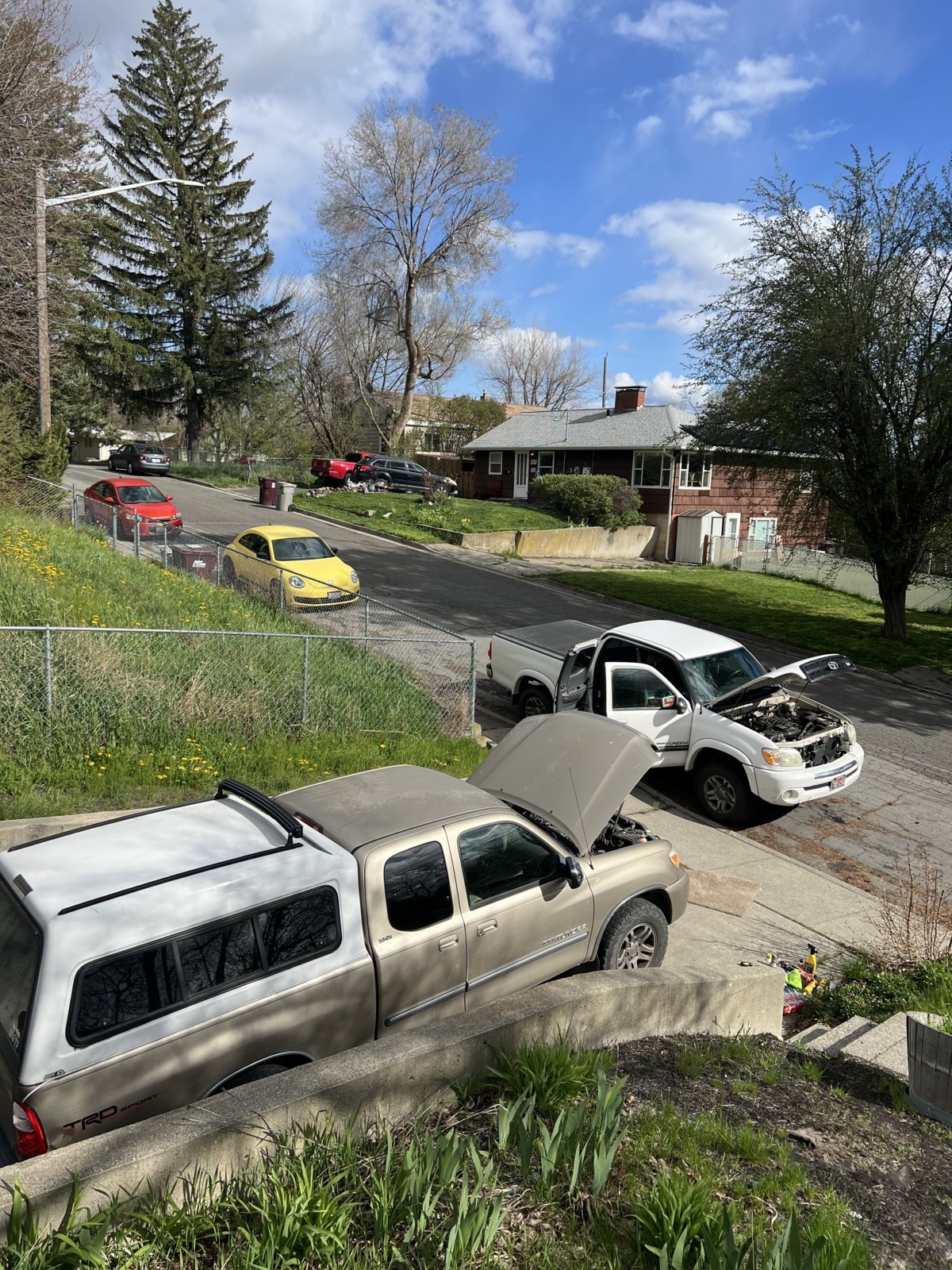

    If nobody minds, can I share my trucks issues in this thread? Maybe someone else will have similar problems.
    I pulled the codes, all 5 ABS related.
    C0205(Front Speed Sensor LH Circuit)
    C0210(Rear Speed Sensor RH Circuit)
    C0215(Rear Speed Sensor LH Circuit)
    C1223(ABS Control System Malfunction)
    C1290(Abnormal Zero Point Of Steering Angle Sensor)
    had a fun day comparing engines side by side to see what’s different and what’s broken haha. IMG_2118.jpg

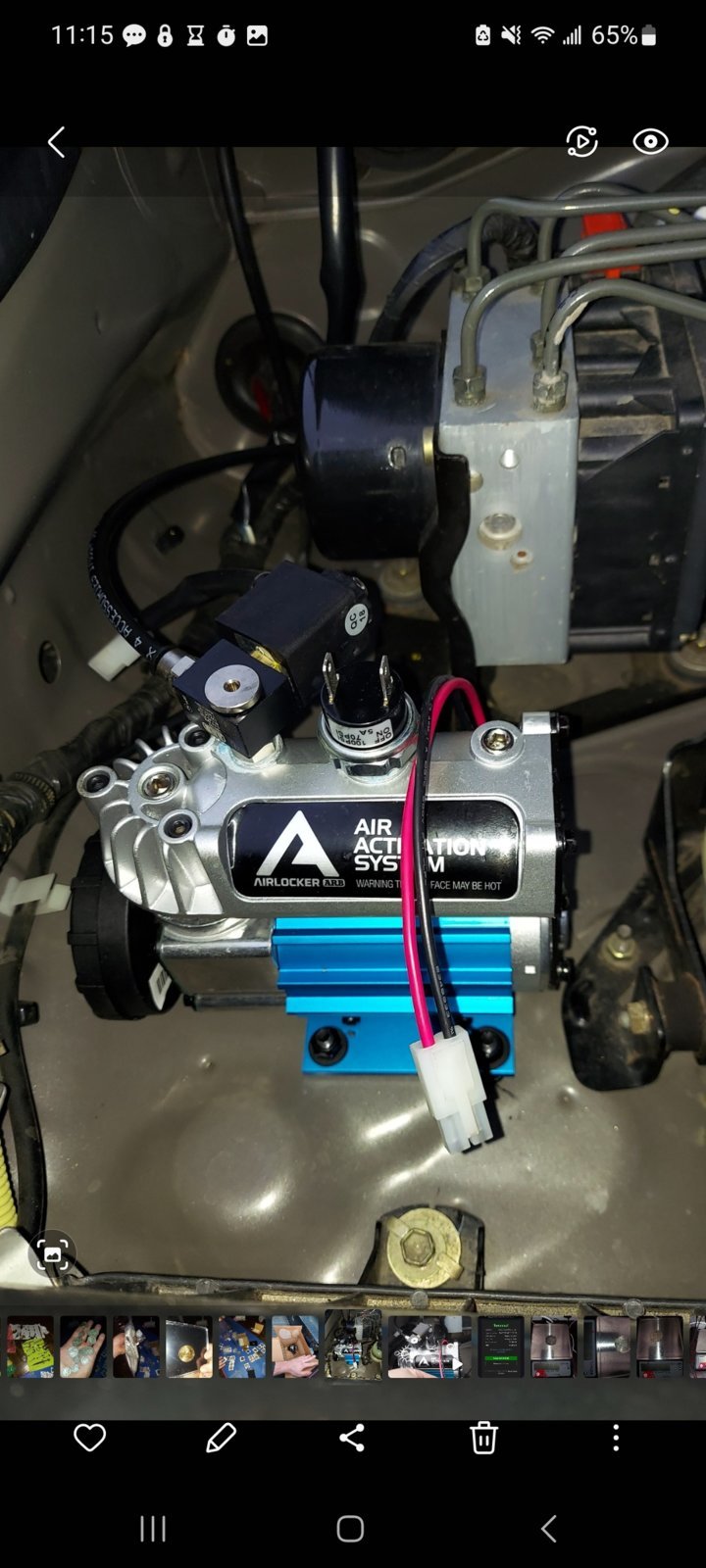

    That said- I just put an air compressor in that spot in my truck. Fits perfect. Check out page 12 of the thread in my signature.

    Yup, all ABS. But I don't see ABS squid in any of the pics you posted. The hell?
    Anyway, check fuse(s) related to ABS first and foremost. And make sure the sensors are still attached, all wiring is plugged in. Seriously doubt three would be bad at the same time. Maybe someone disco'd stuff because ABS was locking up. Others have complained of same.
