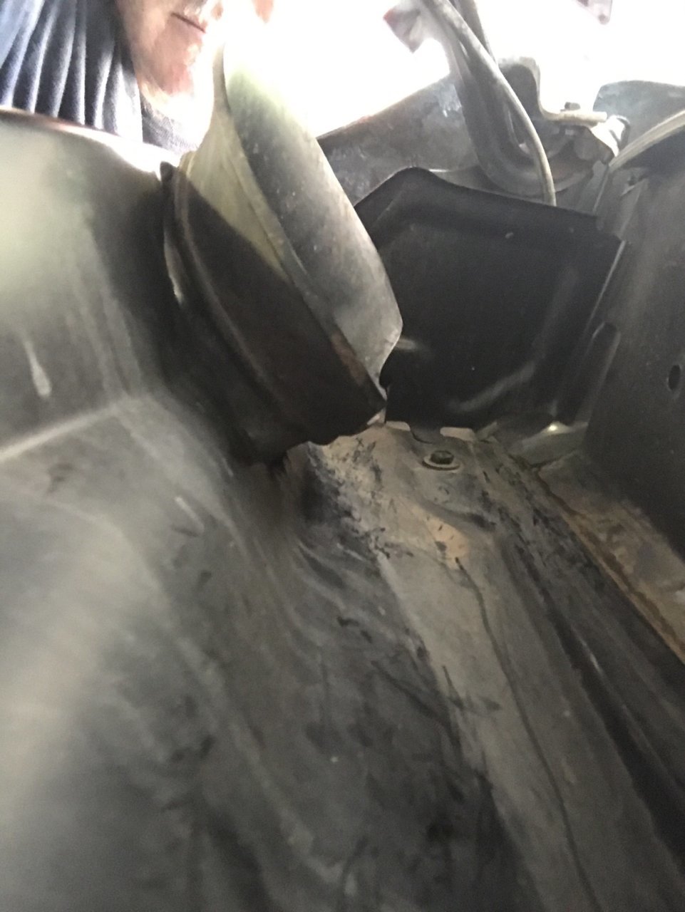

    My two cents on this is that if you have cut the inner fender liner at all and the "nozzle"/ intake to your air box is exposed then yeah maybe its worth it. I can't get a pic of it on my truck but I had to cut my inner fender wells to fit my bumper and the intake to the box is exposed. thankfully haven't had any problems so far but I've found the bottom of it covered in water after driving through a hard storm. thankfully there is a drain hole and I do have a bigger oval/conical filter upgrade so during my 10 day camping trip I only had to clean the filter once even though we would drive on dirt roads at least once a day since we were shuttling our mountain bikes. and normally it would be all day or at least half. Like I said in my post above I am looking into a solution but it's not something i can work on these days. too busy.

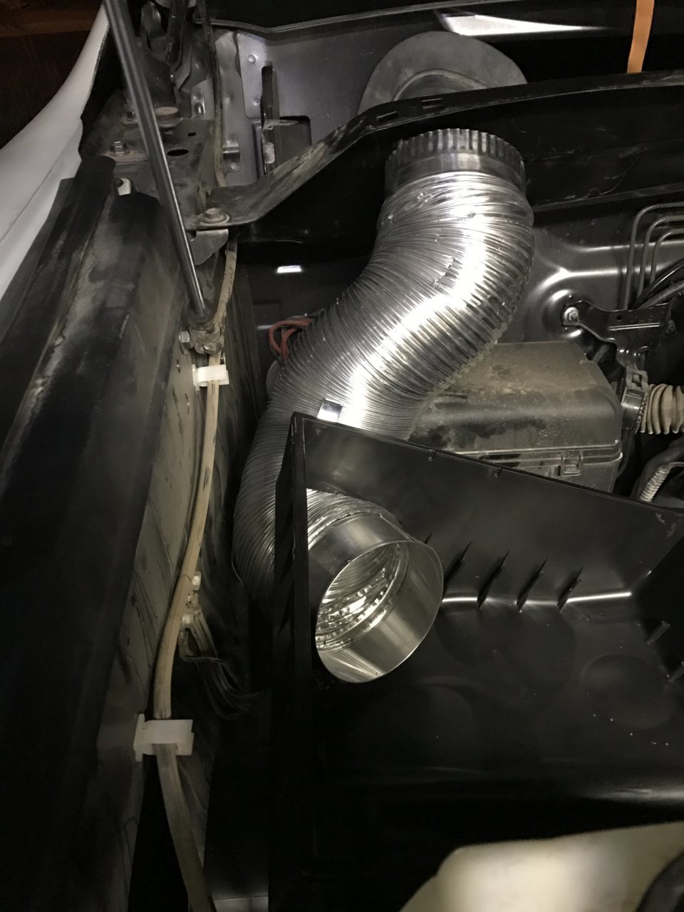

    yeah once you open the cowl you’ll see how the air and water flow. Did you see the Instagram video I posted above? I put the hole at the same height as the one Toyota made for the cabin air. Water drains out to the sides so even if parked facing uphill, rainwater would spill out to the sides instead of into the cab. I used the TRD intake horn shoved through the hole I made so that water couldn’t get up into the airflow. Here’s a pic from inside the cowl that shows the path water would take is about an inch or two below where the air flows. To the right is the intake you’re talking about that lets outside air into the cab through the vent system (especially when the foam is blown out :rofl::facepalm:).
    I did consider plumbing all the way through to the cab for air from inside, but it would have been crazy loud and this is still my wife’s daily driver. Taking air from behind the engine isn’t a bad idea at all.

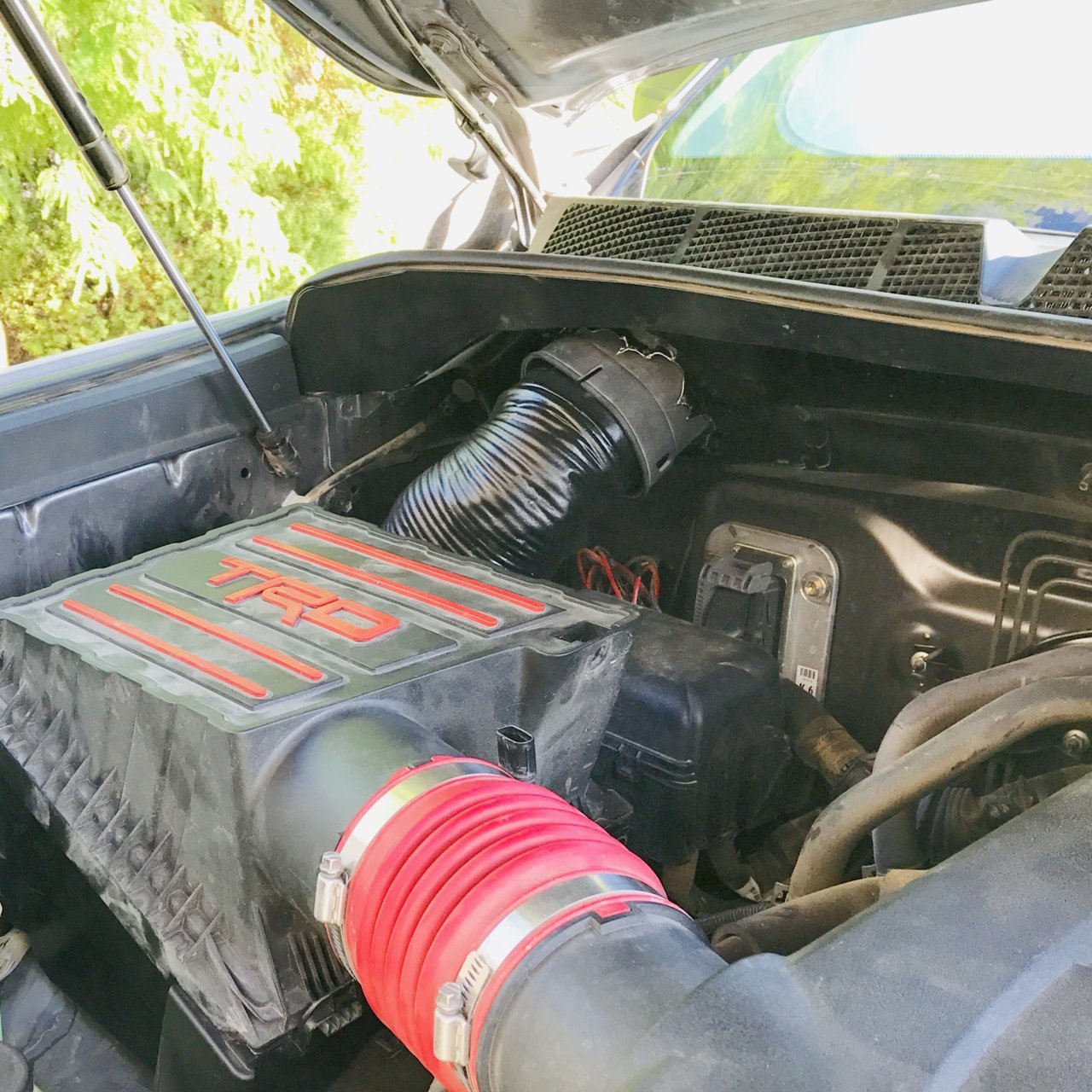

    Looks good. I did watch some of the video yes. I figured that area was dead air, and not positive pressure (or whatever the terminology would be) like the video shows. Are you using the rest of the TRD intake? I used the factory intake, but IIRC there was only enough room to come out of the side of the airbox where the factory intake horn is. The TRD airbox is much larger you must have put a new tube out the back of it.

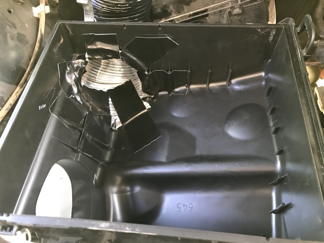

    KevinK
    KevinK SGU - High Speed Overlander
    Nov 8, 2016
    #5141
    2,014
    Back in Arizona. Again.
    SGU - Speed Glampers Uberfahrt
    Tundras to Sedona

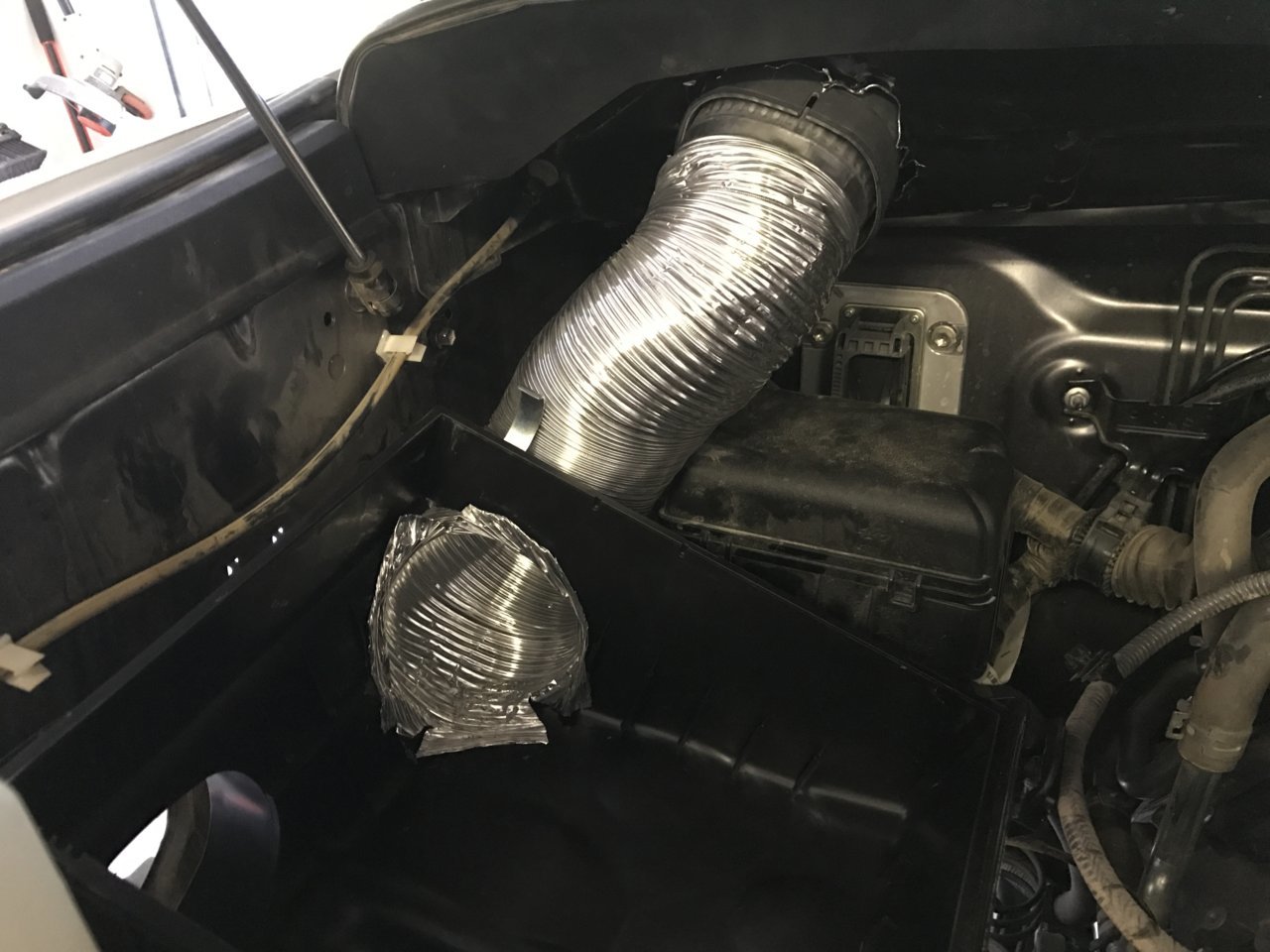

    yeah I used the TRD air box, but on the 2014+ only the top half of the clamshell is bigger, and you have to pipe the air into the bottom half. I cut into the corner and jammed a dryer vent into it for testing to see if it would work. :rofl:
    Then cut the hole and plumbed everything through.
    Tested it for water tightness with the two five gallon buckets of water dumped on the windshield at the same time (should have seen that clusterfuck of my wife and I balancing on ladders and trying not to fall).
    Then I shot it with some Flexseal like a real professional and called it good.
    I taped over the stock inlet with gorilla tape and ran it like that for maybe ten thousand miles. About 3,000 of that was off road. Worked like a charm.
    Until.
    When I made my cut into the lower air box, I cut part of the support leg that attaches the box to the fender. That weakened the leg which eventually broke and let the air box flop while we were bouncing around off road.
    When my buddy popped the hood to look at my invention, the said it looked like a Jiffy Pop had exploded. There was tinfoil in shreds everywhere. :bananadead:
    So I have a replacement lower box now and need to just get some silicone elbows and couplers to make it permanent.
