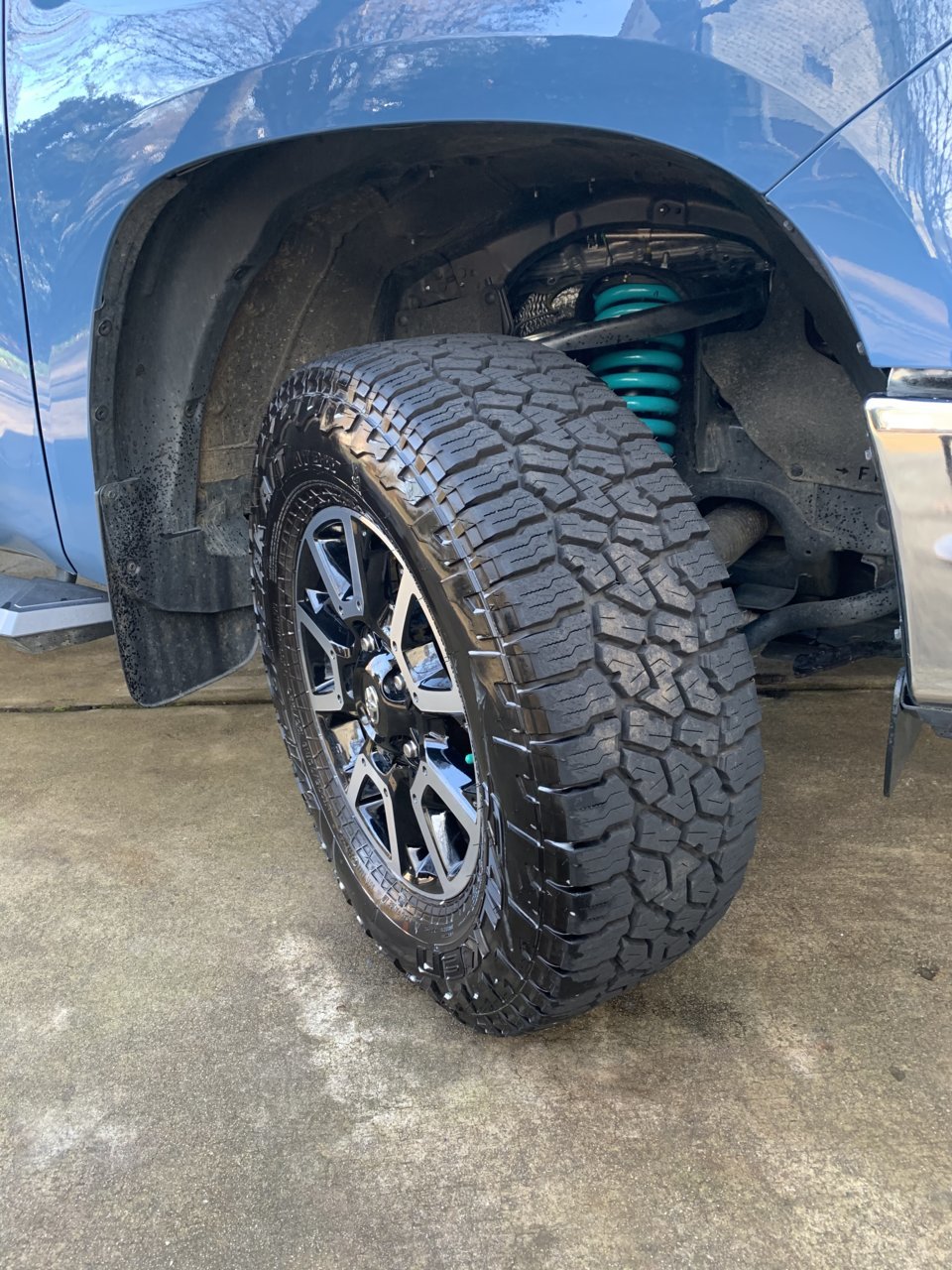

    I’m getting a 35x11.5 or 285/75r18 set installed tomorrow with full-size spare. I’ll update here. Upsizing from 275/70r18 or 33x11. i have a 2+” front and 1”rear. I already deleted the front spats and rubber malleted the skid. Hoping for the best/ preparing for the worst. I am all-in on some more ground clearance and back country insurance, so I’ll do whatever to get it to fit, including the spare at this point. Where I am now...
    Pic depicting need for more “meat” ...
    Also adding spidertrax spacers on stock wheels to hopefully meet the wheel wells and provide better fitment.

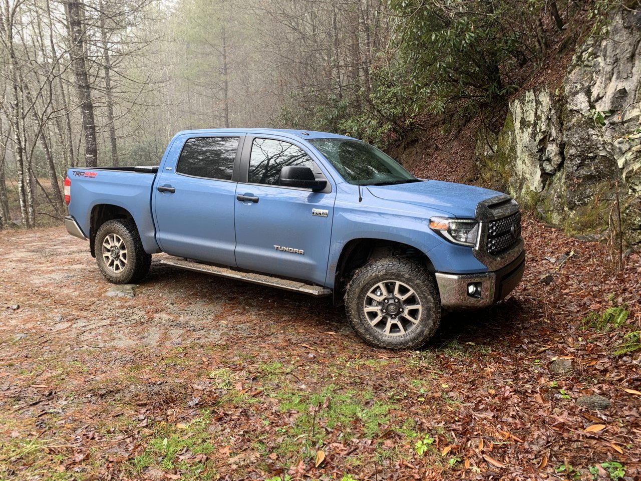

    So the fit was a no go with the 1.25” spacers but 285/75r18 fit without them. 1/2” UCA clearance and tight on front fender liner and mud guard. Things that are easily modified. The spacer made it rub metal in the front and rear. E5F1A3B9-116C-4FBC-ABF1-2D7E5B84723F.jpg

    Rubbing both the cab mount and hard into the bumper liner with the spacers it cleared fine without them.

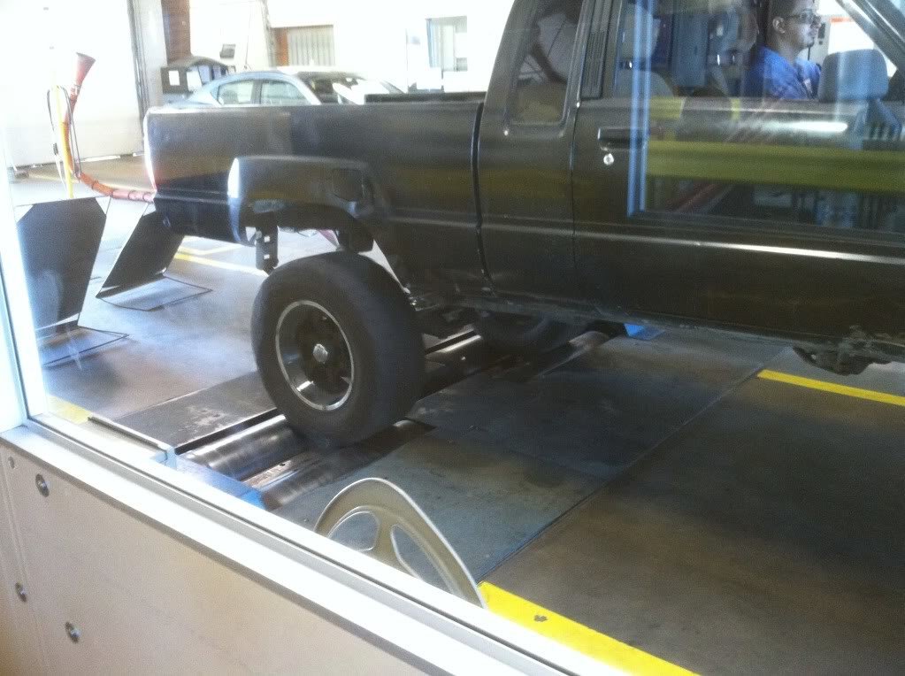

    Most newer vehicles don’t go on the dyno, they just hook up to the OBDII and do visual check.
    most locations don’t have rollers set right for 35s there are some locations that do.
