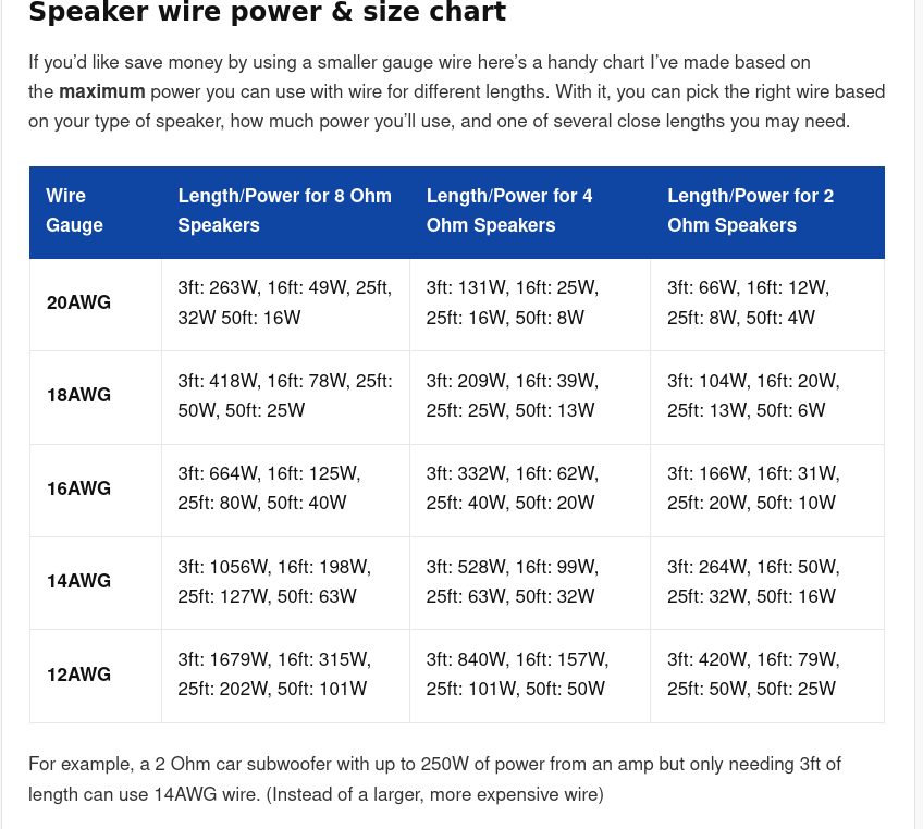

    Length of run has a lot to do with determining guage. I use this chart. It can be found here.

    I don't think this chart is accurate enough because music is dynamic. There are so many variables.

    That was the reason why I posted the chart. With your first reply you disregarded all those varibles, and just gave your opinion. Albeit your opinion may work, but is it the optimum result? One will never know if at least some of the variables are considered.

    You're right. The chart does state the he or she is utilizing maximum wattage output. ​

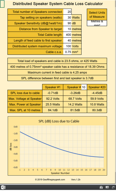

    I have gone overkill on all of my wiring for my audio build because I do not want wire size to compromise sq. If I want to utilize maximum wattage I ll know the wiring will handle it. Ive not really studied the nuances of getting exact specs. Here is an interesting site that has an actual calculator one can input several variables and get a result. It shows a few of those variables that need to be considered.
