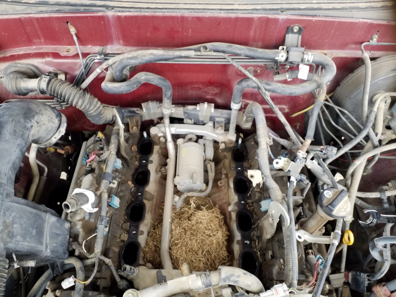

    looks loke quite a bit of rodent gnawls all over the hoses and wires.

    They did. They chewed one of the wires to the coil, and the knock sensor harness.

    Reminds me, I need to reread those rodent prevention threads...

    Yur vaper canister hose the ushaped one is missing.

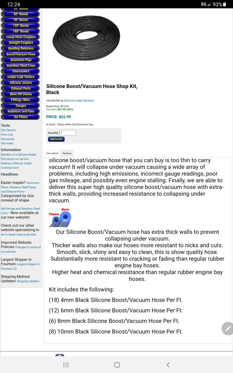

    Oh yeah!! This hose kit is exactly what I've been looking for to replace old hoses on my evap system and hopefully turn off the money light for a while.
    PS good luck with the rodent nest

    Yikes. Cover those intake holes and start shop vaccing that mess.

    It's been dealt with. That was 3 years ago. I plugged the holes and vacuumed it all out good and replaced the knock sensor harness.

    Oh yes he did. Stuffed every last one. Then sucked it out. :dancingbacon::broccoli::bananadance::bananadead::kona::jellydance::taco:
