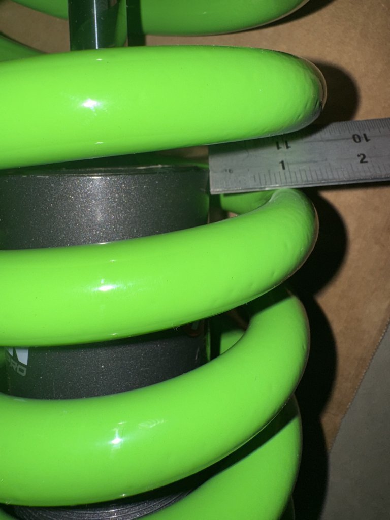

    Hi.
    First time here
    Today I unpacked my stage 2 kit for my 18 tundra platinum in preparation for the install tomorrow
    The driver side coilover is heavily bent. I just chat with Justin at IM4x4 and in what I felt was a bit rude response he said that "bent is common and should not be a problem" even that it is heavily bent without weight. I assume it will get worse once installed
    Can't return it because the kit was forwarded to my country and returning it is too expensive. They know this (I asked for the kit to be double checked before shipping and explained why... Yeah, stupid decision), so they don't care about it. My only thing to do is to install it anyway (or loose my money) and let you all know the kind of company IM4x4 is
    I'll attach a couple of pics
    I'll keep you'll posted if anything else is wrong

    You mean the coil is bent. What does it look like at the top and bottom?

    2018 Toyota Tundra platinum
    Yeah, the coil is bent, on the driver side one. I guess because is the one with the higher preload. Maybe is easier to see in this photo

    Preload isn't causing that. The coil isn't centered at the bottom, making the situation worse. Isn't there something on the collar that centers the spring on the lower perch? Can't tell at the top.
    Is the top hat perpendicular to the shock on both of them? Or is the bent one tilted on top? When the shock is installed the top hat will not be able to tilt since it will be bolted to the frame... so it's possible it will correct enough when mounted.
    If you bought these with springs already installed, I'd only chance mounting them if IM will guarantee in writing that they'll pay for installation and removal if the spring ever touches the shock body.
