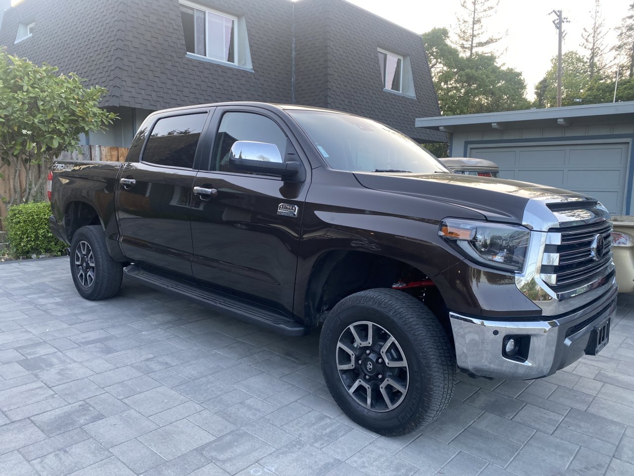

    Finally got the FCPs installed this past weekend. Went with the JBA UCAs.
    I finally found a wheel design I was sure about (Black Rhino Rapid in Bronze), but it's on national backorder so rather than going for the second choice, I decided to keep the stock ones for now.
    Ordered Spidertrax 1.25 inch spacers and Toyo Open County RT Trail tires in 285/75/18.

    How does it ride?

    Firmer than the stock Bilsteins, not boaty any more. Liking it thus far.
