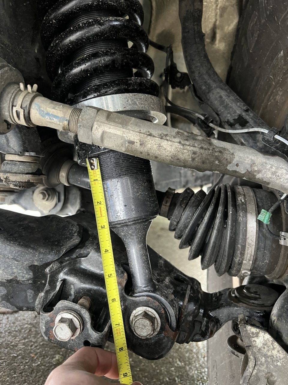

    Even with the IM tool I think it would be somewhere between very difficult and impossible to adjust the shock on the truck... so I'd definitely give it your best shot with the first try.
    If you want 2.5-3", I'd at least adjust the passenger side as low as possible, and the other side down to match.

    I was thinking the amount of pressure on the adjusters would be similar to being uninstalled on the truck if I removed the wheel and let them hang at full droop on a lift/jacks, but with the added benefit of being held in place on the truck to stabilize it while wrenching. There shouldn’t be any major additional tension at full droop right?

    The problem is having too much stuff in the way to use the tool. I couldn't do it on mine adjusted at 2" and these new ones are even lower on the shock when adjusted at 3.5". I'm not sure what you'd need to take loose, but something.

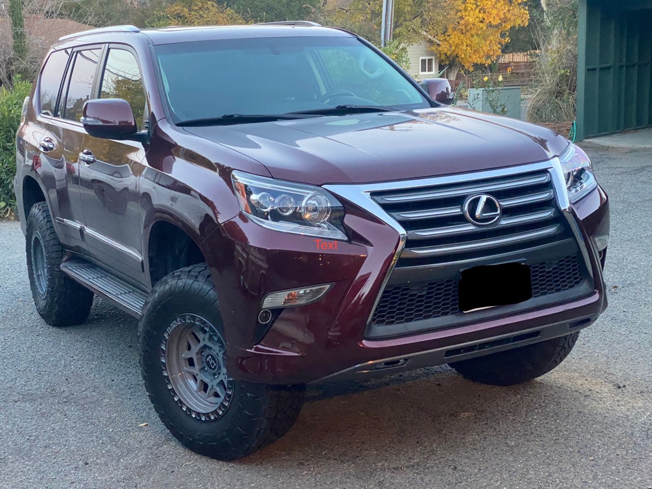

    I was wondering if anyone has some feedback on how this setup performs at fairly high speeds? Not planning on desert racing but let's say doing around 25 mph on washboards or bumpy desert trails. My build will primarily be catering to light off road action with occasional desert runs (Pismo/Oregon dunes) which may see some (medium) speed action. Out of that, the rig will be seeing pavement for 90% of the time. The price point for the complete FCP kit is unbeatable so I'm pretty sold on it. Just want to avoid buyers remorse later since I'm also looking at the Dobinsons IMS setup which I quite like in the GX.
    Cheers.

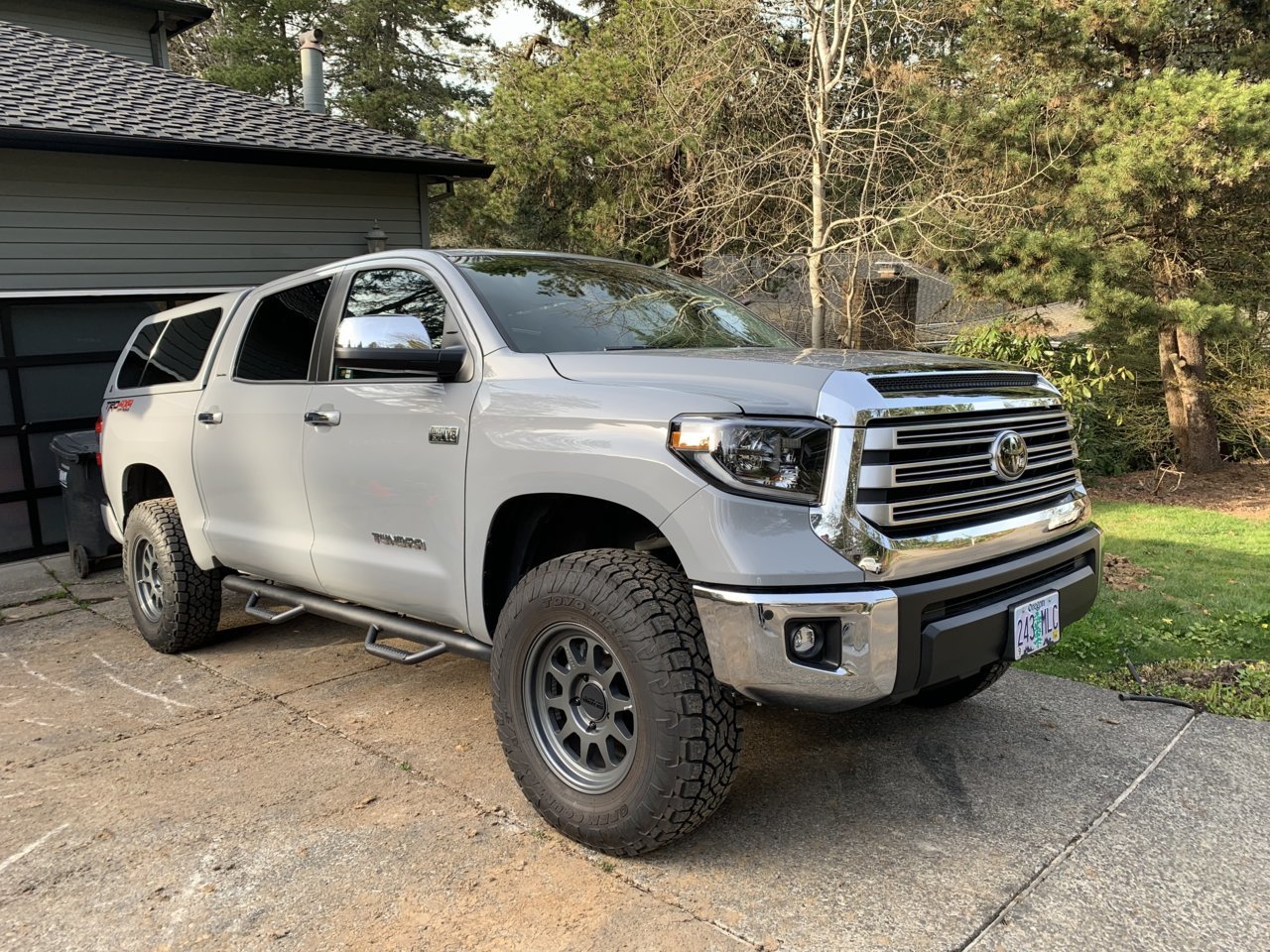

    True. Was just going through tire threads and I can see the stouter 35 like stance can definitely be achieved with the correct width and offset on 285s which is mainly what appeals to me. Pictured below for reference is member crewmaxlmt's truck. (Method wheels with same the same spec I mentioned earlier)
    And for perspective, below is member COTundra23's PRO with the same 285/75s on pro rims with a 1.25" spacer. The more I look at it, the more appealing it get's. I'm gonna look at spacers and probably should give this a go first since I can always get the Method's later on if I don't end up loving it.

    The 285s look good on 8" rims... :thumbsup: A 1.25" spacer will give you +28mm offset on stock rims.

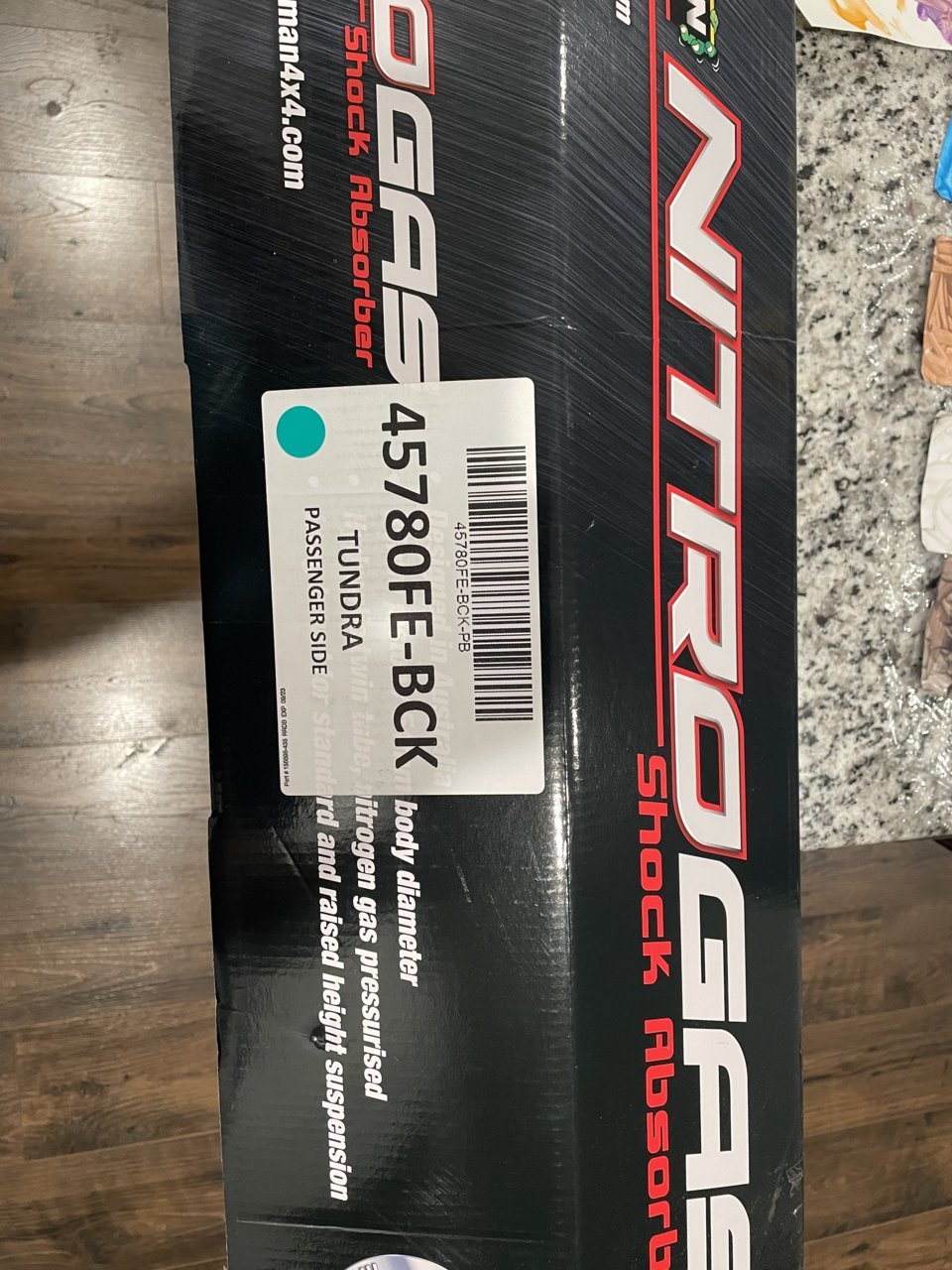

    Just got mine! I don’t remember them advertising these as Nitro filled on the previous model?
    TeaRD, Wallygator and rruff like this.

    They weren't... no pressure in the shocks at all. Are the back ones pressurized? You won't be able to tell in the front with the springs installed, but if the back ones want to be fully extended and are really hard to compress, then they are pressurized.

    The rears are not pressurized, I just noticed it on the front packaging, I wonder if that has anything to do with the improved ride?

    I think they just put them in the wrong box. Nitro Gas is one of their lines.

    "The Foam cell pro shock is filled with premium grade FUCHS oil and our foam cell sleeve technology. The foam cell sleeve, impregnated with millions of tiny bubbles of nitrogen, maximizes oil and thermal carrying capacity and eliminates high internal pressures found on regular nitro gas-shock absorbers."
    The foam is impregnated with nitrogen.

    after a second look, the box does not say foam cell pro, so you are probably right.

    True, I think they ran out of boxes for the FCPs. I ordered mine yesterday and they're already on their way. Let's see if I get the same boxes.
