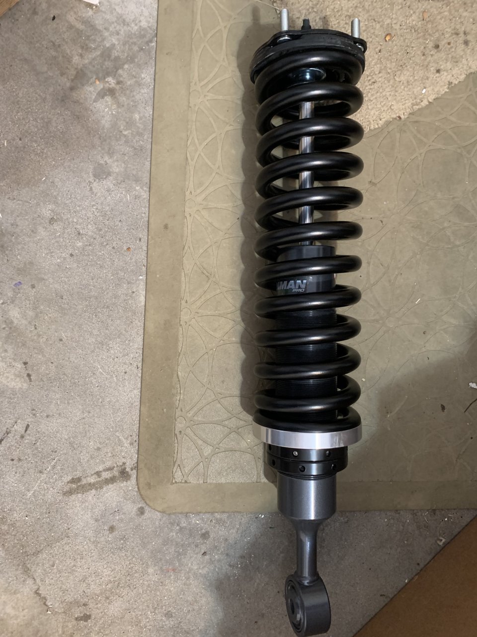

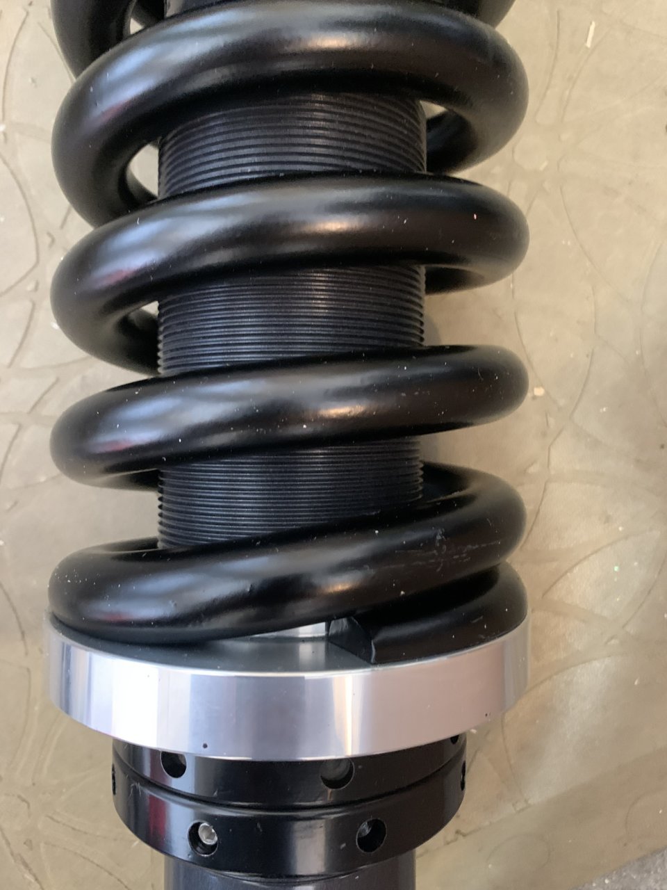

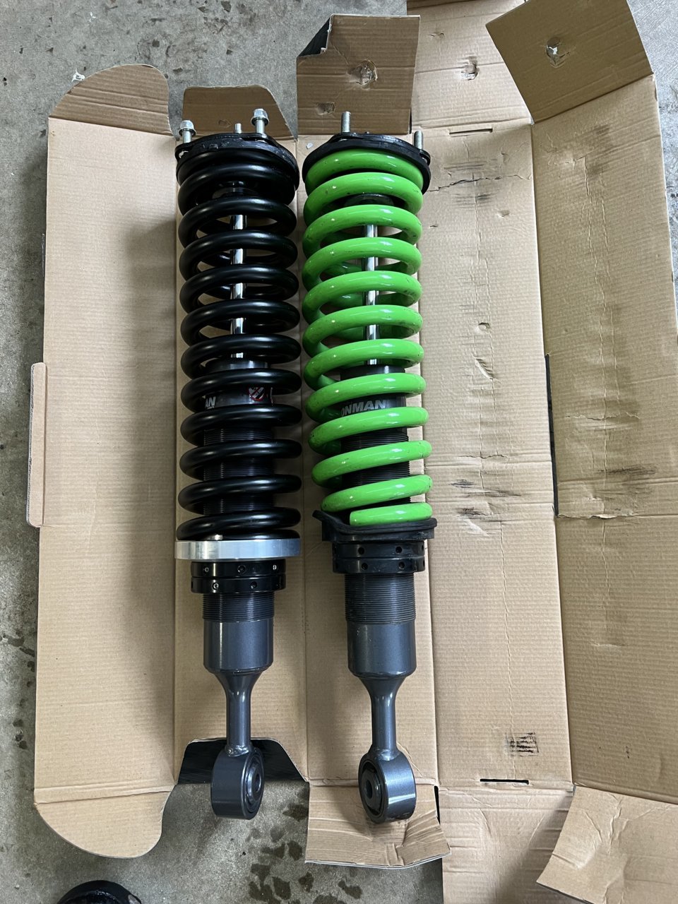

    Different coilover spring and lower spring seat. Haven’t really had time to look at them but I took a picture for y’all.

    I believe the original problem was the spring and shock were too thick and were not really compatible.

    No, the problem with the earlier version was that the perches and spring ends didn't result in perfectly linear support... so you would usually get a bow.
    Wow, thanks for posting, very interesting! Looks like the bottom perch (aluminum?) is totally flat now, and and the bottom of the spring is ground flat too. Is the top ground flat, or is it the same as before? Probably the same as before, as the isolator looks the same.
    Looks like the number of coils is the same.... can you measure the coil wire diameter with a caliper by any chance? It's likely the same too.
    Except... wow, there are hardly any threads left at the bottom of the collar, so you would not be able to go much lower. Do you know what lift these are for?

    Can you take a picture of the upper spring seat? curious if it's also ground flat like the lower

    That loooks like it may make noise….steel on aluminum?

    It's not unusual for shocks to have no isolator on the bottom and aluminum perches aren't weird either... so I wouldn't expect a problem.

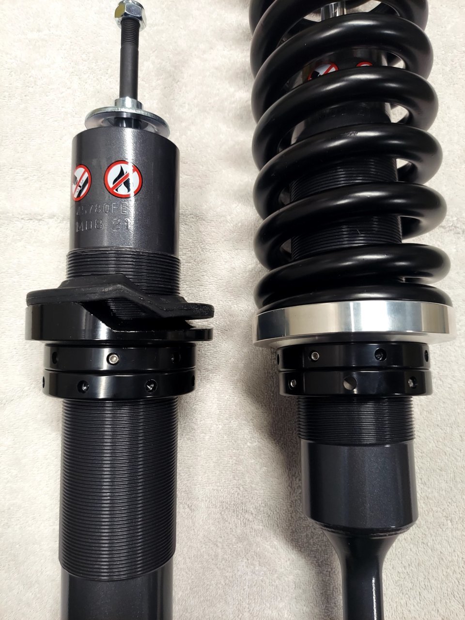

    I decided to go ahead and order the new updated FCP coilovers and just received them today. I will be returning the old unused ft FCP shocks and tops for a refund. Before I return the old shocks I decided to see the difference. I took a side by side comparison photo in case anyone was wondering. I hope to install the new kit soon. Went with the stage 2 kit in Med. Also just found that my steering rack bushings are shot and will be replacing them with ES bushings. I thought I was going crazy at first because my steering wheel wouldn't stay centered.20230301_180945.jpg

    I love how straight and centered those coils look...
    Are those regular or extra load coils? What lift are those set for? What is the length of the exposed threads at the bottom?

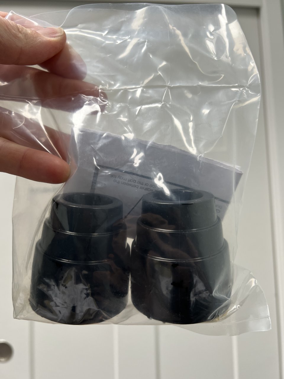

    Ready to swap some things out. 4E6ED6E4-EF3A-4091-989F-6D28EAE36CF4.jpgABB8E250-EDBD-46BD-92CC-B40E25DC2696.jpg EF9E2308-FA3C-41EA-BE4A-132732AA32CE.jpg

    Glad to see they got this sorted out.
    That new unit looks worlds better. The lower collar design looks much improved.

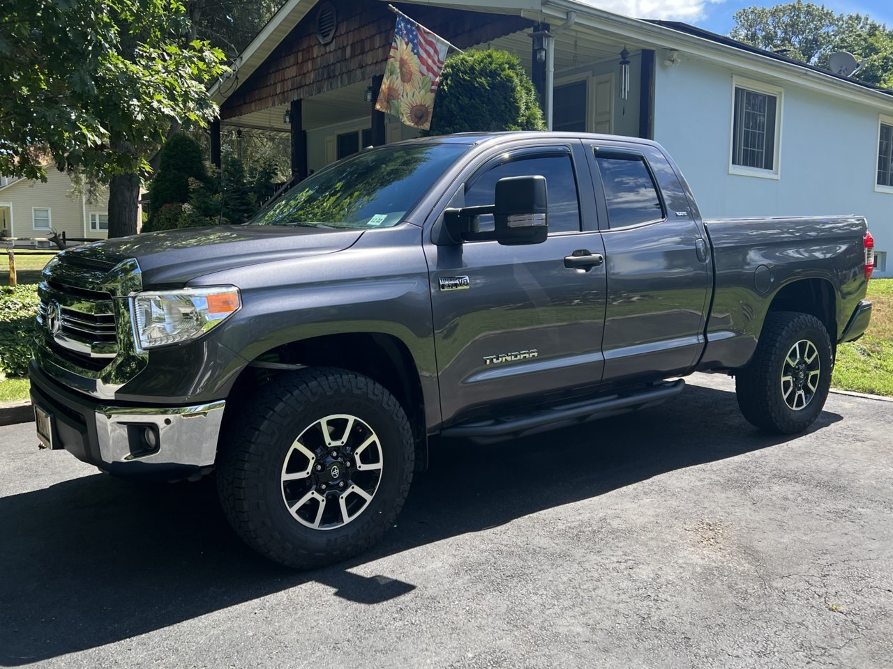

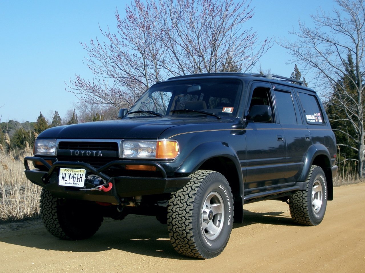

    Hey guys, I just found this thread. Way late to the party I guess. it mentioned Ole Man Emu supension. Here's my 94 LC with an OME suspension and my 17 Tundra with an Ironman suspension. Some interesting thoughts. I put mine own in 2021 and only have 14k on it but I like it, I like it alot. The longer I drive it the smoothers it get. It was pretty tight when it was 1st installed but everybody that gets in my truck says it's has a nice ride.922AB40B-D538-429F-8B0D-36A8BAA6C24D_1_201_a.jpg IMG_5081.jpg I saw
