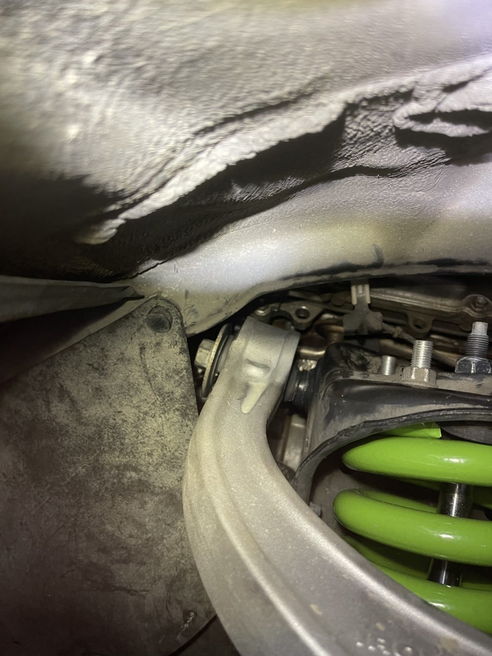

    I have a auto Stethoscope, and you can really hear it with it on the UCA right at the bushing.
    when I did my install, I went off their video, which did not have the UCA install, and when he torqued the factory UCA back down, he said to do it super tight, after watching their video on the UCA, he says 85 ft lbs. I wonder if I have it too tight? I’ll loosen it tomorrow, drive up the road, then tighten it again.

    Make sure the outer UCA washers are not rubbing against the rubber bushings. If they're curved, they curve outwards away from the bushings so they don't make contact. The washers are there in case a bushing blows to try and keep it all in place.
    Happens with Dobinsons UCA's on 4runners

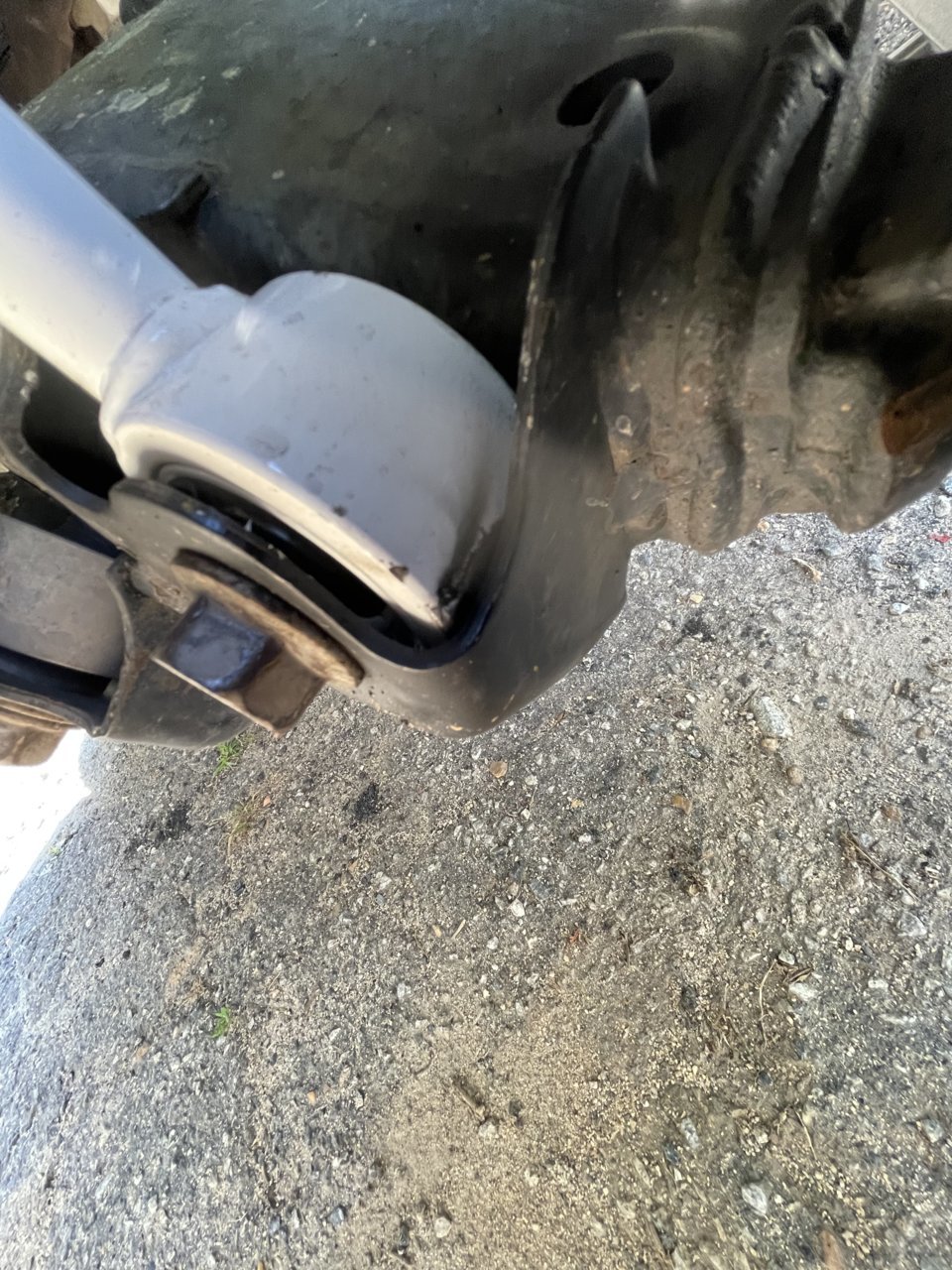

    I think I have them correct. I wonder if they are slightly over tightened, if the noise is coming from the inner part where the UCA contact the truck
    30496956-55A1-4DE5-AFD6-5F868E0C27FD.jpg 0692AEB9-DB6D-4506-8265-A7FB3CD7CA13.jpg

    That looks correct.
    No, it wouldn't affect the alignment. Go ahead and tighten it down all the way, just in case that's what's making the noise.

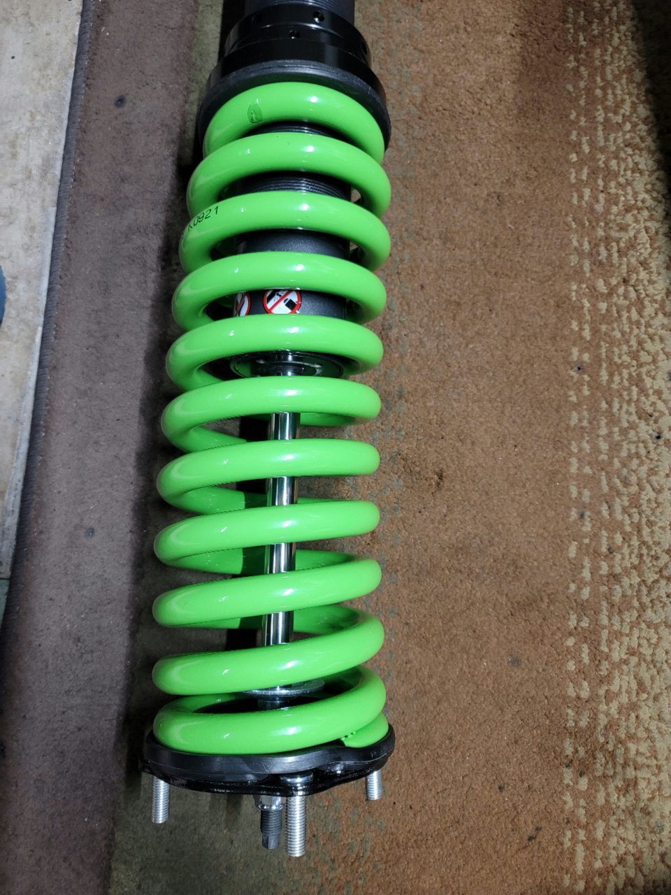

    I suspect it's a lot more than 1-2%. I mean, look how many people on here have had problems. And we didn't just log in to bitch, we were posting before we ever bought them.
    If you could provide pics of both of yours showing how they are set up and where the closest point is, that would help. Mine and everyone I've seen are bowed the same way. The ramp on the lower perch is insufficient to support that end of the coil, so the coil bows towards the high spot on that perch. Like I said earlier, a lift will also tend to make the coil bow outward due to the angle of the top mount not being at quite the correct angle. Plus, another thing going on at the top, is that the spring is kinda ground flat but not quite... there is a fairly large open gap, and where that is positioned will also result in less support and a bow in the coil. The way that IM mounts the springs (with the pigtail and high point of the ramp towards the outside) seems to exacerbate the outward bow (and inward contact) from both ends.

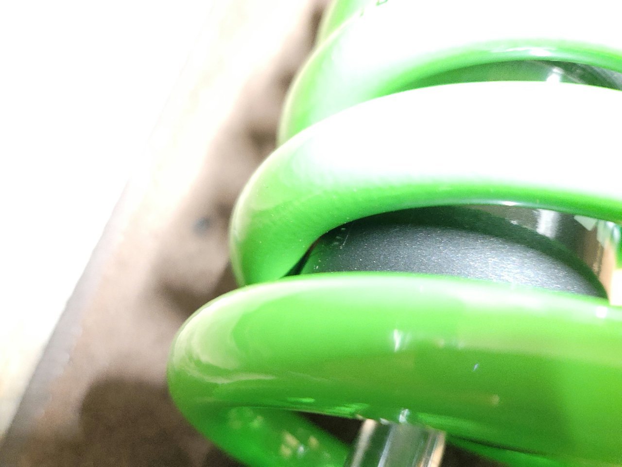

    08, 5.7, Double Cab Tundra, White
    Pics
    rruff likes this.

    Can't believe they shipped them like that... the 2nd picture is extreme!
    Can't see it directly, but it looks like the close/contact point is opposite the high point of the ramp like all the others. Consistent issue...
    equin, AggiePhil and crikeymike like this.

    I got a response from Ironman4x4. They are sending me a new set of struts.
    As of right now, I am happy. Hopefully they will send a new set that isn't so severely bowed.

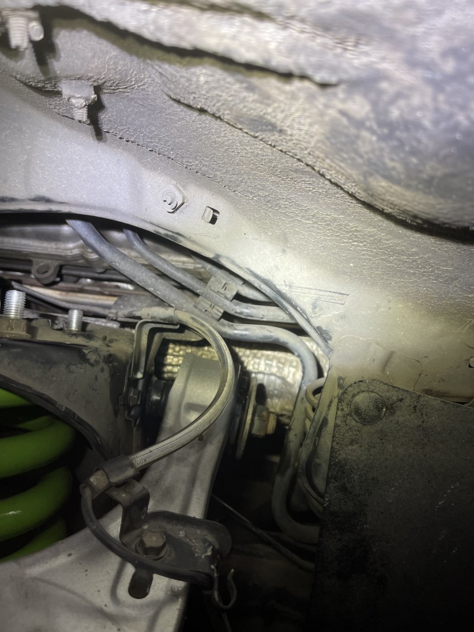

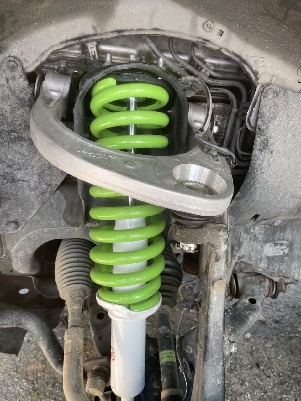

    Are the struts supposed to be in facing a certain direction?
    I noticed on my drivers side, the bottom of the strut is rubbing in the trucks little housing that it sits in.
    1B49766B-EED2-4B30-917D-95861D758D1E.jpg BAB1C362-2A8D-49CF-9563-6F11AB647E6B.jpg
  14. Jun 12, 2022 at 9:06 AM
    #704
    HulkSmurf14
    Aug 9, 2019
    #34377
    2,689
    2014 Tundra Limited
    Tastefully enhanced...
    Typically they are showing their stickers towards the outside for marketing...perhaps that's why it is rubbing...
  15. Jun 12, 2022 at 9:33 AM
    #705
    Jmccracken1214
    Jmccracken1214 New Member
    May 1, 2022
    #77821
    93
    2015 Tundra CM
    I’m confused because looking at a pic of the strut, the bottom mount looks centered with the body, so shouldn’t matter? But idk
    rruff likes this.

    I took my UCA off, greased the hell out of it, reinstalled, still making noise. I sprayed white lithium on the lower shock mount and no noise.
    may be dumb luck, but I’ll drive it a day or two and check
    HulkSmurf14 likes this.
  18. Jun 12, 2022 at 9:58 AM
    #708
    rruff
    rruff New Member
    Oct 18, 2021
    #69521
    1,004
    2016 Tundra SR DC Long
    Looks like it's rubbing, and I'd expect that to squeak... but I doubt it was an install issue.
  19. Jun 12, 2022 at 10:00 AM
    #709
    Jmccracken1214
    May 1, 2022
    #77821
    93
    2015 Tundra CM
    The passenger side has a very small spot in the same area, wonder if it’s worth relaxing, or just get the grease gun and squirt a dab in there
