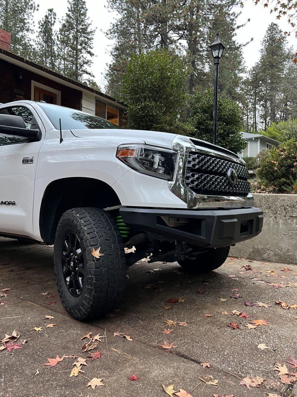

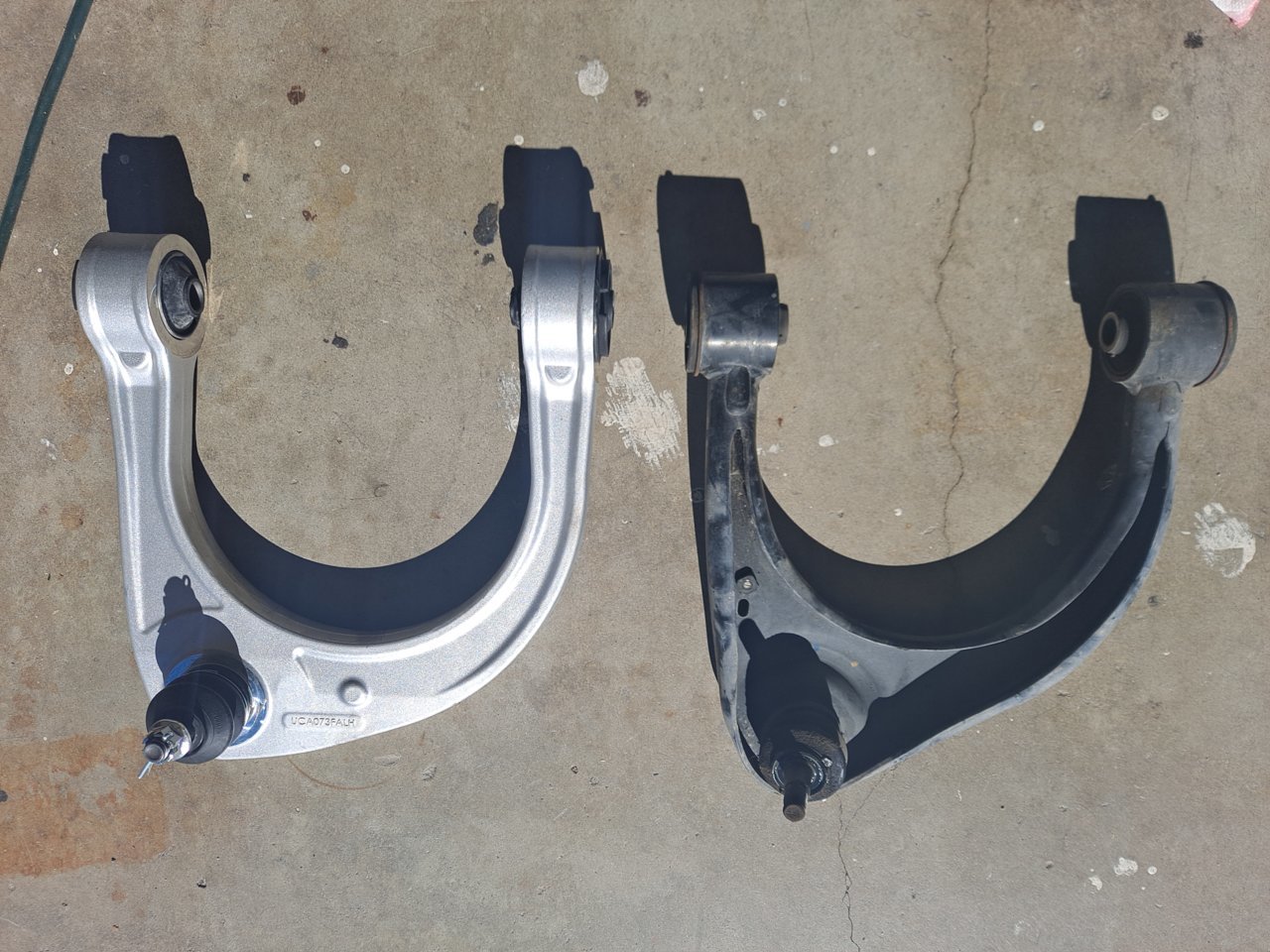

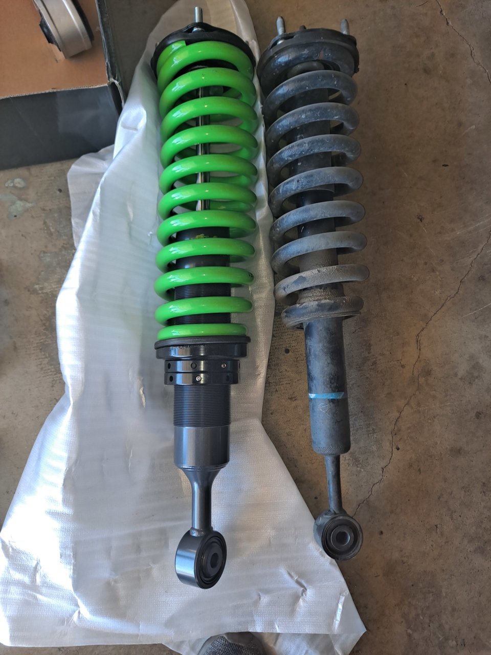

    Alright, got the pre assembled FCP struts at 3.5”, and their UCA’s. I’ve got around 200 miles on them. Coming from a 3” spacer lift, I’m very pleased with the ride quality! Good alignment numbers too, with almost 4 deg caster.
    387C70D8-2EDC-481D-B1A0-F86E42D1E34A.jpg E8E78205-1A1D-4CD6-939B-7400D23E38E7.jpg 86718217-DF13-4B74-A933-ADB321EE24D5.jpg

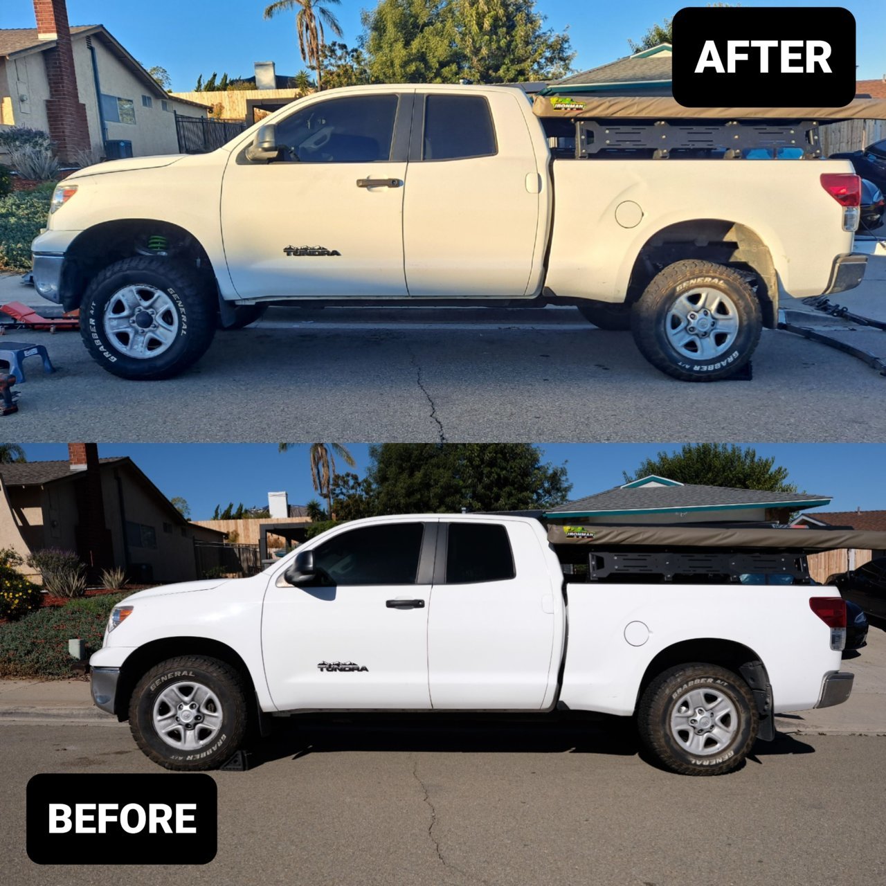

    Installed my 3.5" lift about 3 weeks ago and it's going great so far.

    Thanks! Some details... like how is the before and after ride and handling with different loads, on road and off?

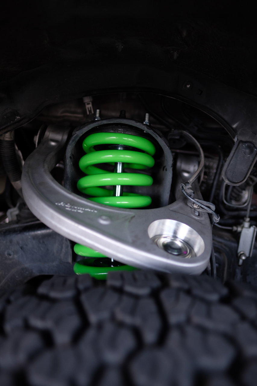

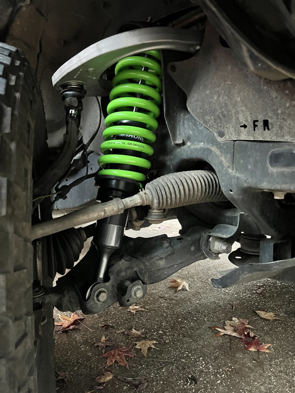

    Well I'm having issues where my OEM rims are touching the UCAs which causes the traction control to go off when making hard turns.
    Once I get my new rims, race relation wheels, I'll take the Tundie off road but I can tell the rebound is smoother when I took it to Little Blair Valley. I'll give more updates in January when my rims come in.

    Wow, haven't seen anyone mention clearance issues on the UCAs before... good to know! Guess everyone has rims with less offset?

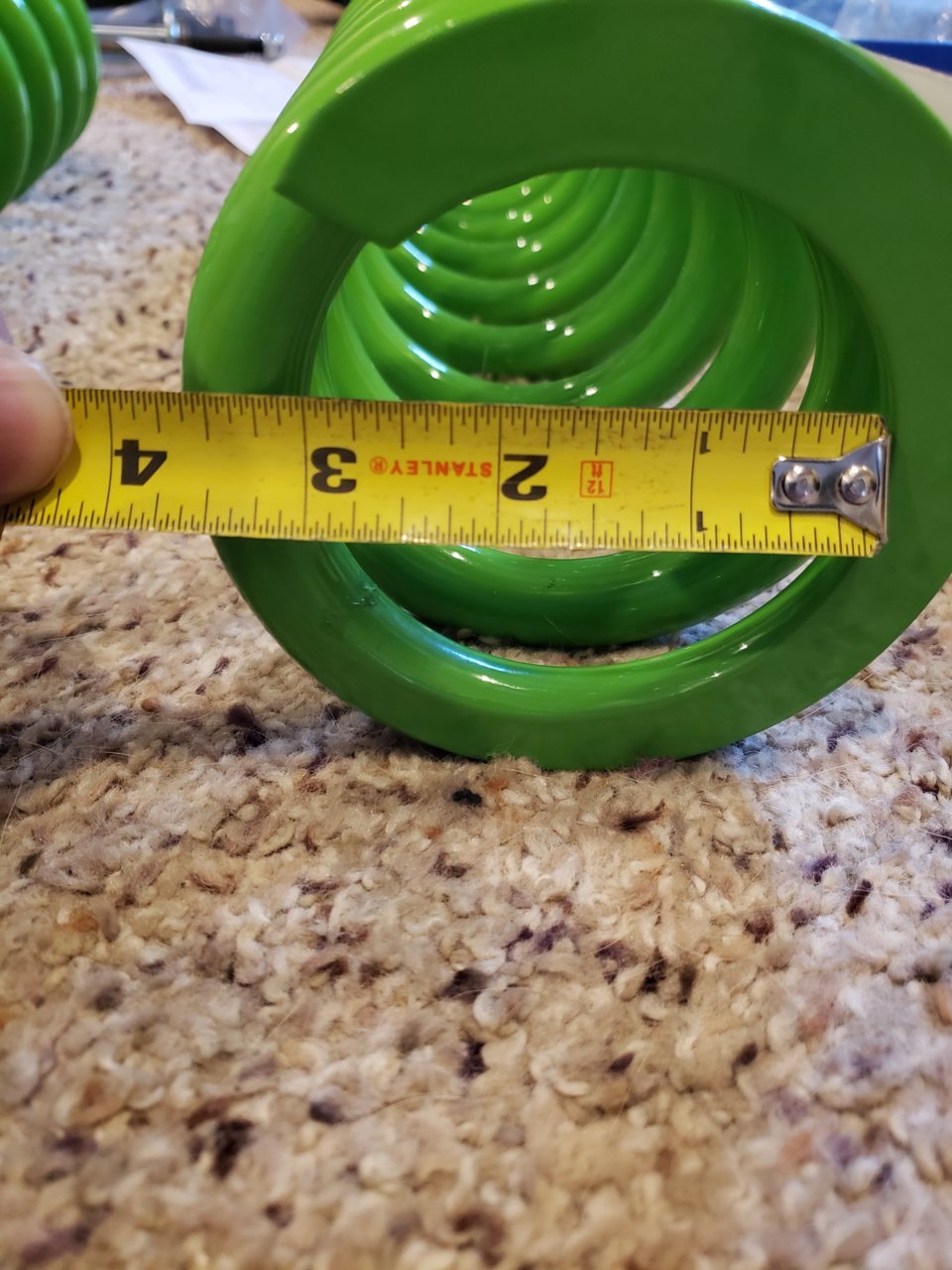

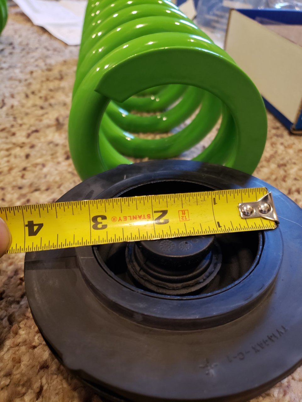

    Question for anyone that assembled their own coilovers:
    I bought new Moog tophats specific for my Sequoia, for the Foam Cell Pros.
    The bottom side of the tophat that sits inside the coil is too wide, by a 1/4". IM doesn't make a tophat for the Sequoia. Anyone got any ideas? :help:

    Weird because I confirmed the Moog part number and they should fit the same as OEM Toyota.

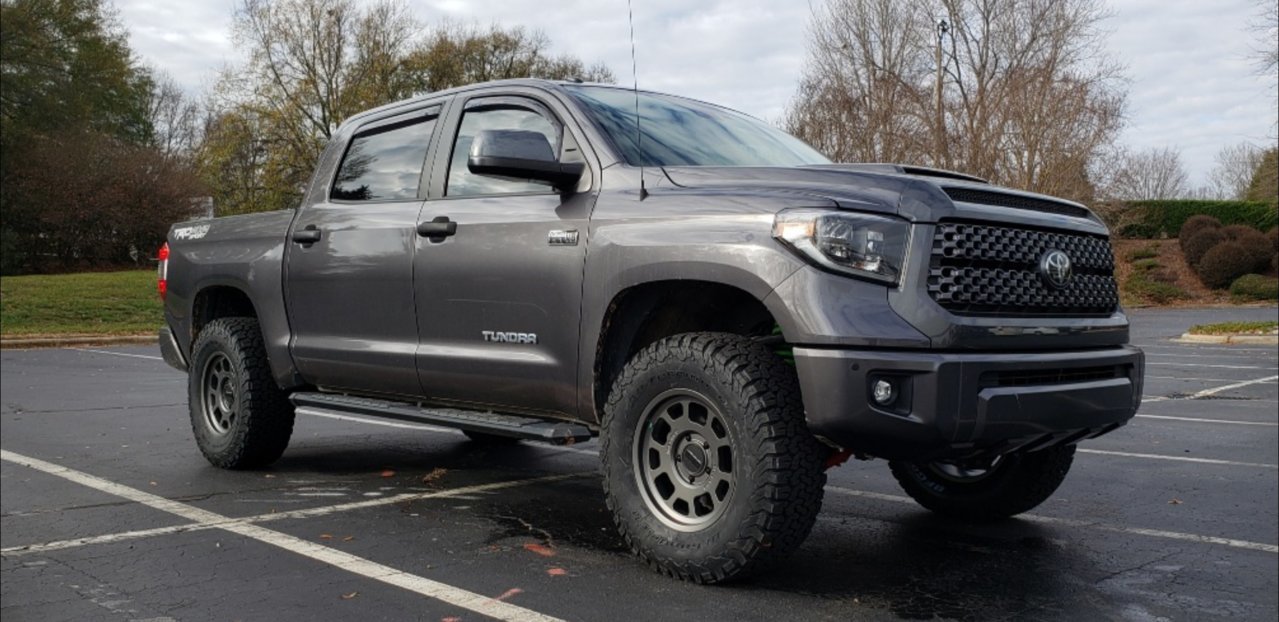

    Got my Foam Cell Pro suspension installed over the weekend. I went with the assembled struts, medium load front and rear. Haven't had a chance to really drive it but it looks great and what I have driven is tight; no dip in the front end even on hard braking, cornering is great.
