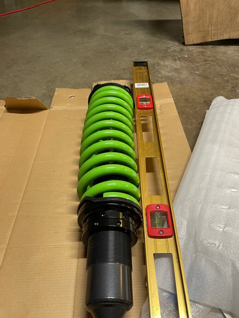

    These are the new ones. Does this look right?

    No.
    These were on my short list but now.. I'm not so sure.

    One of my coilover sitting in the garage looks the same. Have you contacted IM about this?

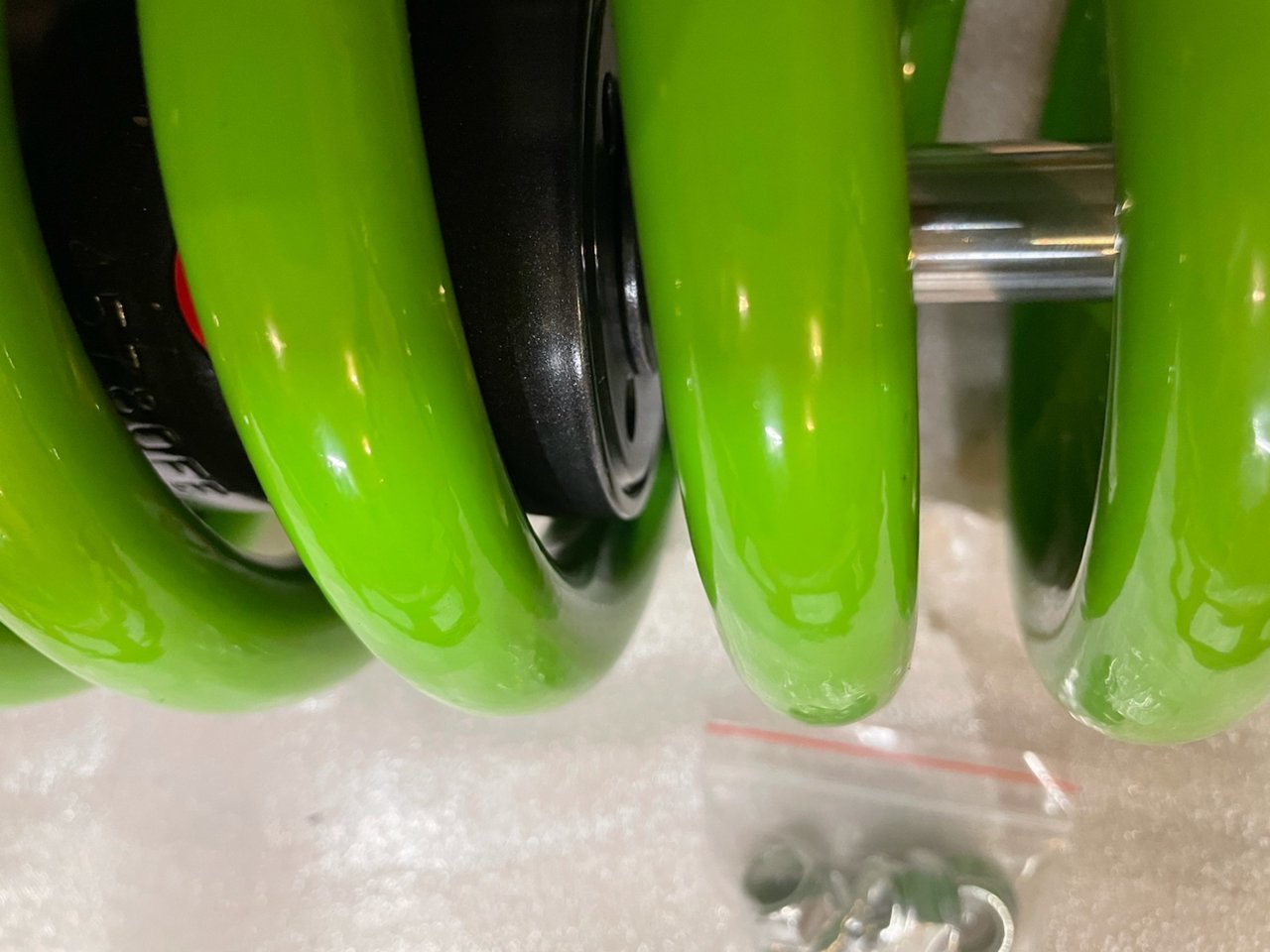

    Not liking this. I know manufacturers have problems but I am not liking the bowed coils. This definitely makes me wonder why the coil is bowing. It would seem once placed under more load the coil will bend outwards even more.

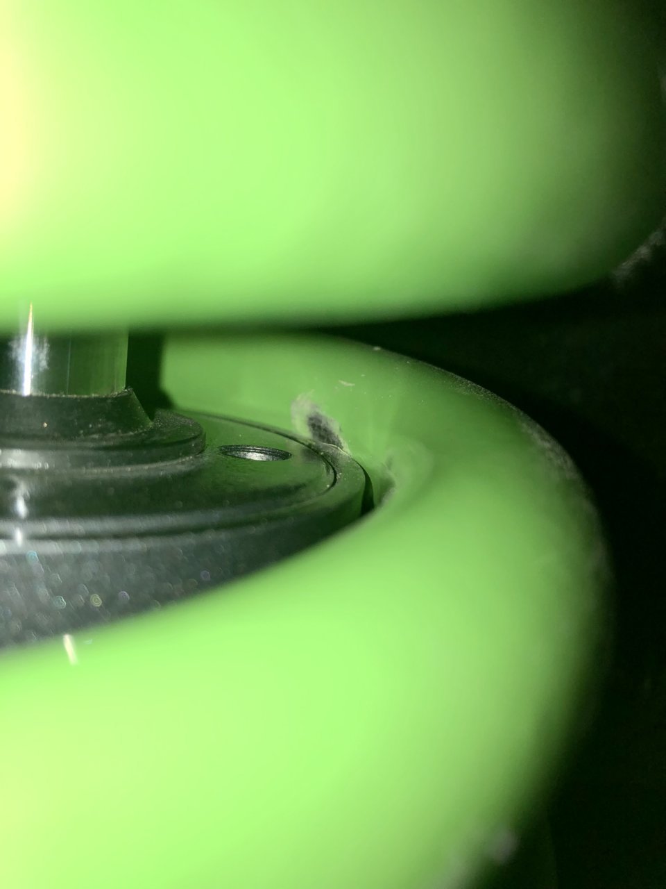

    Welp, this is a bummer. Guys might want to hold off on ordering right now. Mine have a whole 20 miles on them and already lost the paint. Shop put them on at IM stock settings too. So not sure if lowering them will help, but they’re steel and they’ll rust. Unfortunately I won’t be able to do anything about it before the end of the month and I’m getting ready to head out camping next week.

    How did the powder coating come off? Aren't they setting in a rubber/poly seat?

    If it’s not clear in the picture, this is the coil and the top of the shock body. You can see they’re touching under load.

    Yeah, that should not happen at all, looks like the body of the shock is too big for the ID of the coils that they're using, not leaving enough space

    Well this is not only unacceptable but a huge bummer. While I don't have any contact between the springs and shock body I did have some bow. All is good with the front but I have a ridiculous squeak from the leaf springs. At first I thought I didn't grease the bushings well enough. 3 times I pulled the leafs and re greased everything. No fix. Finally contacted IM sent them video and pictures. They sent me brand new leafs no charge. Good customer service right......can't argue that. Installed new leafs. Same squeak after 2 weeks. Regreased bushings again. No avail. Replaced IM bushings with coach builder. Same squeak. Started hosing down leafs with silicon wd40. Finally stops squeak for about 2 weeks. Clearly the leafs a rubbing. As much as I want to promote this lift kit.....I can't. It seams like they have some manufacturer issues to solve. Too many issues. Damn this sucks

    Can someone with out the rubbing please take a picture of the spring seat on both sides. On mine, the driver side has the "pig tail", end of the coil facing the front of the truck and the passenger side facing the front. I remember in the past the orientation of some of the OME coils could affect rubbing.
    Curious if anyone elses are different.
