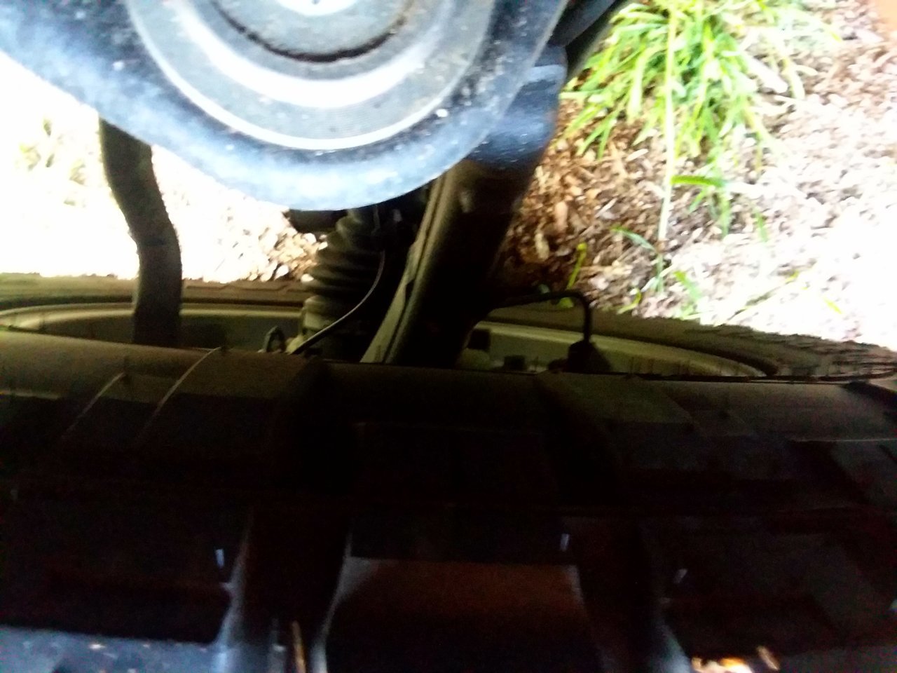

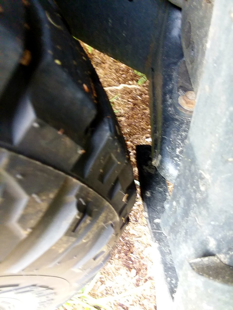

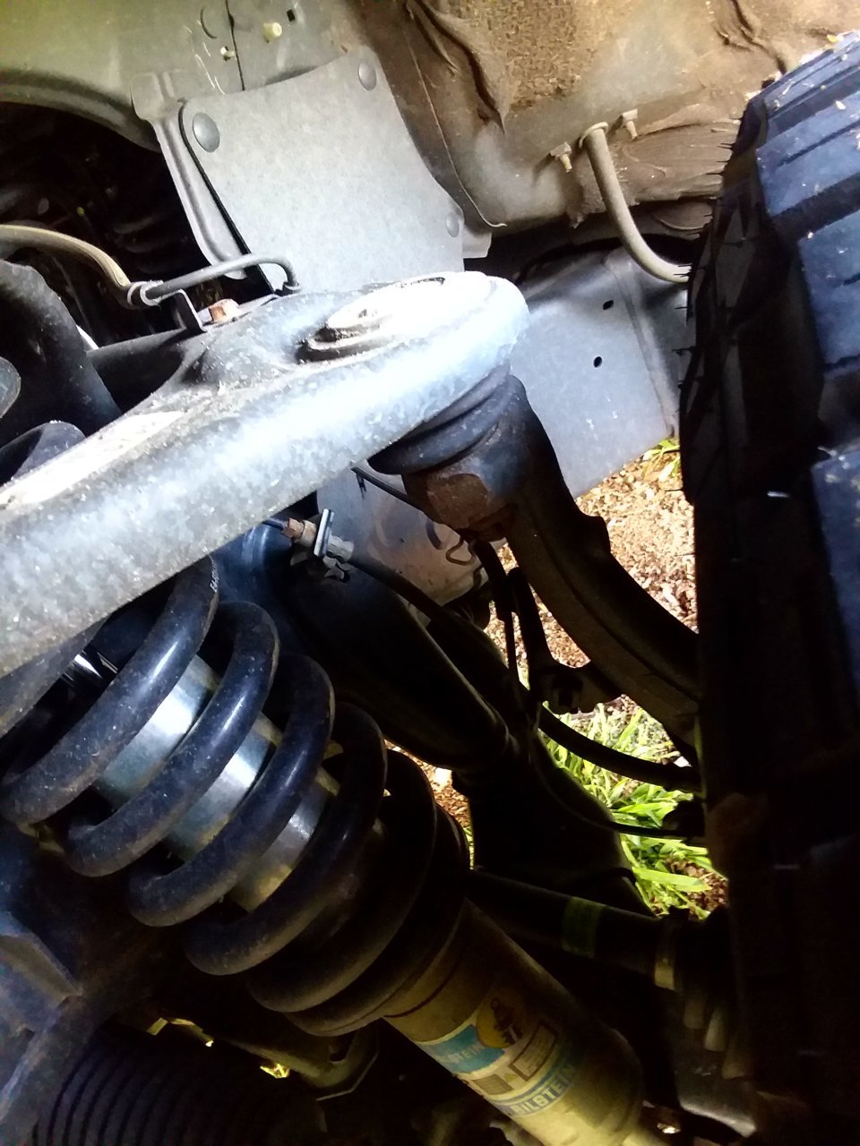

    SICKKKK! Thanks dude. Is that last photo the clearance from the small mud flap under the fog lights?

    No, that's the larger mud flap and cab mount, I altered part of the flap so I could reinstall it.

    Oh okay the larger one behind the front wheels? And would you say that I might not need to modify anything? I know you put some things back that's why haha

    Yeah the one behind the frt tire, if I was you I'd just pull both flaps prior to getting your tires and when back home see about clearance issues, that pic is at full lock btw. I believe I did need to modify that flap as it would have rubbed where it covers the cab mount.
