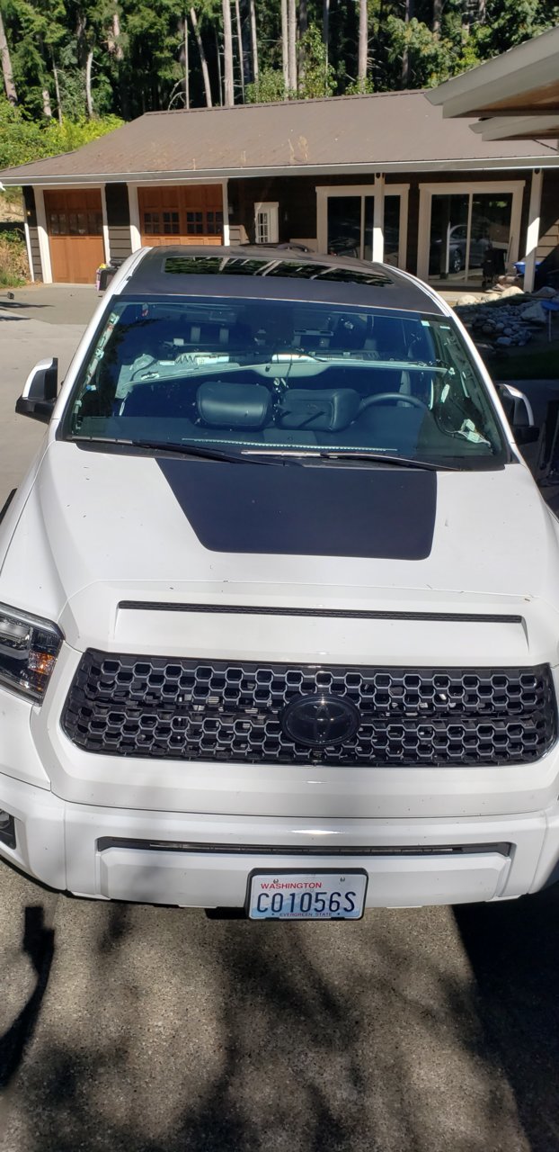

    It took way longer than expected but I did get the roof vinyl done.

    I used some scrap plastic (what I believe to be HDPE) to make an aerodynamic sharkfin delete.
    The small peice in an attempt to make a bung so I can use waterproof heat-shrink tubing to seal the cables.
    I still need to router out the bottom to create a pocket for the plugs but its looking promising and fits below the crossbars.
