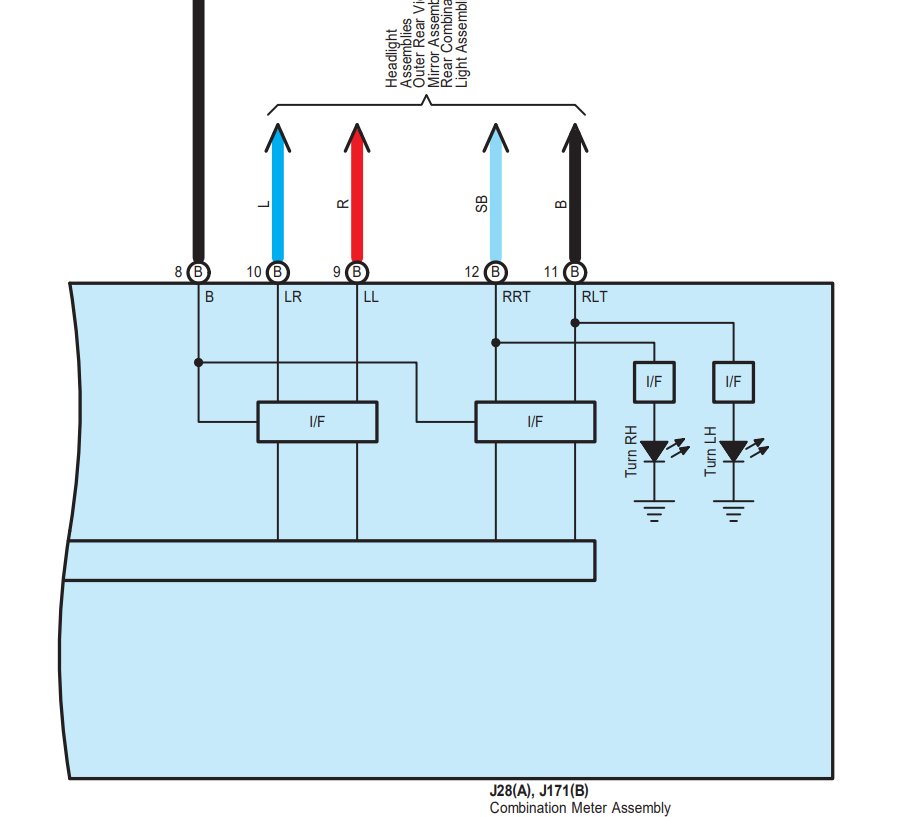

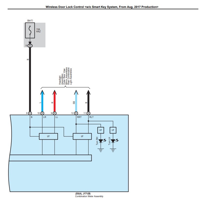

    I think it is going to have something to do with your combination meter assembly or ECU glitch..
    I can't find a definite connection between the door lock/unlock and the turn signals except for the combination meter..
    On my 2014 the parking/plate lights and turn signals all flash when locking and unlocking the doors.
    Although I have an aftermarket remote start/alarm that may have something to do with it.
