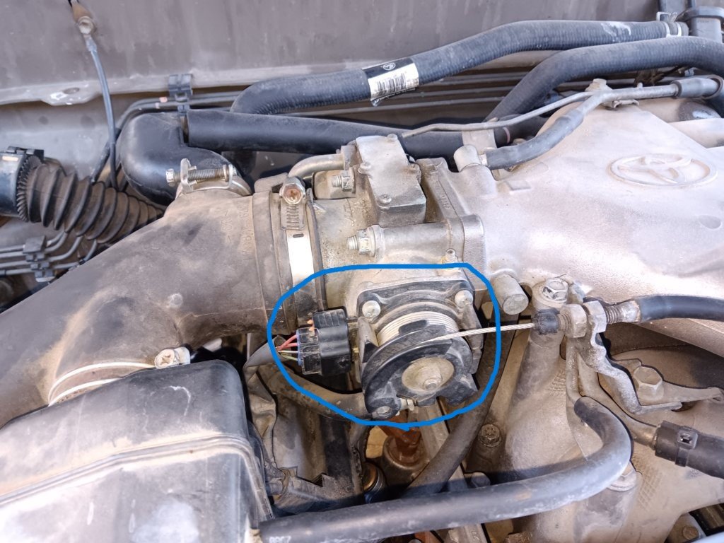

    Hmmm. Do you have the 3.4 or the 4.0L engine?
    I'm pretty sure that this is the APPS. It's located on the throttle body and looks similar on 4.7L and 00-03 3.4L trucks for sure.

    I get what you mean. That could definitely be the case- but I know for sure that on the V8 trucks and the 00-03 (unsure about 04) V6 trucks, APPS is on the throttle body. It's built in to the drum that the throttle cable wraps around. 2004 was a weird year- lots of one-year-only changes. I know for sure that the 00-03 trucks don't have a sensor on the accelerator pedal itself. Do the 2004s?
    This sensor seems to match what's on the throttle body on your truck. It's listed as the "Throttle body rod position sensor":
    https://www.ebay.com/itm/3652328357...h8TZ5Rp4o87rwntuUUVV-VY2p5Gf_PGhoCUVgQAvD_BwE
    I don't have experience with the sensor connected to the pedal, only the one on the throttle body. So I can't say for sure if the one on the pedal or on the TB is the issue.

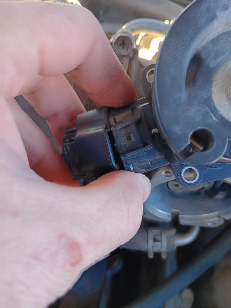

  14. Dec 11, 2024 at 8:50 AM
    #44
    J-H
    J-H [OP] New Member
    Nov 4, 2024
    #125406
    45
    2005 Tundra Access cab V6
    It has arrived and looks like a very simple swap-out, except that the sensor is held on by PHILLIPS head bolts for some reason.
    The 20 year old bolts don't want to move, and I've already seen my screwdriver strip one slightly. I've sprayed them with penetrating oil, but no luck after 20 minutes. Next step is going to be to close the hood and run the engine for half an hour to warm it up.

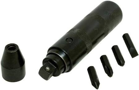

    Impact driver is your best bet. Or Japanese screwdriver hammered into the fastener. I’m sure it’s probably held in with thread locker of some sort, but I wouldn’t expect more than blue.
  16. Dec 11, 2024 at 9:44 AM
    #46
    bfunke
    bfunke Tundra Curmudgeon
    Oct 13, 2019
    #37321
    2,409
    South Carolina
    2018 SR-5 CM 5.7, 2000 SR-5 AC 4.7L
    When I was a teenager, I bough one of these to remove Phillips screws from my Honda motorcycle cases. It’s an impact driver and you hit it with a hammer.
  17. Dec 11, 2024 at 9:54 AM
    #47
    Upshot Knothole
    Upshot Knothole New Member
    Sep 5, 2024
    #122480
    112
    Thatchery
    Outside of PDX OR
    2003 SR5 V8 AC TRD 4x4
    I'm guessing they're JIS screws, so get some JIS bits off Amazon. Phillips screw drivers will strip out Japanese screws, years of working on Japanese motorcycles has taught me that lesson too many times.
  18. Dec 11, 2024 at 10:00 AM
    #48
    shifty`
    shifty` I'm having daydreams about night things
    Jun 20, 2020
    #48239
    28,419
    ATL
    '06 AC Limited V8/4WD
    Yup, JIS screwdriver that fits the head is ideal. One that can take hammer blows- 2-3 firm taps on the butt of the driver to both seat the driver AND potentially free the bond, then firmly pushing while twisting. You’ll see a shit-ton of import guys in salt areas swear by this method for brake rotors/drums.
    I personally have a Lisle impact driver like @bfunke posted. There are a lot of shit ones out there and the ones Lisle makes today are okay-ish, better than any brand you find on scAmazon and many store brands, but they’re not the same as the old ones that functioned more cleanly. You basically need to twist the driver constantly CW or CCW and hold it forward on the newer style one to get it to ratchet in the proper rotation when you strike which was annoying for me. On my old one; which is worn and I’d love to replace, I simply put the driver in the head of the bolt, twist it to set it to drive-in or back-out, then strike away. It doesn’t tend to drift back out like the newer model one does. I ended up returning the newer Lisle, and I’m just dealing with my old one being worn out. I’ll probably break down and try to rebuild the old one, or scour eBay for a vintage one in good shape, since all the new ones I’ve tried feel like shit.

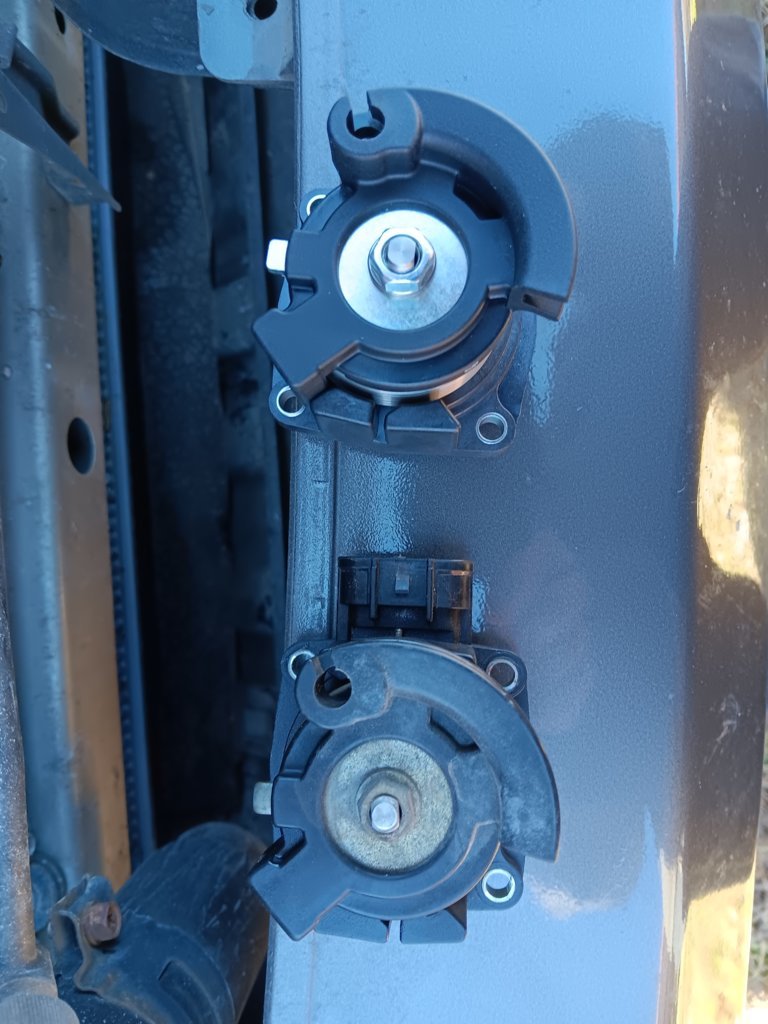

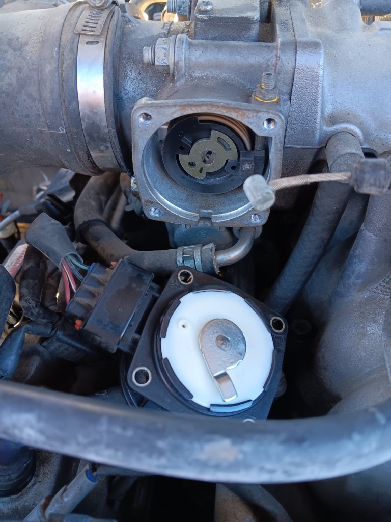

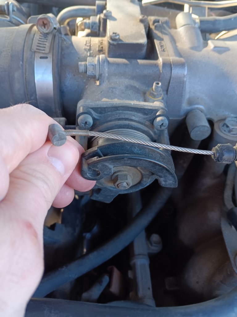

  21. Dec 11, 2024 at 10:16 AM
    #51
    J-H
    J-H [OP] New Member
    Nov 4, 2024
    #125406
    45
    This is dead-simple, but there's not even a video on Youtube about how to replace it.
    First, take a picture of how everything is supposed to look before you take it apart.
    I also marked the throttle cable with a sharpie right at the adjuster nut, just in case it ended up having to come loose.
    Then I rotated the spring-loaded cable receiver to loosen the cable. I could then pull the cable up into an inverted U, giving it clearance to pivot so that the metal cylinder on the end could slide out the front.
    After that, I removed 4 screws, and it came loose easily. The throttle body behind it has a spinning piece that this component actuates. It moves with hand pressure easily and smoothly.
    Then I removed the wiring harness. The tab to be pressed down is on the harness plug, not on the body of the component I am replacing. Harness end looks like it's in good shape.
    Old and new components look identical.
    Bolted it back in, reconnected the harness, put the cable back in, and tested. It functions fine.
    I will need to test drive for a while to see if this has resolved the problem.
