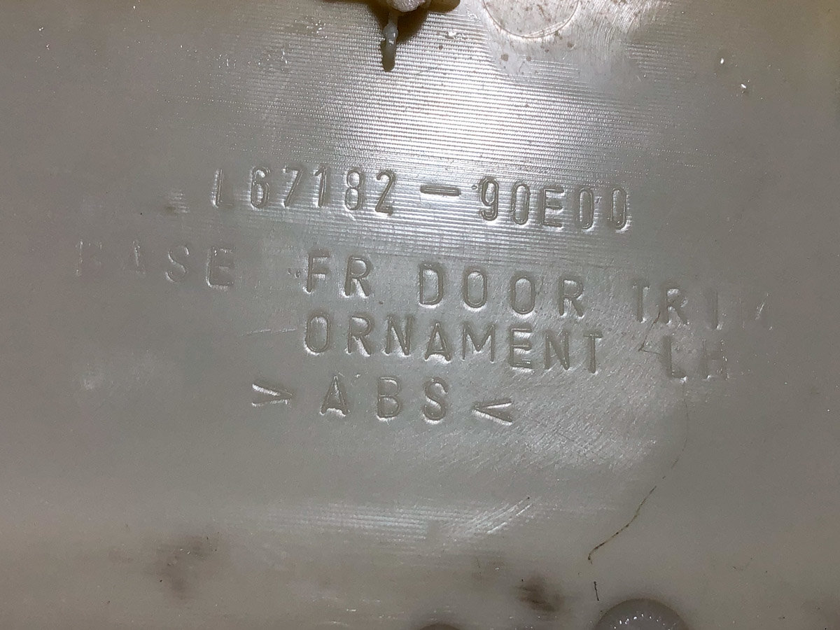

    I finally had a chance to go at this with an angle grinder and flap disc. Easy, and I see what you mean - makes sense when I see it!
    Now: any suggestions on how to remove the ancient gross fabric and padding? I can scrape at it, but I'm afraid of any solvents damaging the old plastic door piece. Edit from a couple hours later: I just scraped it off. Some coarse sandpaper helped.

    Got it all cleaned up! Depending on your situation, might be a project for a) when the wife isn't around or b) to do outside and not in the bathtub.
    Ick.
    ABS slurry?
    Unfortunately after getting the fabric off I discovered several small cracks. Hardly a surprise since it's from a 19 year old truck that has been in a wreck and then abused in a junkyard under the Arizona sun.
    But, it's ABS, and a little bit of quick research on the internet leads me to think I might be able to "melt" the cracks back together with acetone, and then even patch / reinforce with an ABS slurry.
    From this video the guy dissolves 50g of ABS scrap in 125mL of acetone, then just paints it on. Looks pretty good to me, anyone see a problem with this approach? I feel like slathering it all over the back, at least where I'm fairly sure there won't be clearance issues.
    https://www.youtube.com/watch?v=a4LoMJGfhzg
    I've got ABS scrap ...probably only black though, but shouldn't matter, right?
    Tweeter grill?
    Much like this panel itself, the tweeter grill was installed by just holding it in place and melting the plastic studs. @BubbaW and @RR60, do you remember how you re-attached the tweeter cover? These are too small to screw into.
