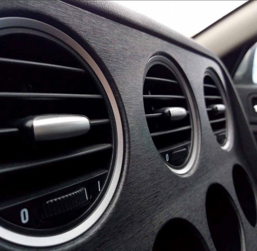

    I was looking at the 3M dicon carbon fiber, but am leaning towards the 3M 2080 brushed black wrap now.

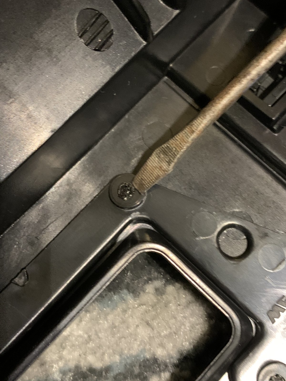

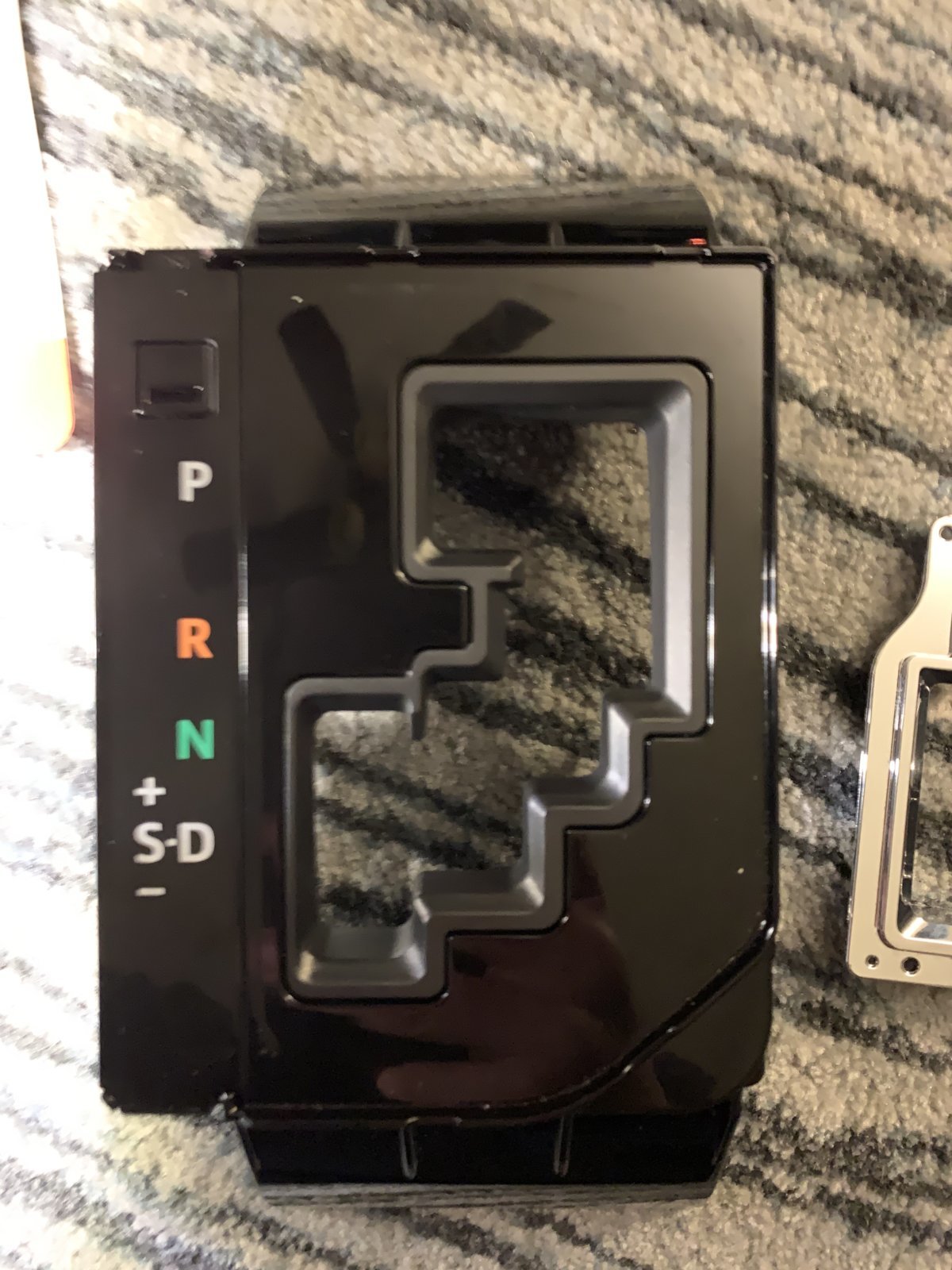

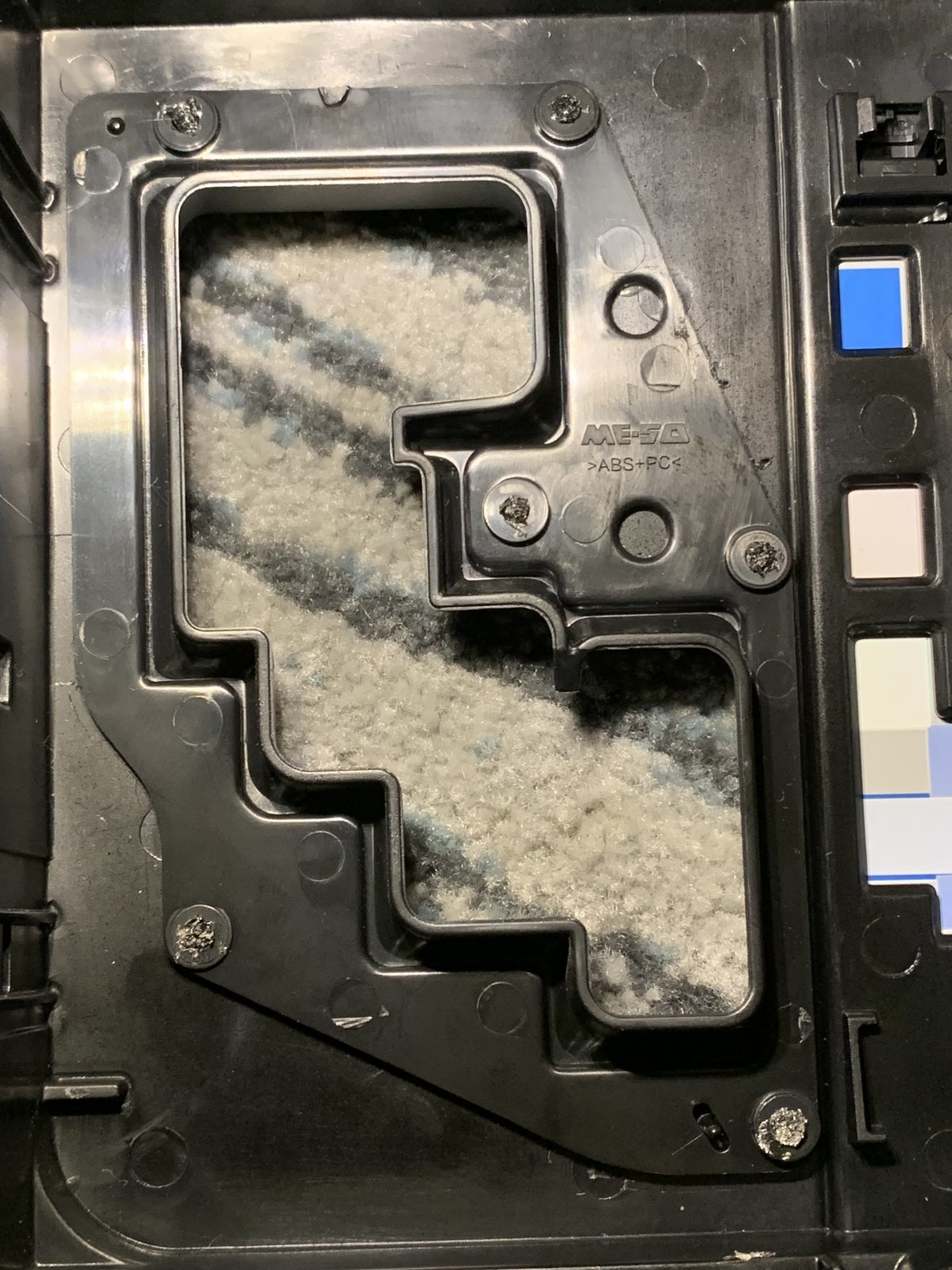

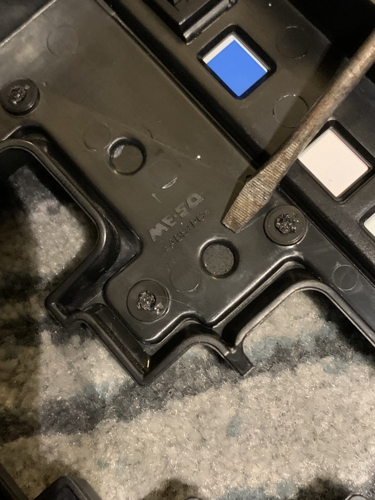

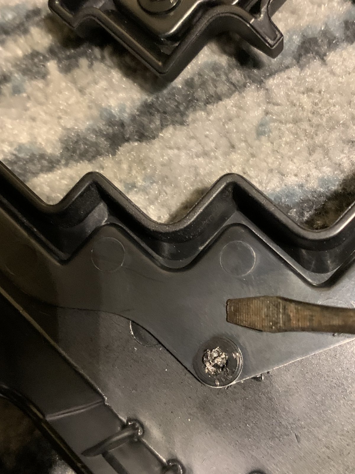

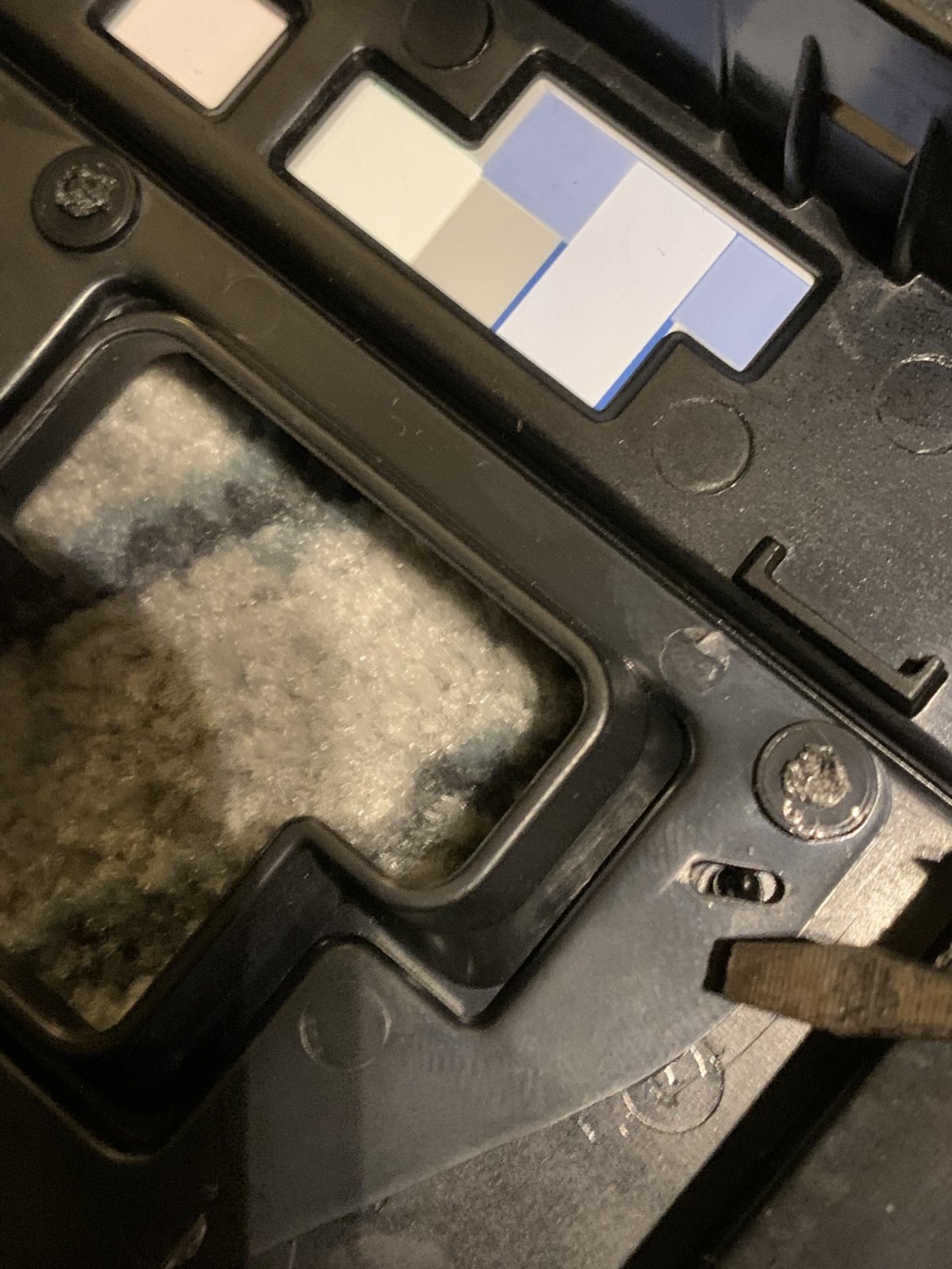

    Reviving an old thread. But having some issues with removing the chrome around the shifter.
    Any tips on removing it?
  6. Nov 27, 2023 at 3:08 PM
    #66
    gizardlizard
    gizardlizard New Member
    Oct 18, 2022
    #85072
    246
    Madison,WI
    2017 TRD pro Tundra
    6” lift, 35 inch tires, chrome delete, ridiculous stereo
    Been awhile since I did mine, but if I remember right the shift gate is heat staked in a few spots to the other piece. I seem to remember having to grind the heat staking nubs a little and gently pry off the shift gate.
  7. Nov 27, 2023 at 3:44 PM
    #67
    RustyShackle323
    RustyShackle323 New Member
    Jan 31, 2021
    #58409
    556
    Stewart
    NC
    2019 Platinum - Barcelona Red
    Thanks for the reply. Mine all look to be heat staked. May need to get creative lol
  8. Nov 27, 2023 at 4:56 PM
    #68
    gizardlizard
    Oct 18, 2022
    #85072
    246
    Madison,WI
    2017 TRD pro Tundra
  9. Nov 27, 2023 at 5:32 PM
    #69
    RustyShackle323
    Jan 31, 2021
    #58409
    556
    Stewart
    NC
    Thanks for the follow up. I came up with a way that did not require grinding and turned out looking nearly OEM again.
    For those that go with Meso black out kit. This is what I did to remove and install the shift gate trim.
    These pictures are all of the finished product. I forgot to snap pictures prior to removal of the chrome”.
    1. Use a small flat head screwdriver. And lightly pry up on the (6) heat staked tabs that hold the chrome trim on. It does not require a lot of force to do this.
    2. Once all the tabs are essentially “broke” off, mix up a small portion JB Weld and apply a light coat in the three general areas
    3. Using a soldering iron, plastic weld the little tabs that remain from step #1 down until they just touch the new black shift gate. Be careful not to apply too much heat all at once! Little taps until it just touches and you’re good to go!
