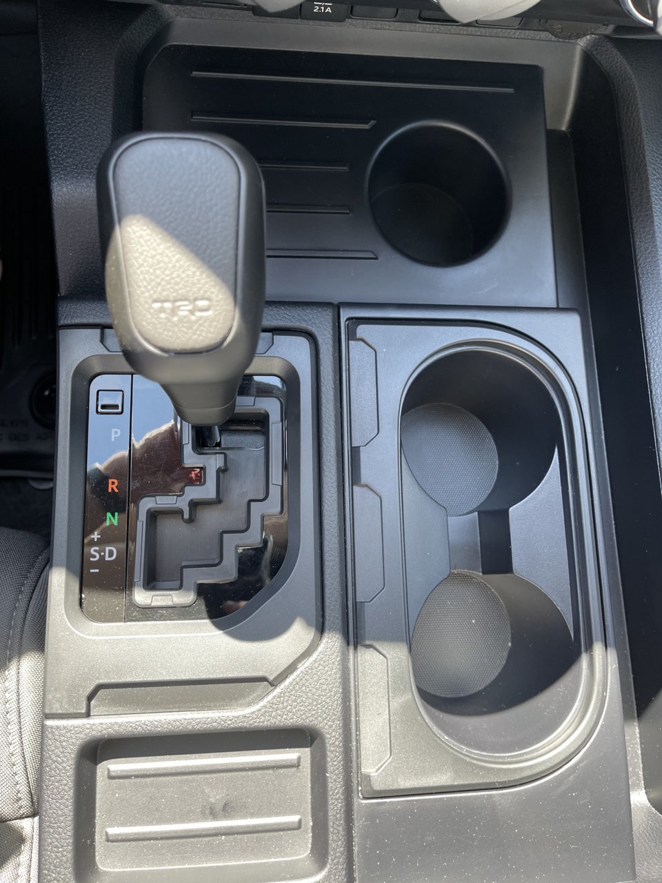

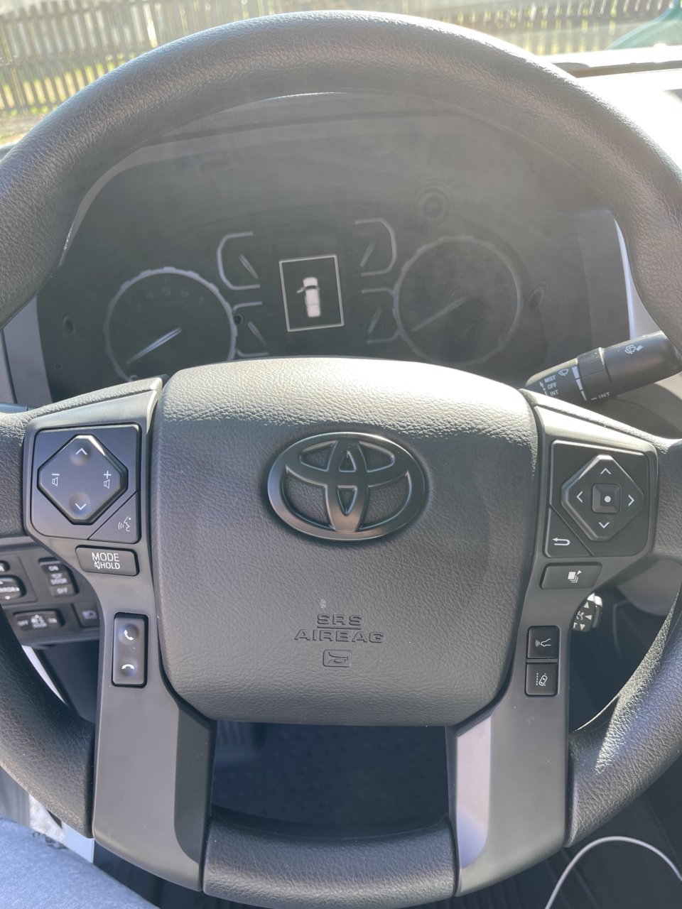

    The steering wheel overlay came in yesterday and the AJT shift gate came in today. Now the steering while and shifter/cup holder area is done. 3121F6B2-E0B8-4E4E-BC13-4373D1C013ED.jpg AC123C22-85A3-4D36-8D60-B8C2855C39CE.jpg

    I don't think so, yours just looks more matte based on the angle. Mine looks the same but has more of a sheen to it in person.

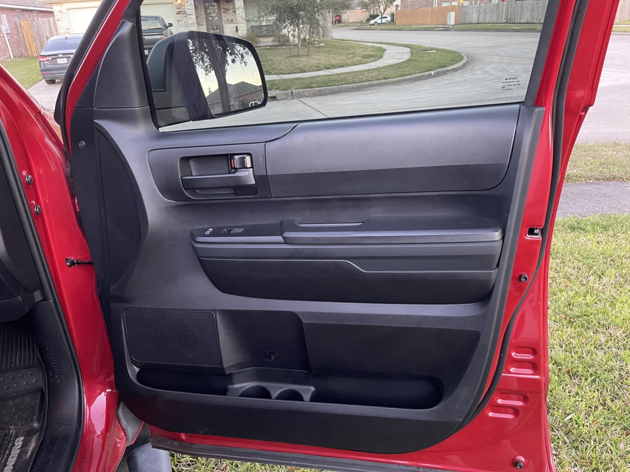

    I found a work truck that the interior door is all Black. Can’t just order the chrome/silver piece in black so you would have to paint it or order a whole interior door panel.80559A6E-0354-4CE6-A47D-EC843A701EFC.jpg
    seeing how much that would be. I am positive that just painting it is cheaper.???:)

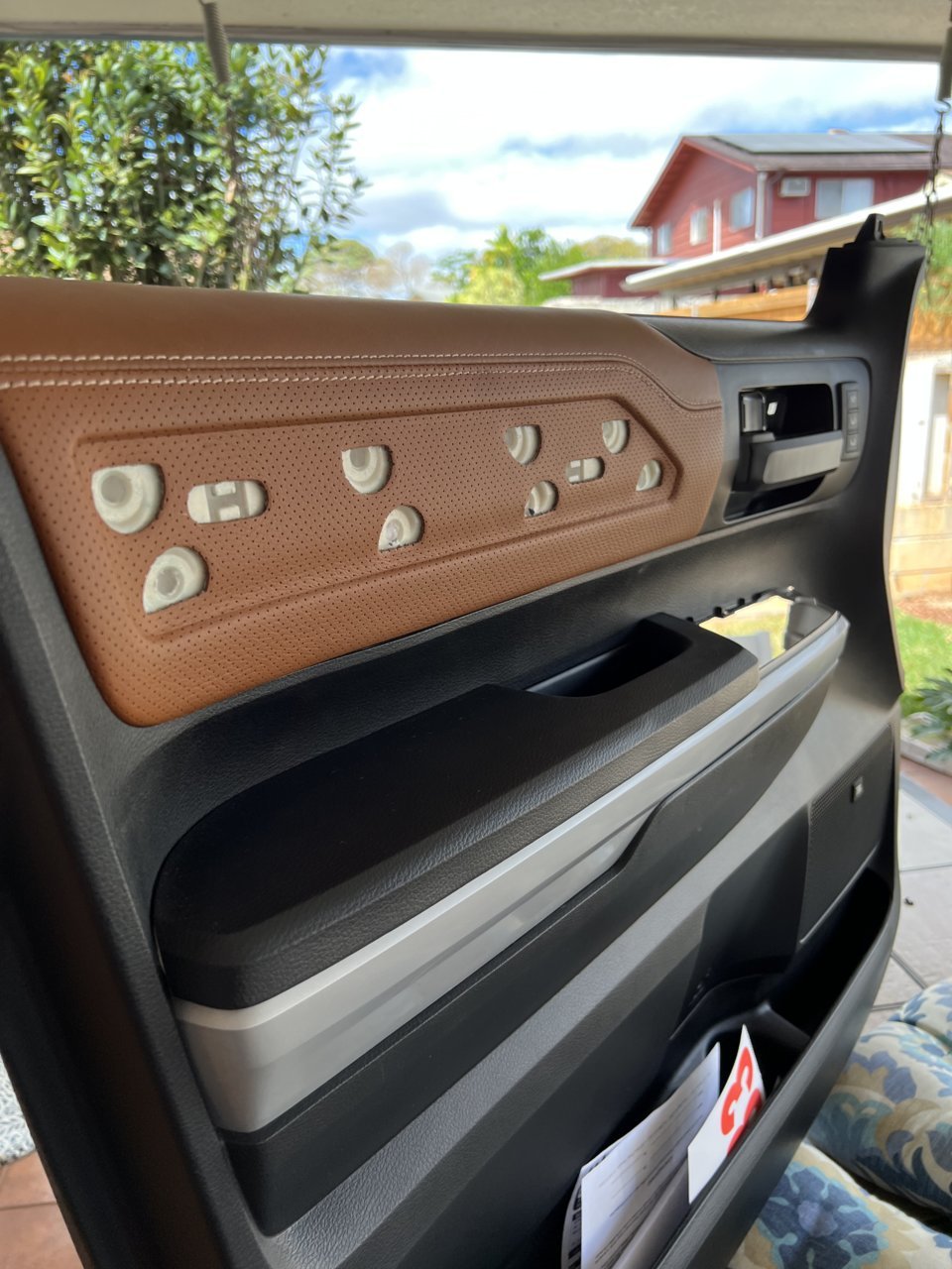

    Hey Beer Man, how well do those red ebay overlays for the door fit? I was looking at painting them matte black as well but I couldn’t find any reviews on them

    They’re good, but they could stick better. Maybe try and rough it up before sticking the tape to it. One of my corners was coming up so I just hit it with a drop of krazy glue. I also thought about velcro but I didn’t ever try it cuz the glue worked

    Right on, thank you! ill replace that tape with 3m xtreme mounting tape.. that stuff is strong

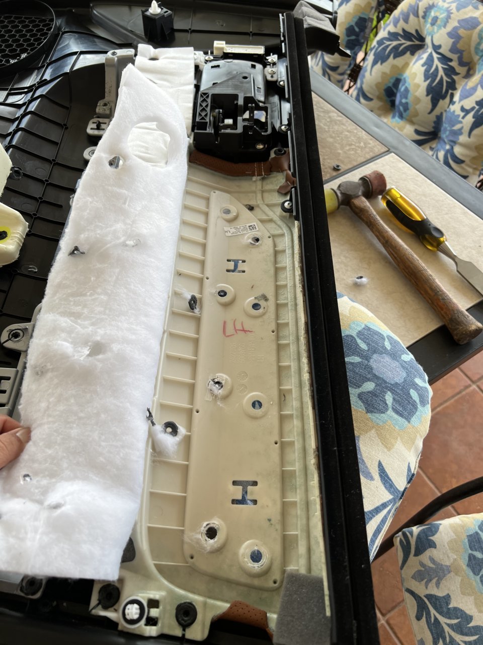

    vinyl wrap i did on the panels kept peeling on the edge, just took apart the doors and removed the panels to paint. Napa brand trim black with 2k matte clear over it. found out that you can just knock off the factory plastic welds with a sharp chisel and hammer. no need for a dremmel. interior blackout is complete now lolIMG_0764.jpgIMG_0766.jpgIMG_0771.jpg

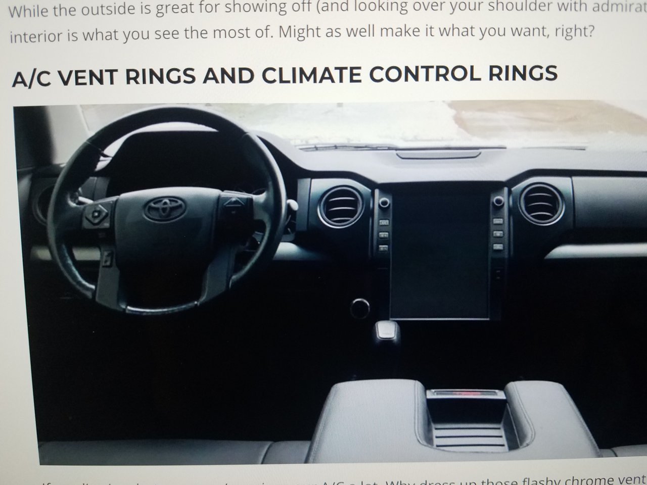

    Sorry for the bad picture. It’s too dark out and i couldnt find my old images of it. The 2nd pic is an example of what mine looks like. I vinyl wrapped around the vents, and steering wheel pillars. I also wrapped my steering wheel. I hated the feeling of the stock wheel.
