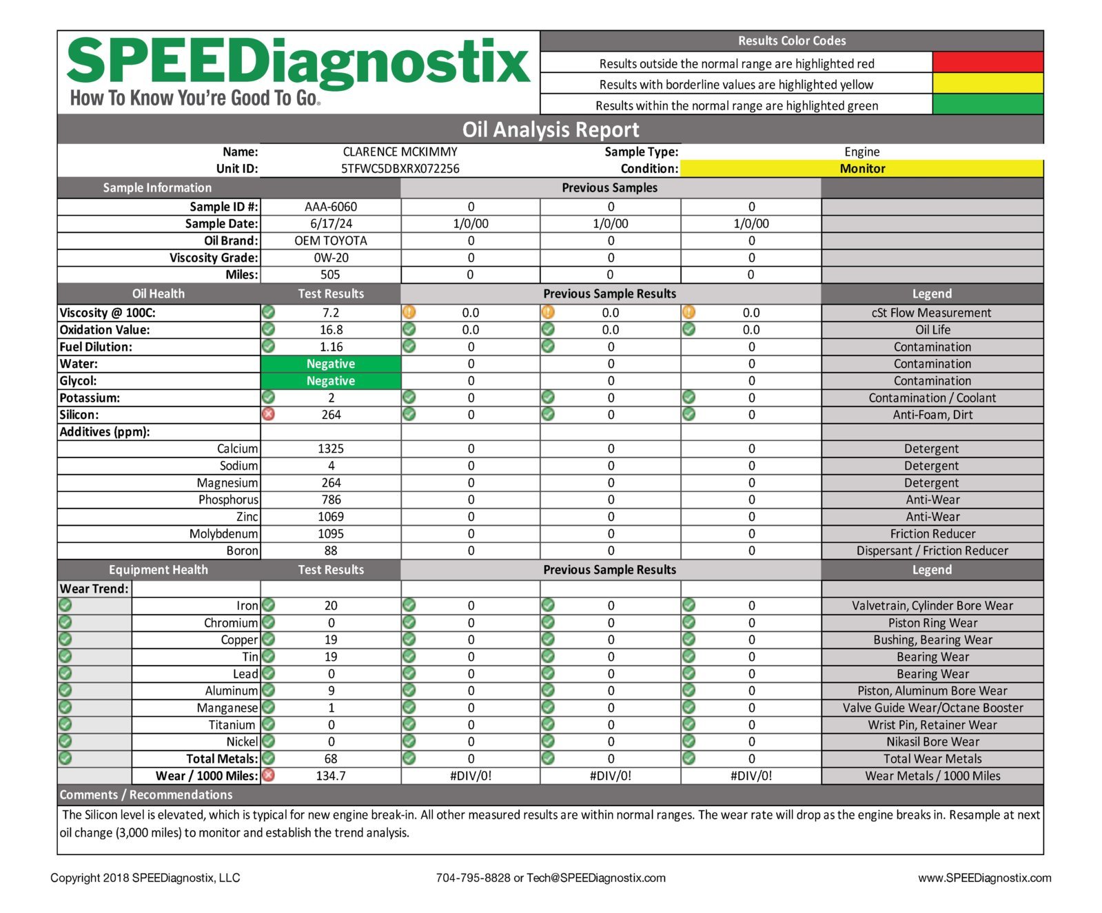

    I received this email yesterday from one of the oil testing labs -

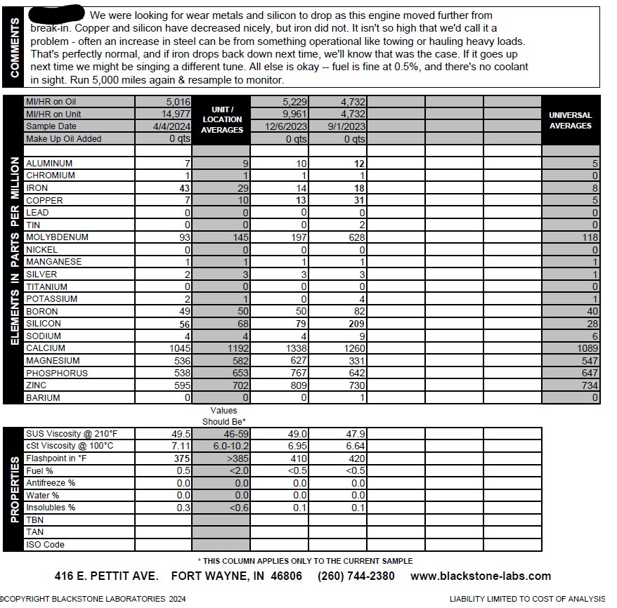

    Im pretty sure most motor oils have very low ZDDP nowadays because it doesnt play nicely with cats.

    Maybe that’s why only a small percentage are failing… corrosion induced failure would make some sense with the avg mileage on these units when they fail being close to 30k miles…

    Zinc in the samples from the analysis thread seems to run ~800 ppm.

    Also would align with failures occurring with less miles on the 2024 models when the factory oil analysis showed more zinc…

    The zinc is likely from the oil additives...i.e. ZDDP. The levels are very consistent for most of the samples.

    Seems like it’s gone from around 600-700 up to 800-1,000 from what I’ve seen.

    Different oils with slightly different additive levels. Also different mileage since change.

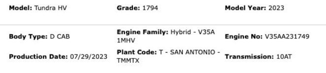

    Call the dealer and they can tell you the exact day. My door jamb sticker says "02/23" and I found today that my date of manufacture was actually 2/22/23. Just outside the recall window...at least for now.

    As above, sticker in door jam. Engine serial number can be obtained by dealer service running a TIS report.
