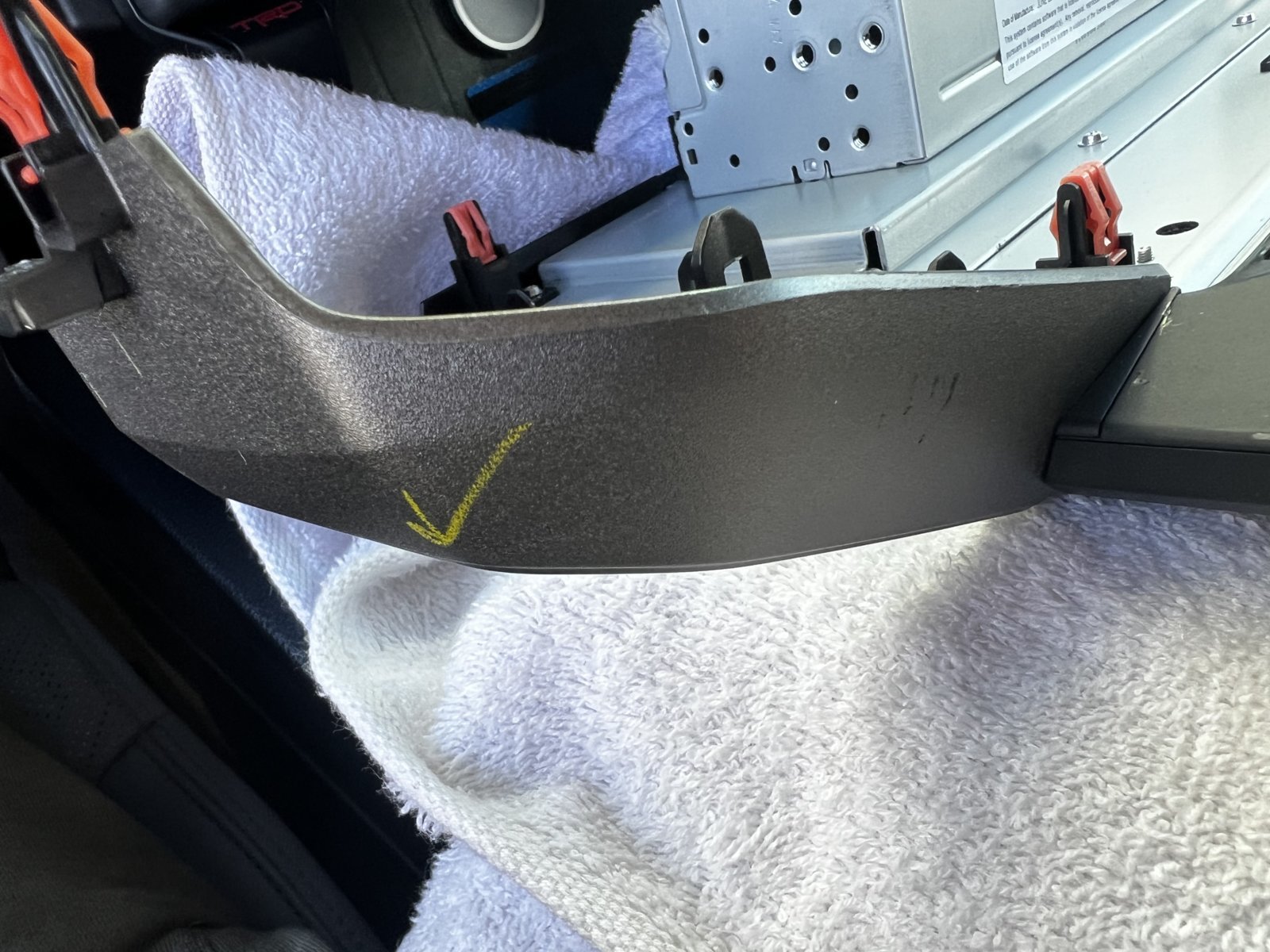

    The 401 being listed as 21-23 is definitely a typo. The unit I did get was labeled brand new and was sent in a sealed package. But there is a small yellow line drawn into the bezel. So I’m guessing this guy gets these units directly from Toyota but the ones that don’t pass qc.

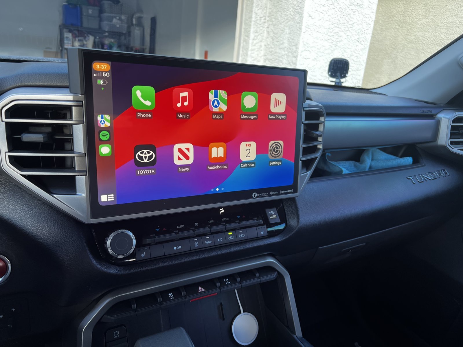

    Vents trimmed and knob installed as well

    Hi terraj66….do you mind telling what you trimmed the vent down with? I’ve stared at them and can’t quite decide.

    I used a dremel and cut down to the little hole and sanded with my angle grinder the rest of the way going little by little. Pretty fool proof. Now the hole for the volume knob was scary
